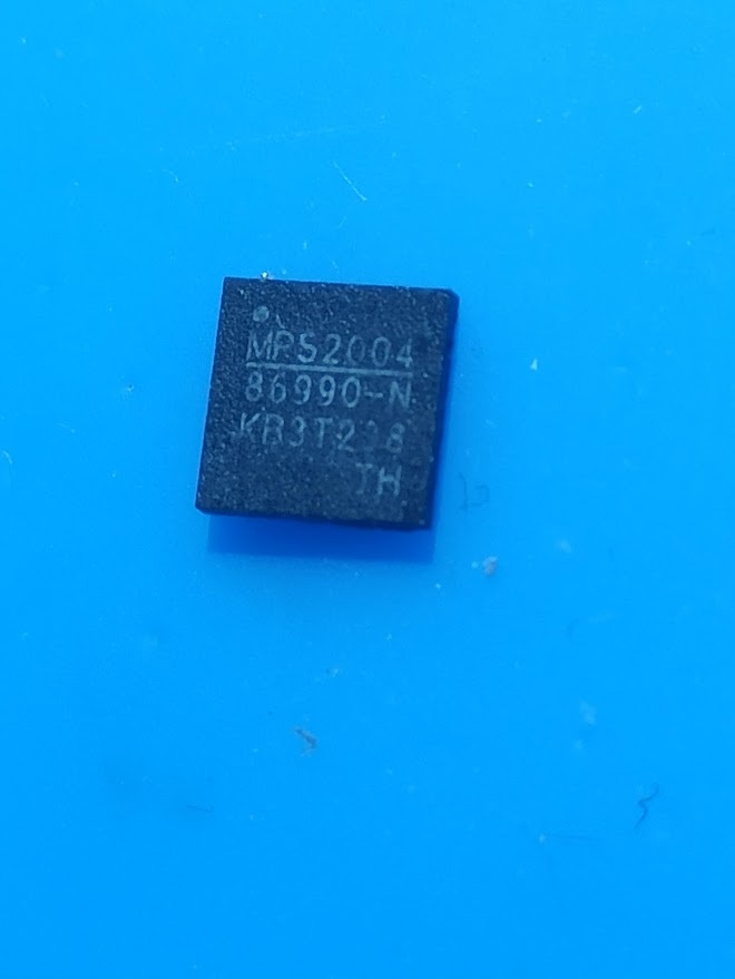

    Hello.
    I need to identify ic from this rx5700 saphire. it is from power stage of GPU main power. i cannot find what it is and who on ali selling it

    On these cards I usually see IR35217M for VCORE.
    Maybe Sapphire found a cheaper replacement for it.
    I guess what you can do is compare the pinout.

        I would take mosfet from VDDCI and replaceit with NCP or SIC or IR
          allready ordered from ali
          15e/piece
