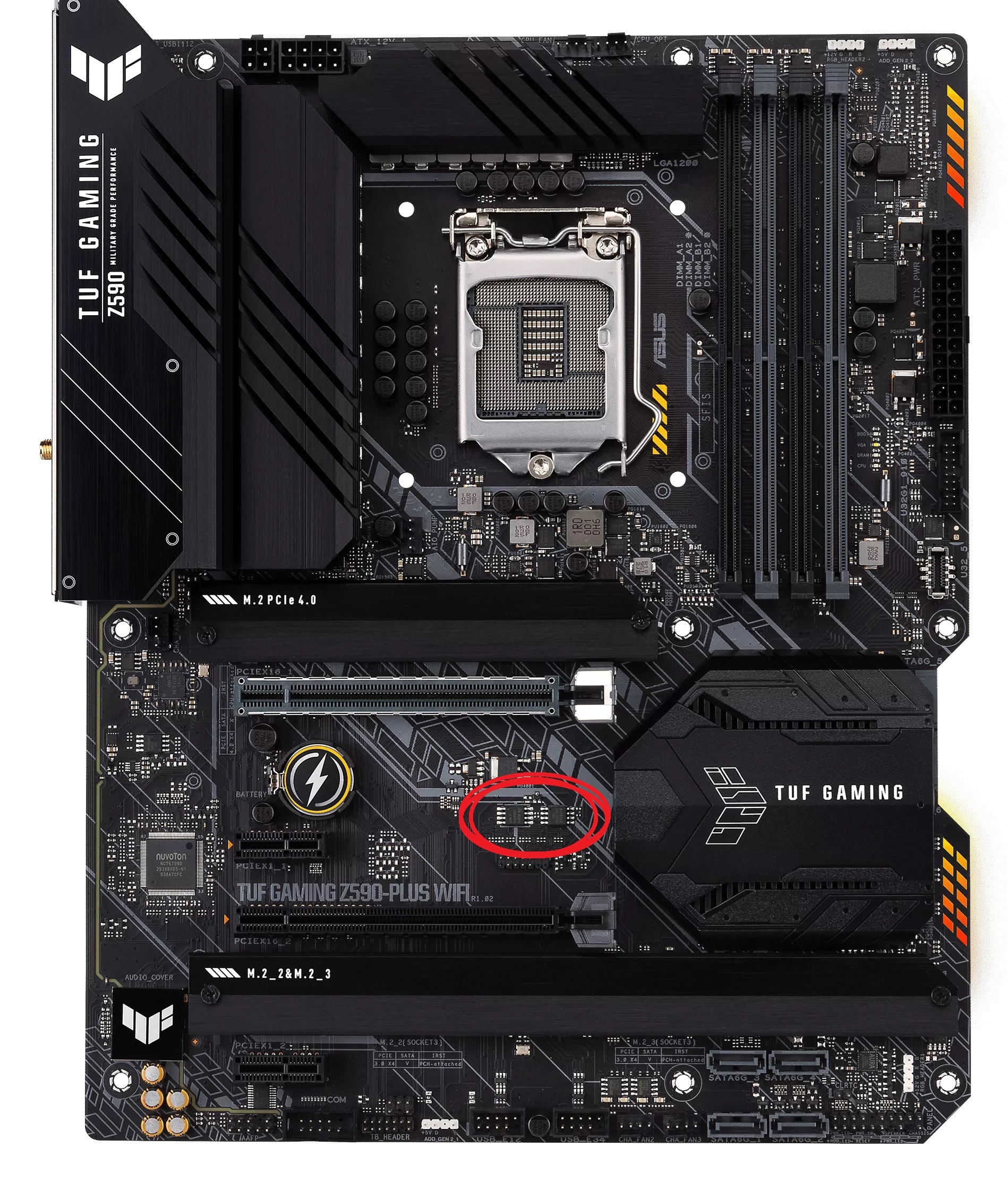

    Recently got a parts motherboard of the above make and model. The board is missing both of the bios chips but has no other (visible) issues. I'm having a pretty hard time figuring out the specific model of the chip pair. While it is quite likely that the board is dead regardless (why would you de-solder both bios chips on a good board?), taking this as an exercise I would still like to try getting the bios chip part sorted. It is obvious that the chips are from GigaDevice, but I'm quite lost after that. Attached is the information I'm currently working with. Are there upcoming issues or other notable things I should be mindful of if/when I get the right chips? Should I be expecting to do more than get the chips, program the proper bios on them and solder them back? Any help highly appreciated, thanks in advance.

      Can you take a photo of your board showing the position of the chip? you might need to dump the program from a known working board and flash it to the new chip.

        Thank you for the reply, but I'm in the desperate need for the chip model(s) and expect to be good after that, i.e. getting the bios is atm a minor issue in my eyes. Click image for larger version  Name:	X.jpg Views:	4 Size:	1.29 MB ID:	3163110

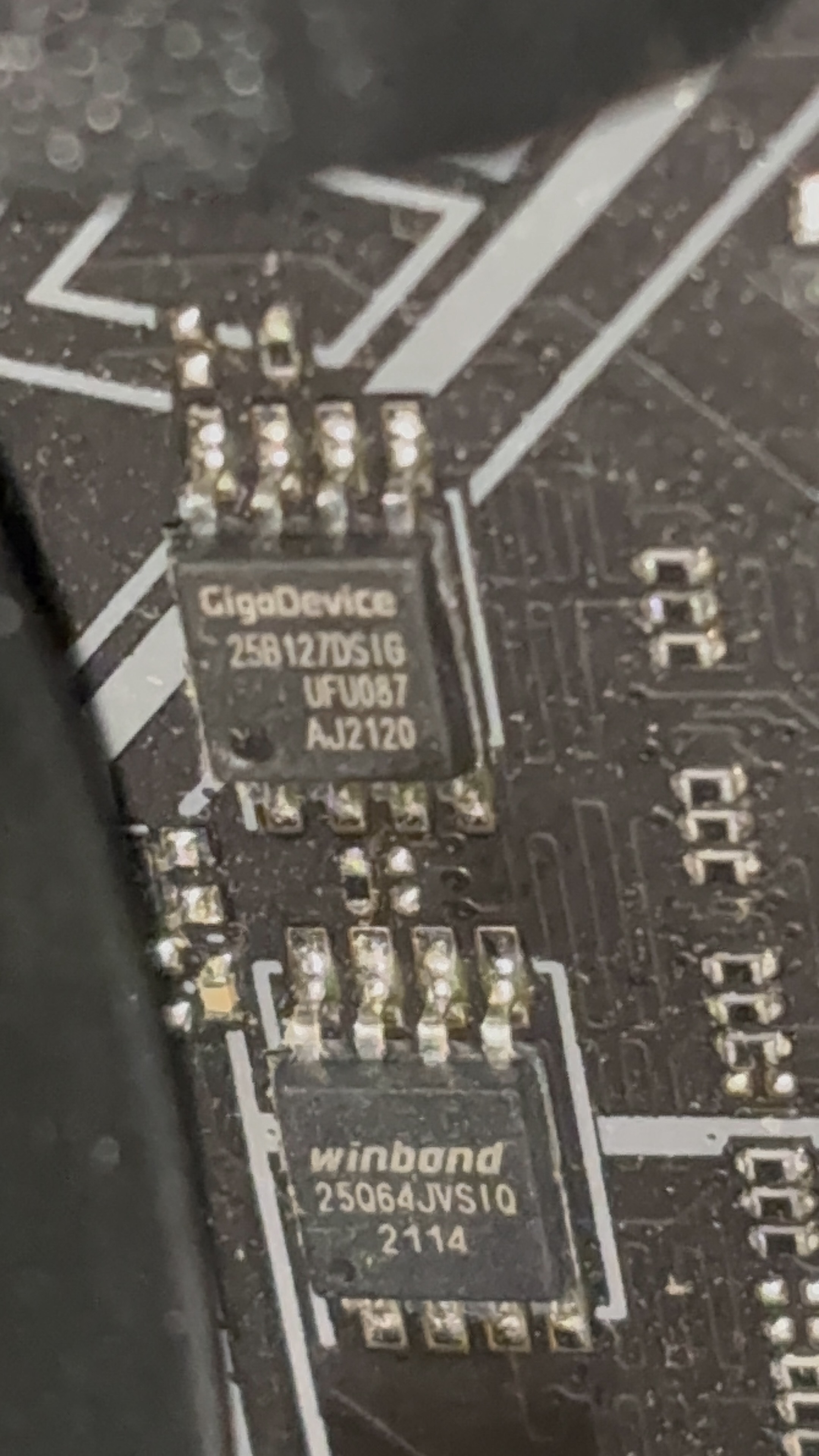

            • mladen4o
              • Dec 2024
              • Bulgaria
              Originally posted by FalseUsername
              Thank you very much.
              Hi, sorry for the reply years later but the reply you got is very wrong, the chips mentioned make up a 38 megabyte image when this motherboard is a 24 megabyte. the chips are: left (closer to the PCIe x1 slot) - WinBond 25Q64JVSIQ; right (closer to the PCH) - GigaDevice 25B127DSIG
