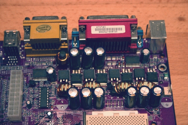

    Hi there,
    attached a shot of an ECS K7VTA3/KT333. Five of the nine Taiwan Ostor Corporation (OST) 3300uF RLX Series 10x25mm caps bulge, the other four don't.
    Two of the 1000uF RLS Series OST caps elsewhere on the board also do not really well and look like having stuffed cheeks...
    As the 3300uF caps are densely packed I have difficulty to find a place selling respective replacement types. If anybody had tips for where to look in Europe, please let me know.
    Thanks and have a good day,
    SuchANiceGuy

    Re: ECS K7VTA3/KT333 with bad OST Caps
    I can ship caps to Europe, shoot me a PM if you want. Thanks.
      Remember that it is wise to replace all caps of the same brand when only a few have failed; the others will fail also...
