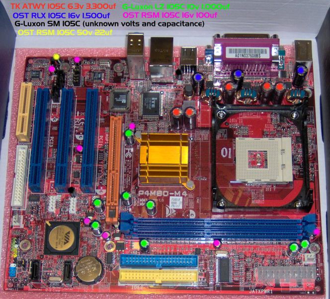

Legend:
Red: TK ATWY 105C 6.3v 3,300uf
Green: G-Luxon LZ 105C 10v 1,000uf
Blue: OSR RLX 105C 16v 1,500uf
Pink: OST RSM 105C 16v 100uf
Black: G-Luxon SM 105C (unknown volts and capacitance)
Yellow: OST RSM 50v 22uf
