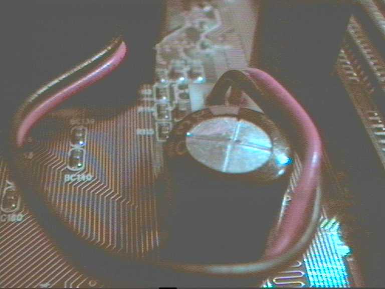

                      Bought really cheap non-working KT7 (non-RAID) - of course because of bad caps. Everything is Jackcon except the small 1000uF/10V Teapos. The bad ones are 1500uF/6.3V Jackcons - both the green and black ones.
                      Bad caps near AGP:
                      And also other bad caps - they're bulged only very slightly but they are:
                      (the one on the front is not bulged, the one on the back is).
                      The big and the smallest ones are OK:

                        Re: Abit KT7 recapped and perfectly working out of specs
                        yea, that's is just like my old board before recaped.. so how do you recap it?
                        back then, i replaced the jackons and got memory error. so i replaced the teapos and it's been 100% good till now (for ps1/2 emulation/epsxe)..
                        i don't need that noisy little fan (nothbridge fan) though, so i removed it. the heatsink is just a litlle bit warm.
                        make sure to download a latest bios..
