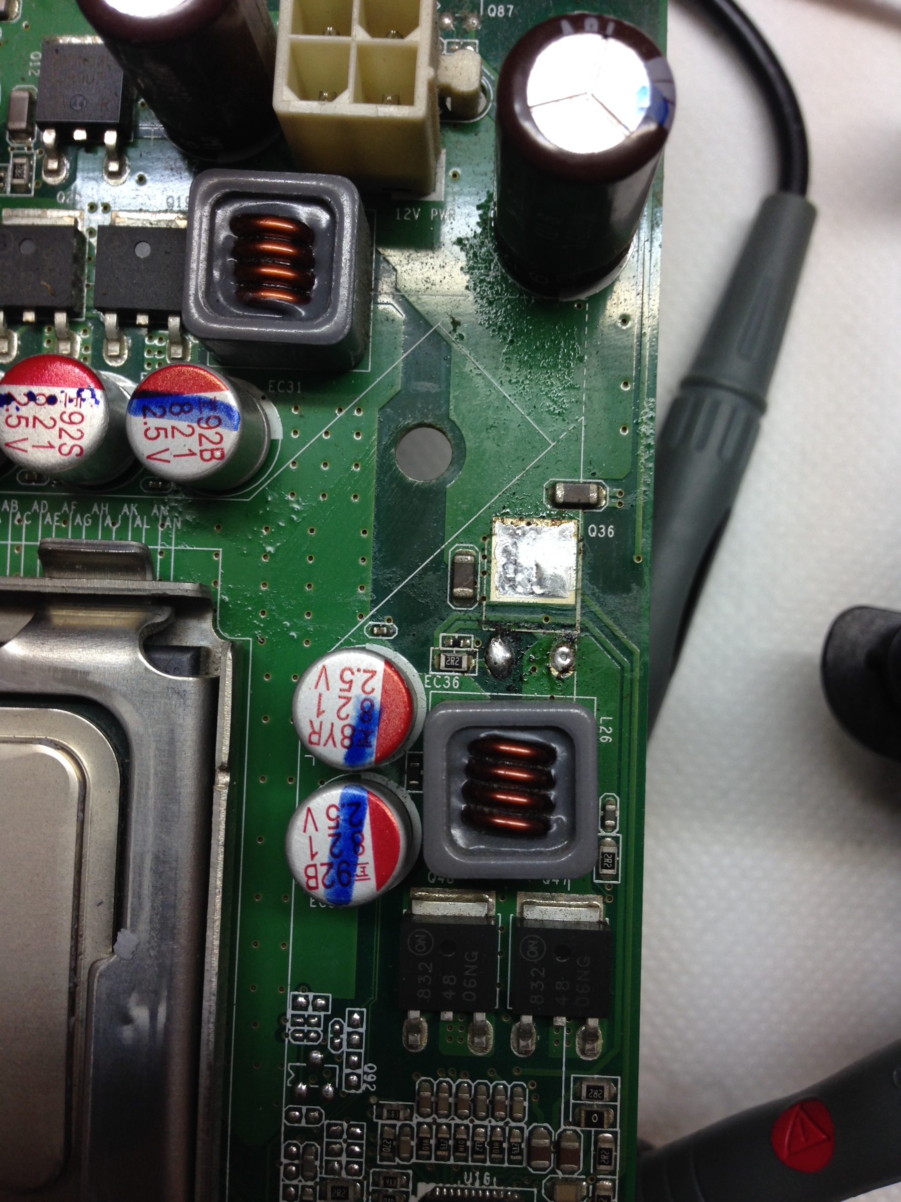

    Hi, i got this MB that wont start. When push power SW cooler fan spin for 1/2 sec and then stop. I try to unplug 4-pin +12V that go for processor, and i have cooler spin but MB wont start.

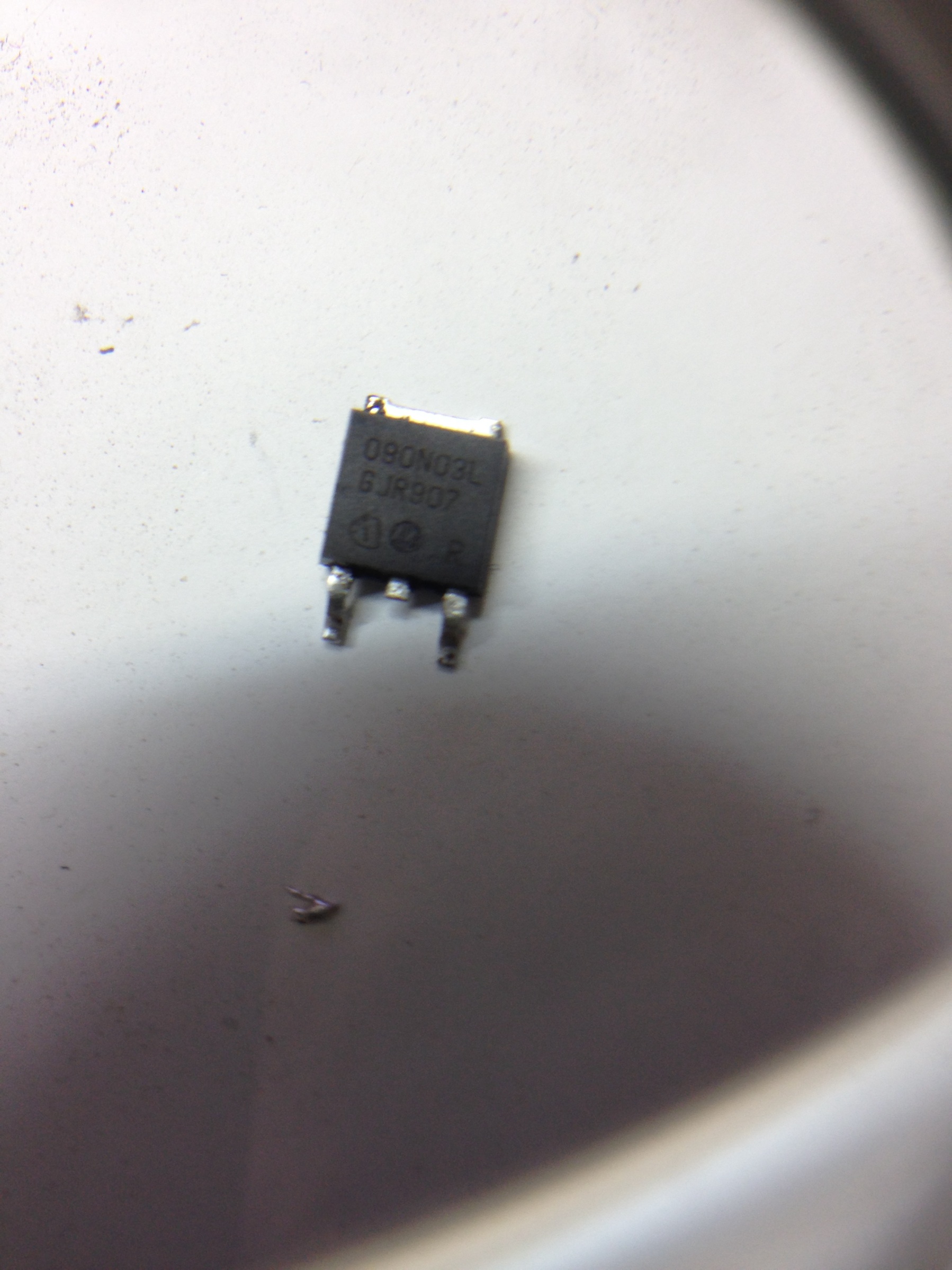

    I found that MOSFET 090N03L was shorted, i replace it and MB work fine.
    Here are some pictures, maybe it will help someone.

      Looks like you have Chemicon KZJ on that board. Could be going high ESR and making the VRM circuit work harder than needed. Chemicon KZJ and KZG are well known for going bad even without being abused.
