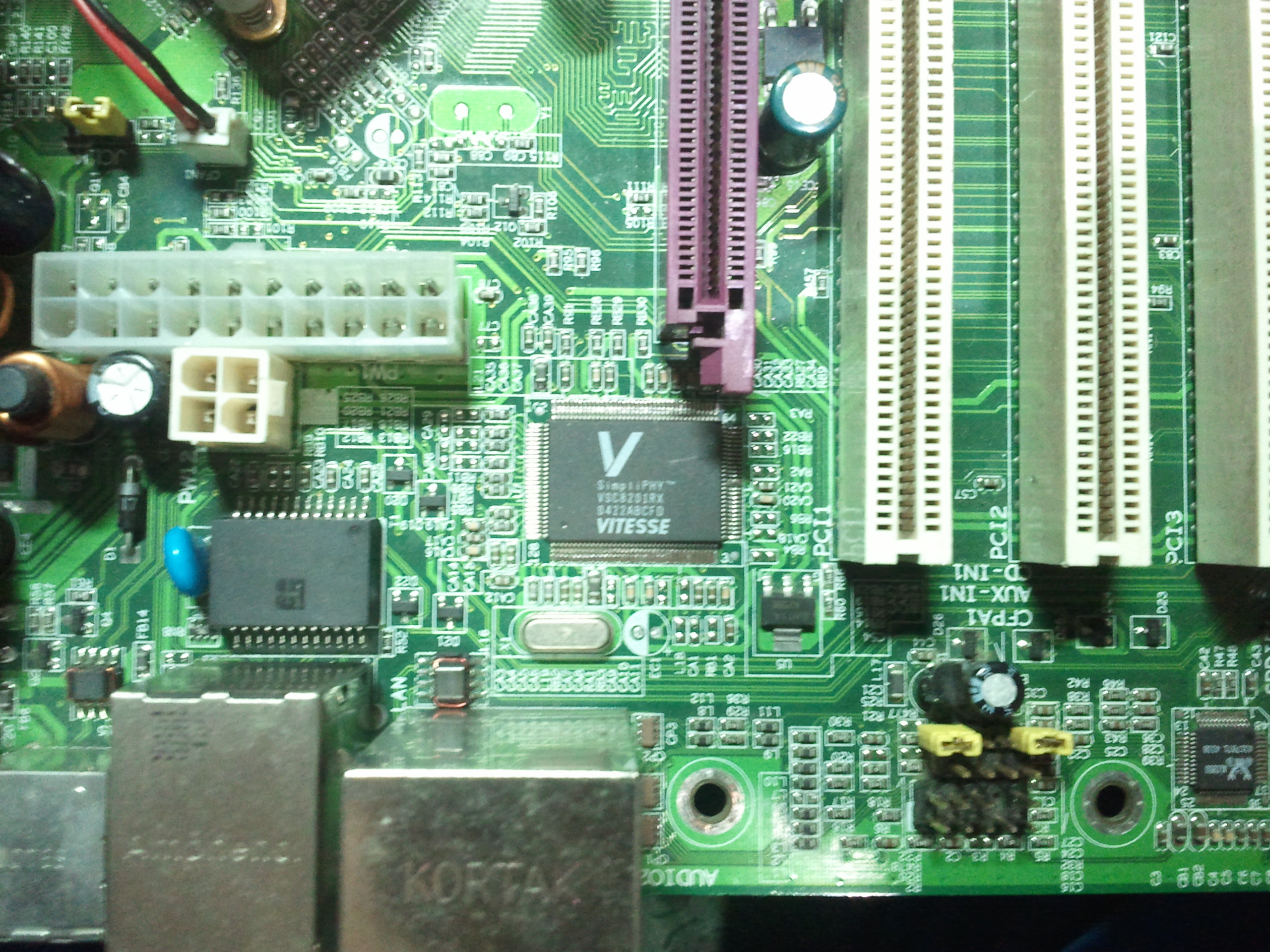

    Hello.
    Third post here XD (Ok, I'll stop counting :P)
    Ok, I have this Epox motherboard that I had given to a friend for let him use until he got a new laptop.
    But after he gave me back my motherboard, I tried it and I found that the integrated ethernet card don't work anymore. It seems that a lightning hit the phone cable (unluckily we have most of the last mile cable on poles ) and the ADSL router, broking only the power supply of this one, but my friend claims that at that time the computer wasn't plugged to the router, so in any case I can't know what was the cause of this problem.
    On the BIOS settings I still can decide (obviously) either to switch it on or off, and even set a mac address if I enable the feature, but if I, like, try the network boot the motherboards shows me a message that no device is plugged (naturally with the bios setting to "auto", the only choice available except "disable"). So to say, not only windows doesn't view anymore the integrated device but even the BIOS.
    I suspect that the problem can lay on the power line to the card (i.e. a fuse) since the leds are off, but I'm not so sure and it's just an idea.
    In any case, this is the situation and I want (and need) to fix it since I need it for helping another friend, and we don't have any spare pci ethernet card (nor we have any money to buy one, naturally).
    TIA again for any help provided

              Post a picture of the area near the ethernet port. Looks like that Cicada chip does the ethernet handling. Not sure though.

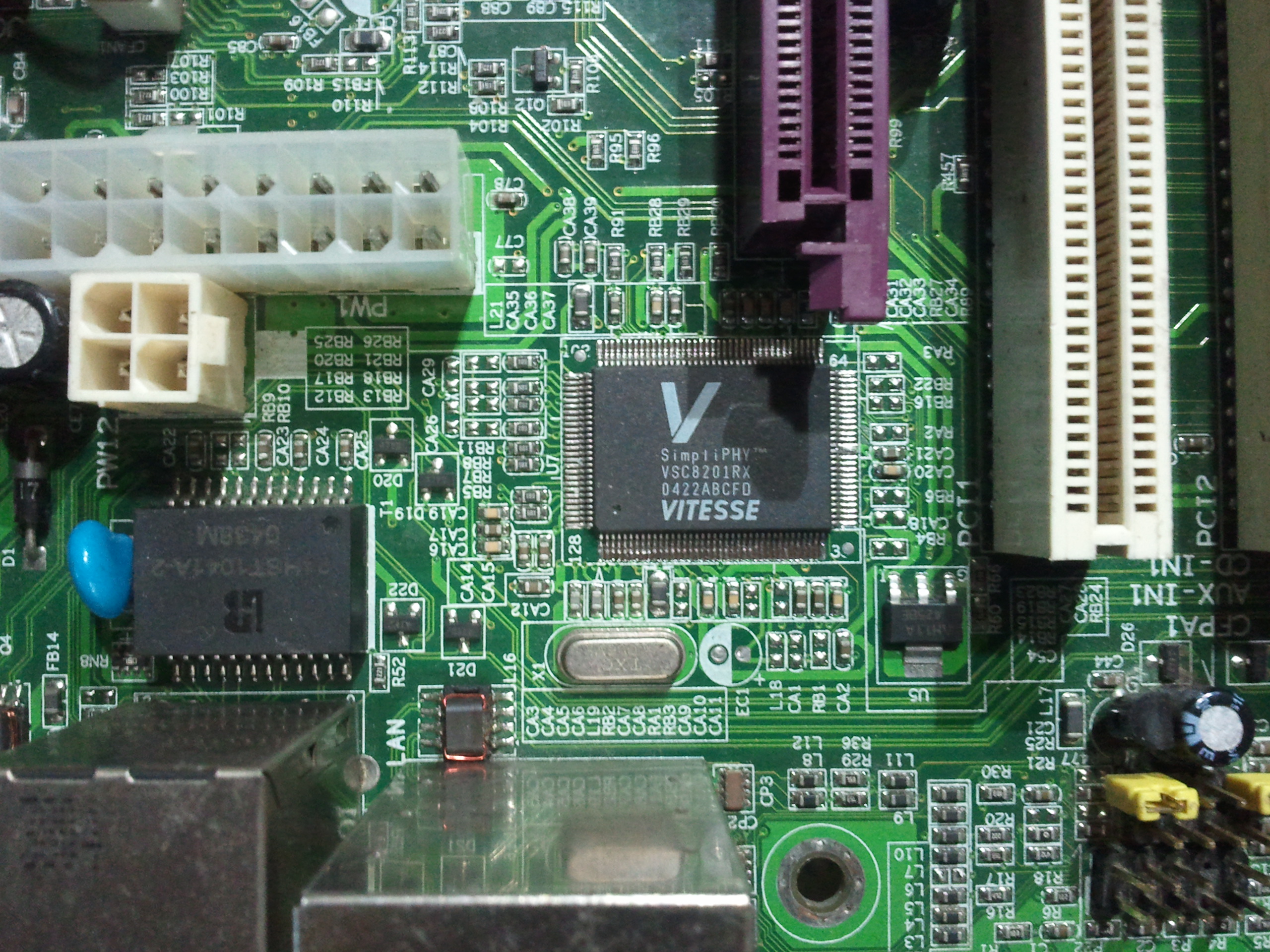

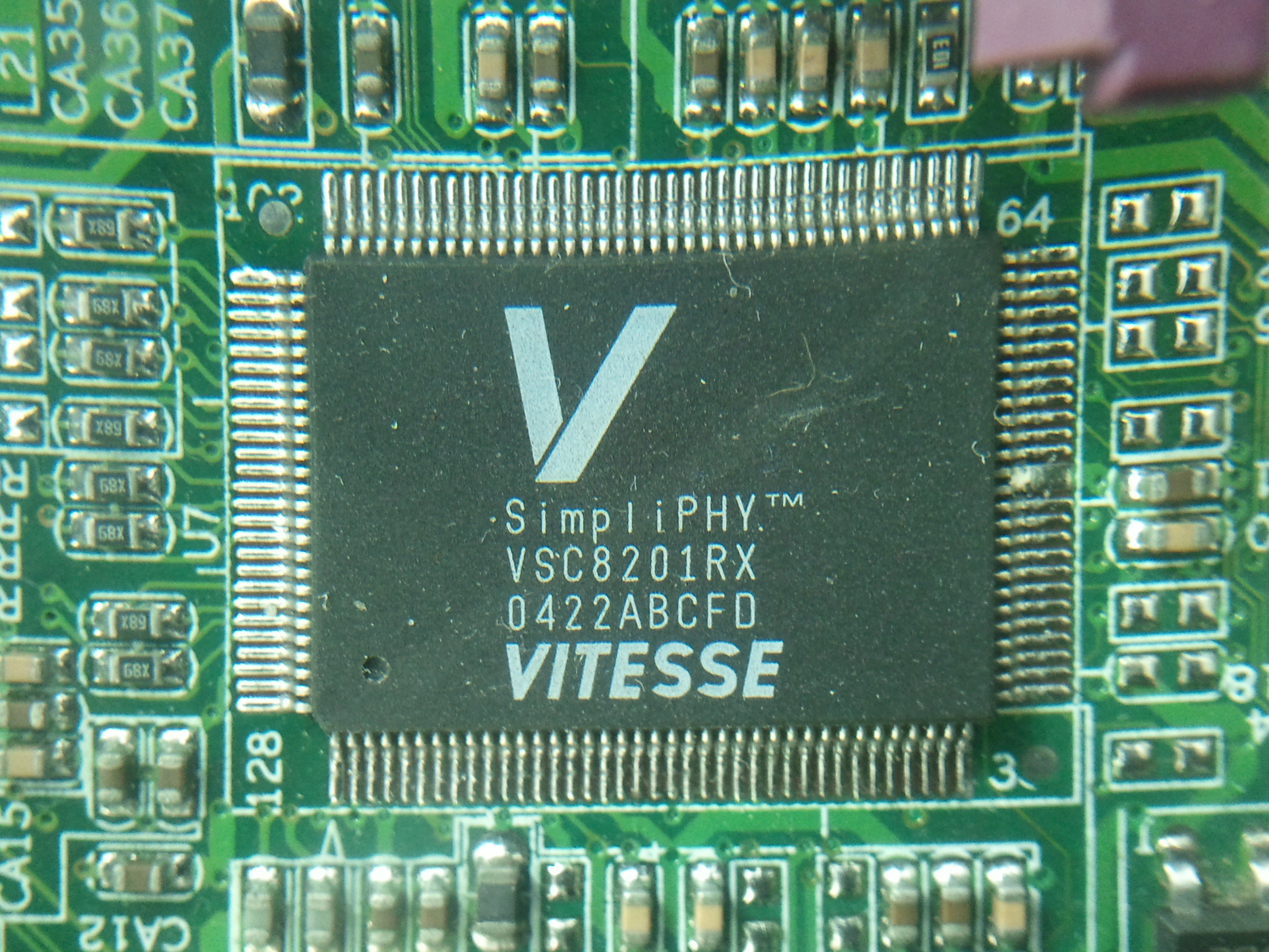

                Re: Epox 8rda6+ pro no more ethernet
                Yes it is that chip, even though mine is called Vitesse.
                Here are the pics I could take:
                  I guess the first step would be to check if all of the proper voltages are coming to this chip. To do that, you will need the VSC8201 data sheet.
                  They have it on their website, but you have to register. This is the link to all of the related files for this chip:
                  https://www.vitesse.com/products/pro...number=VSC8201
                  If you don't want to register, you can open the link/item labeled "VSC8201 / RTL8201BL Dual PCB Layout Applications Note", download the ZIP file, and open the "Dual_Layout_AN_11.pdf" file. Page 4 shows where some of the voltages go.
                  This chip uses:
                  1.5V for VDDPLL15 and VDDREC15
                  3.3V for VDDPLL33, VDDREC33, V+A33, and VCC_MAIN33
                  See if you get those voltages. U5 looks like either a 1.5V or 3.3V regulator. Check what voltage it is outputting and if it stable.
