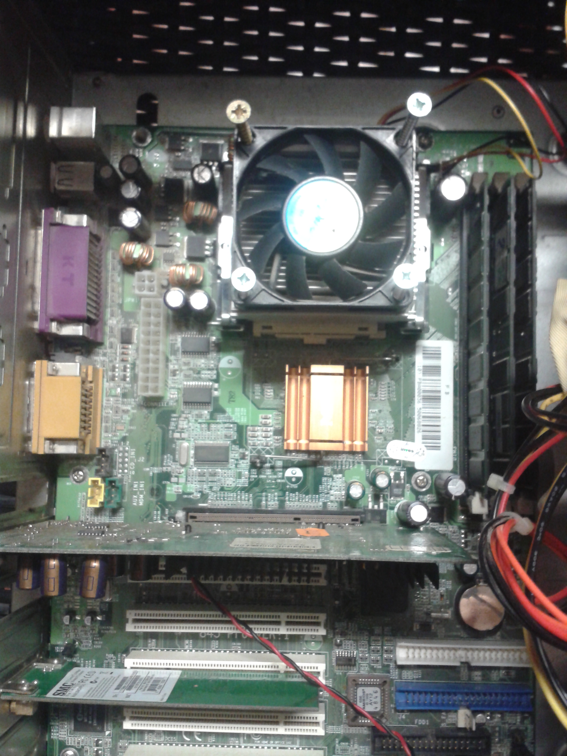

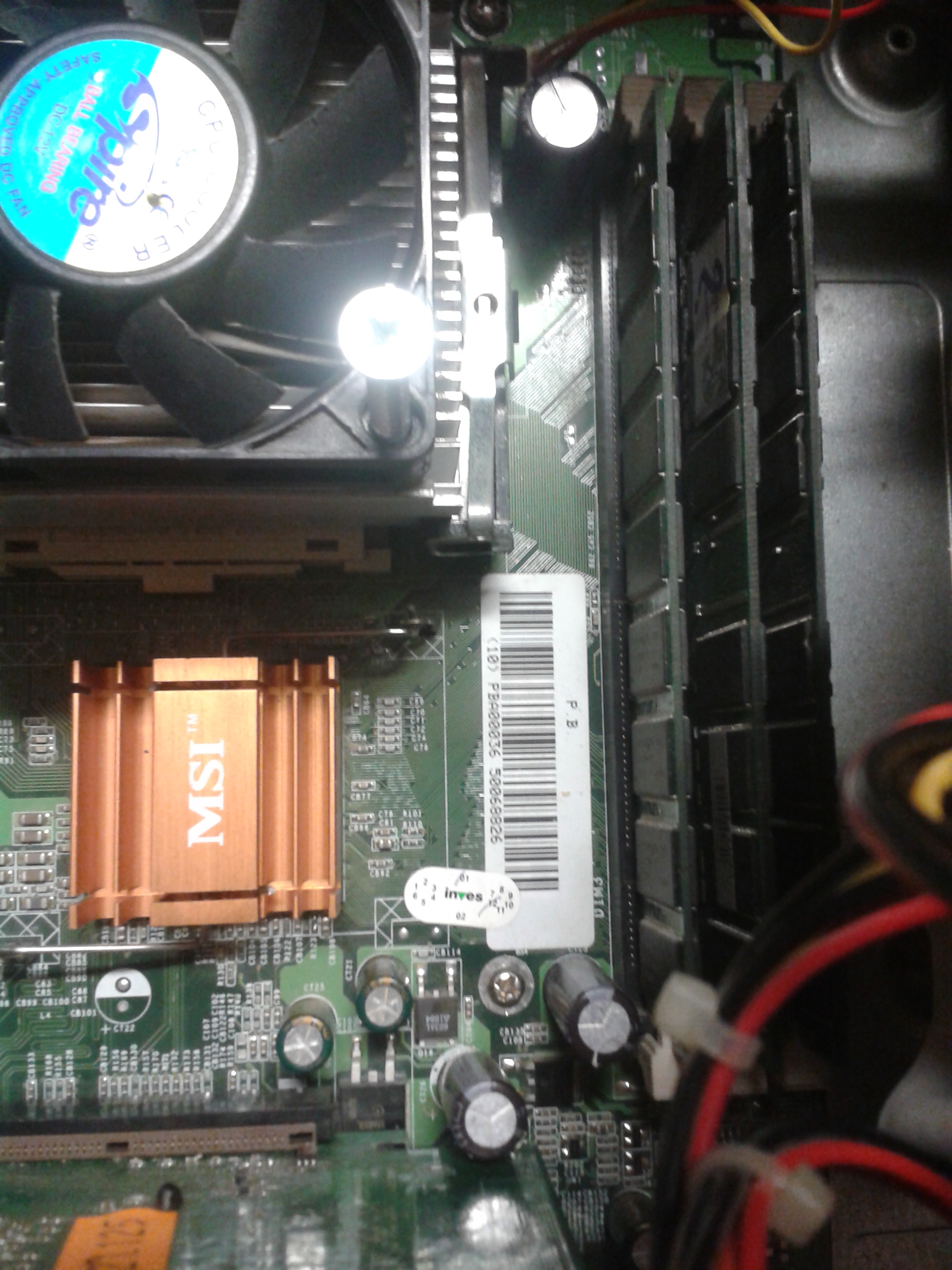

    Hos I bring a small story of a recap of an MSI 845 PRO (rare board), which is swelled a capacitor. Capacitor exploded: G·Luxon 1000μF 6.3v.
    the computer is backup, is working 24/7, mount it 30 days ago, and today I got to open the computer to have a look and I with found this surprise.

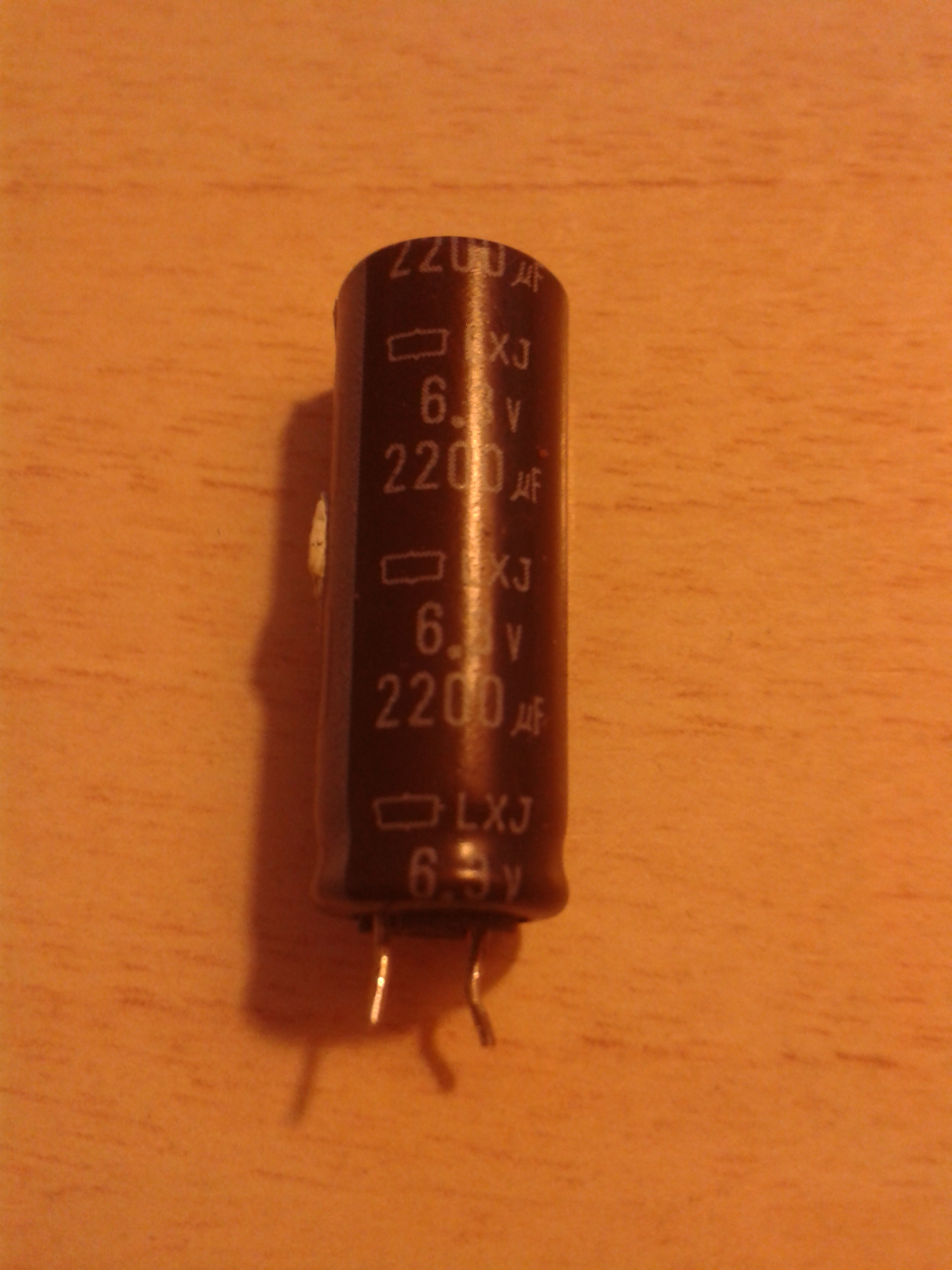

    New Capacitor, Chemi-con LXJ 2x 2200μF 6.3V, 1X Chemi-con LXJ 16V 2200μF. (had no others, but these serve.)
    The electrolytic capacitor for him came the rubber seal.
    capacitor location,
    I'm sorry, I have no photo of the plate condenser: (, camera battery had not at that time and needed the computer.
    Precaution also replaced two capacitors of 1500μF G·Luxon 6.3v.
    These are the capacitors that change.
    computer working again.

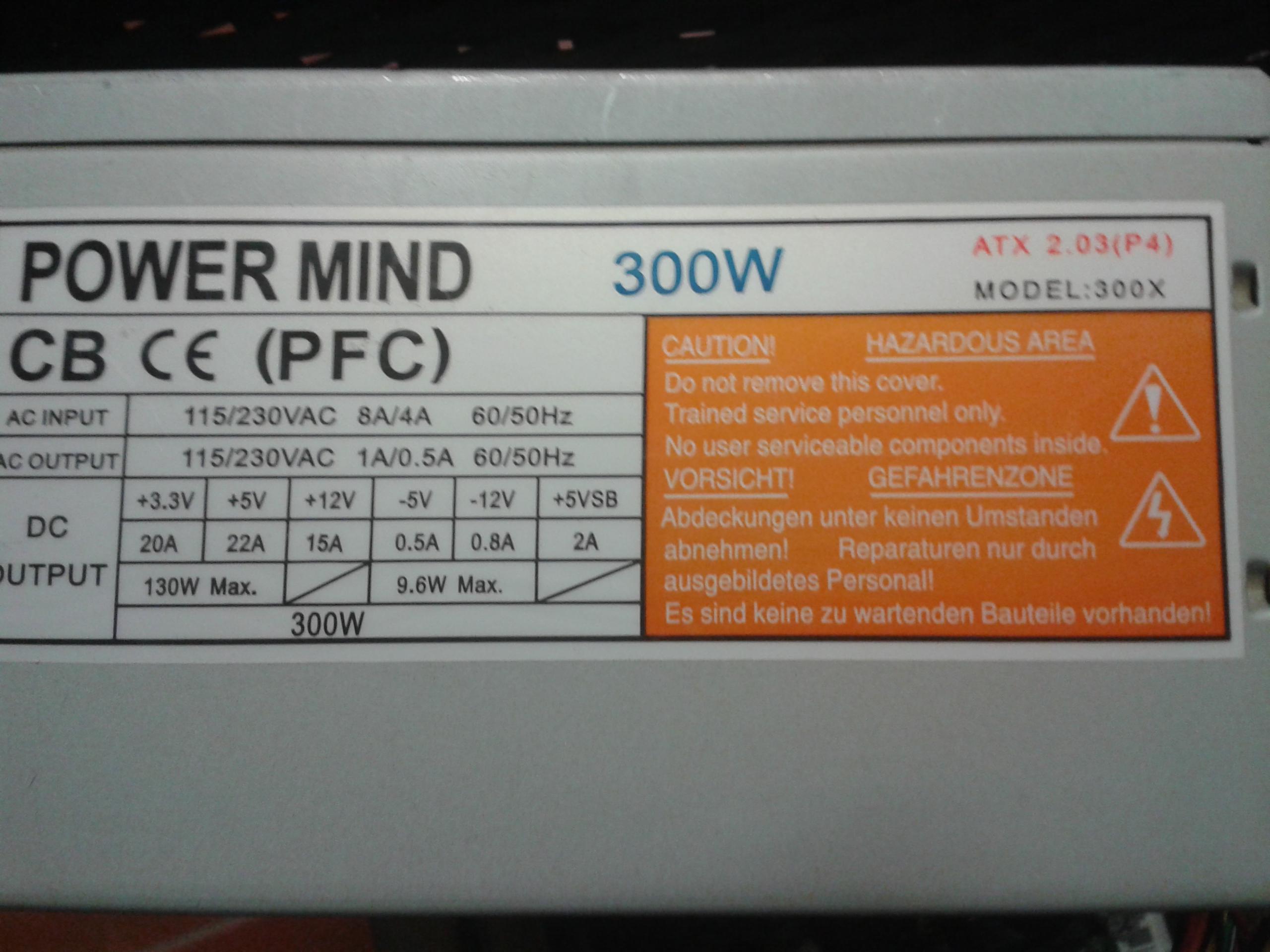

      Powermind 300w, In good condition, not the best, but it does its job right.
      I went crazy looking for these capacitors, here where I live do not sell Chemi-con capacitors only sell Lelon (they also fly)
      capacitors HP source delta electronics brand.
      the motherboard now works smoothly for 12 hours.
      I only use high quality components when repair themselves motherboards I can assure me and it will not fail for the same.

        Nice job on the motherboard fix! Never heard of Powermind, care to upload some internal pics or at least a label shot?
        • kevin!
          recapping PCB.
          • Jul 2013
          • 195
          • España
          Re: Recapping MSI 845 PRO

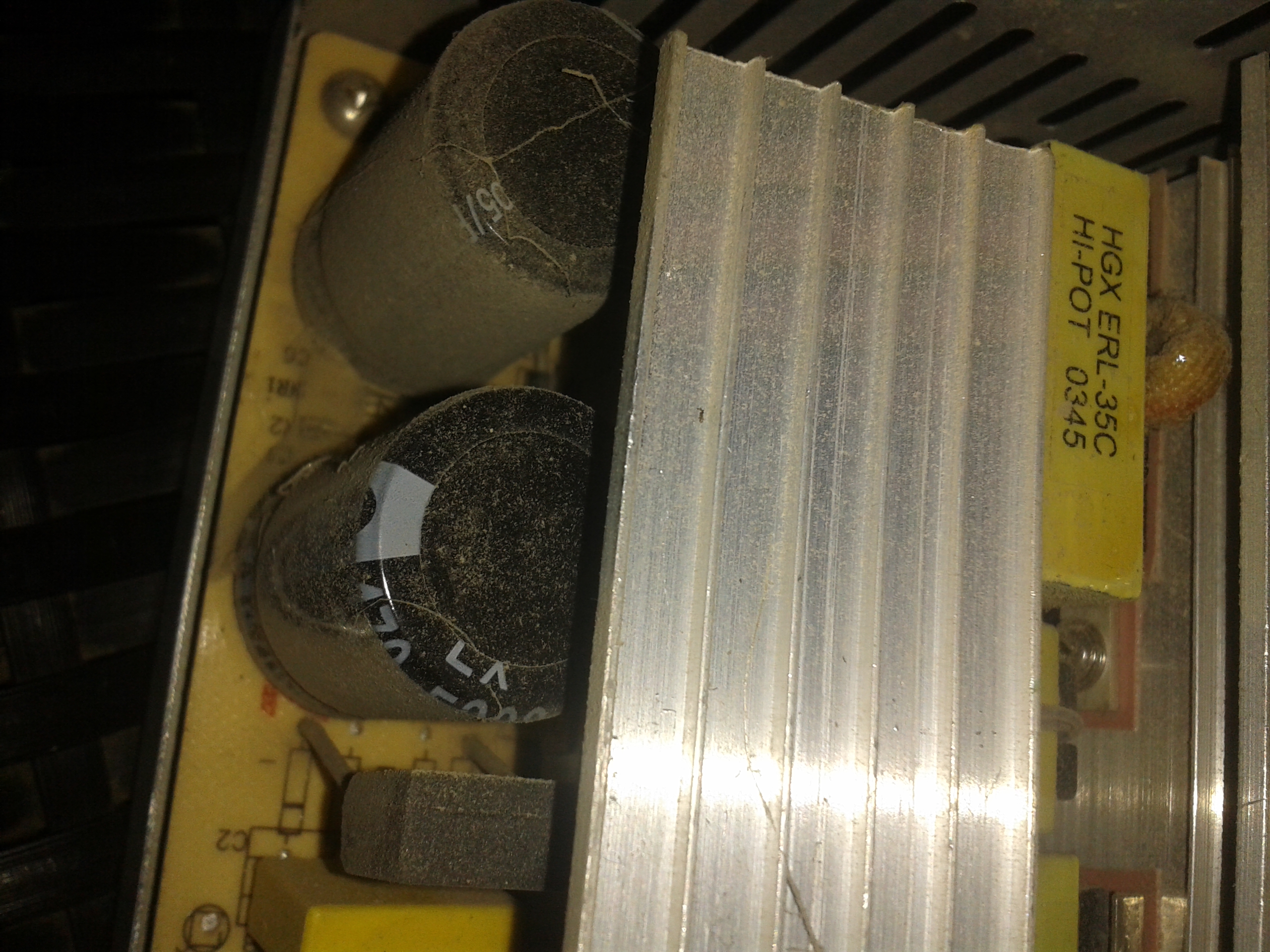

          Ok, The next repair, upload the photos you can, is when I started to disassemble the camera no battery.
          is a rare brand, I know, but it is giving me very good results, you have 3 HDD connected and a reader cd / dvd, no problems.
          1 photo:, Label power supply.

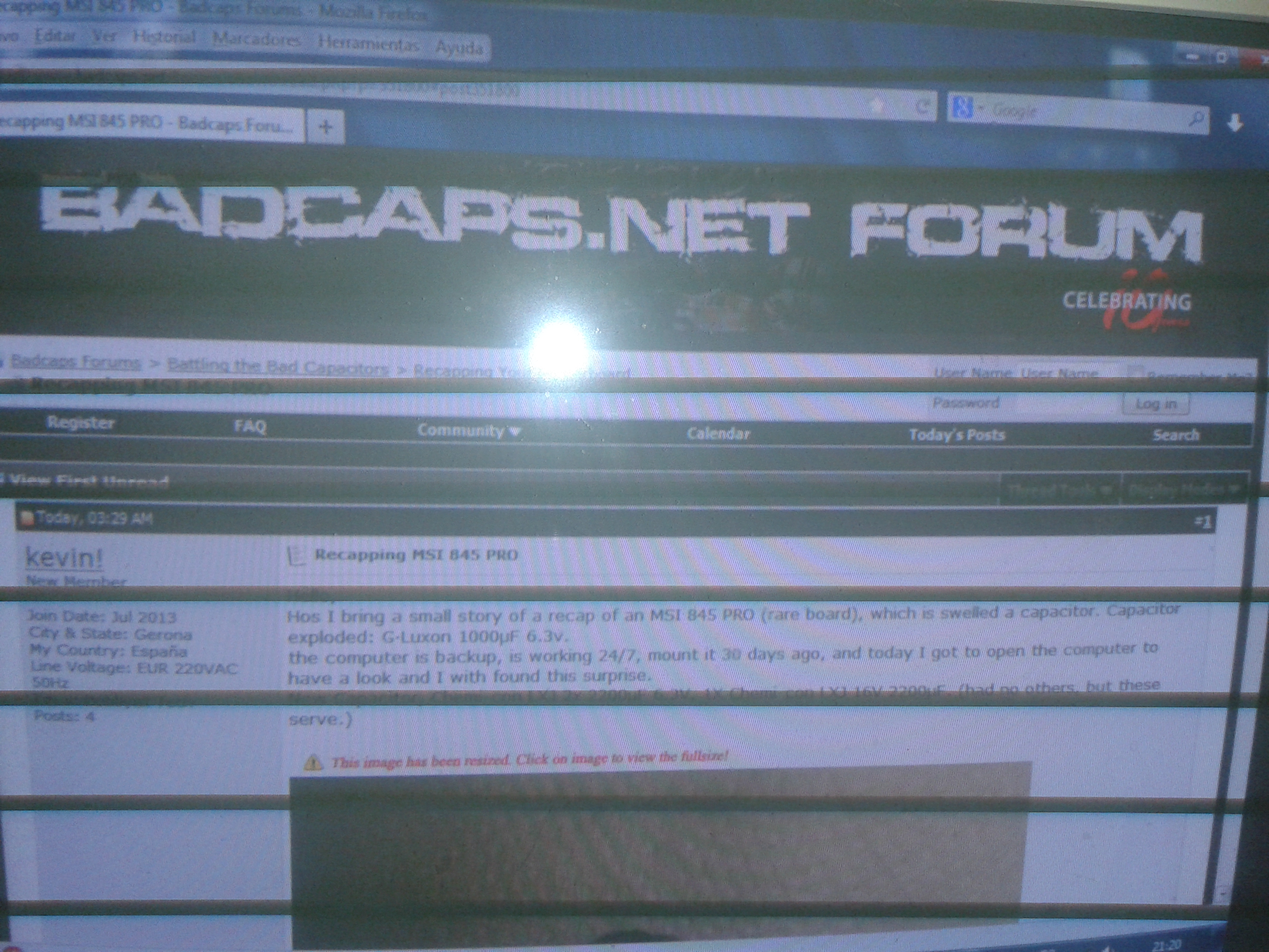

          2/3 Photo:, motherboard after 12 hour working after repair. capacitor good conditions. (screws seems a kludge but subject very well fan XD .)
          4/5 Photo: Capacitor Power Supply, HEC brand. good conditions.
          6 Photo: Computer working after 12 hour repair.

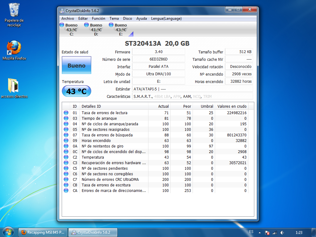

            As a curiosity, the computer you have installed an 20 GB hard disk 2001, which already has 33,000 hours (it was installed on another pc) motherboard stopped working before the hard drive itself XD.

              That looks like a Codegen. No wonder the motherboard caps bulged, I bet you it's getting lots of ripple. Those look like HEC caps on the secondary which are very low quality. Lots of hours on that hard drive! Back up your data

                Currently no I have more capacitors for replacement, when I have you I will make a recapping.
                Also this source was installed on another computer and never gave me problems, I think it has been for the capacitor that was of poor quality (I've seen many G · luxon swollen) The electric phase step of the cpu are all Rubycon and none to inflation.
                I do not think you need it, go quite well also your smart brand that's fine.
                Search errors and several happen to all seagates, is normal.
                I consider this hard drive unbreakable, currently takes 1 half years on without rest, only stopping to change computer. this hard drive was given to me a while ago, when I had a 26.000h active use. before I had 33.000 hours comment actually has 32.882h (I do not remember well XD). Seagate U5 series in my opinion is the best I could do, other than this 20 GB, a 40 GB (which is installed Windows 7) suffered a blow when he retired, is working without problems and also belongs to the U5 series.

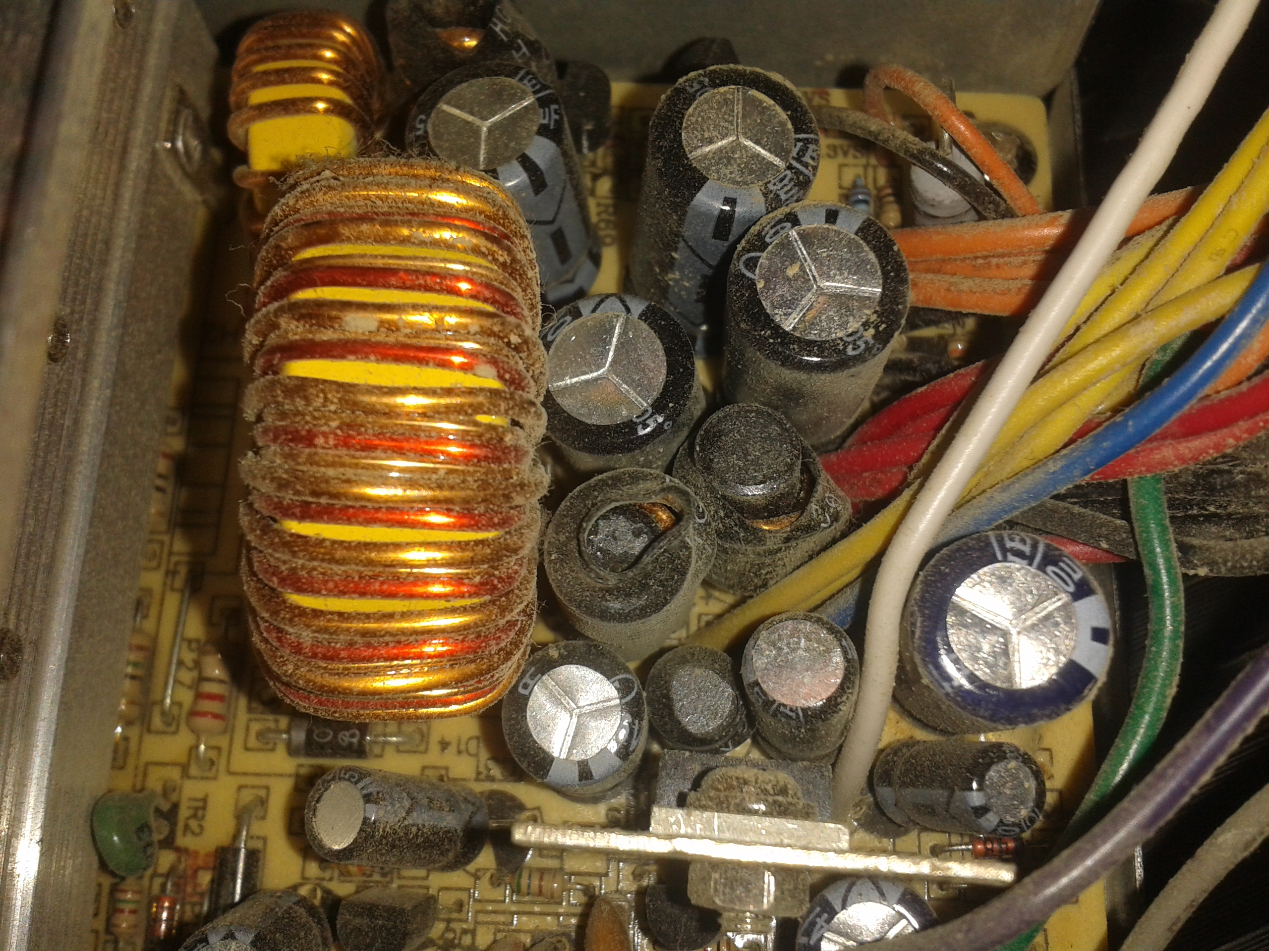

                                  After seeing this picture I'm changing capacitors without thinking twice ...
                                  The owner of this picture is trodas, forums aoaforums, the same source has commented that takes capacitor HEC, I'm really scared shitless: S.
                                  Brand PSU burned, Eurocase.
                                  I will leave standing the computer until you make a recapping.
                                    PSU replaced temporarily by a 400w TooQ the TooQ has fcon caps, but this source has more than 30.000h of use, and a computer provinod a super market and still works well, does not have any swollen capacitor.
                                      Fcon capacitors with 30,000+ hours of use? Wow LOL
                                      P.S. Good PSU brands are Delta, Liteon, Newton, FSP, Seasonic, and PC Power & Cooling - just to name a few.
                                        had a delta remove the capacitors to donate to the MSI motherboard, since the source was and in the last, turned off the computer for no reason.
                                        Currently now I can not afford new sources themselves that will follow if: (.
                                        On the Tooq, the hard disk that tower marked 50.000 O.O, the source is the change because he was hung, but then discovered that he had a bad cap from motherboard, (now it have a family the tower) and it seems that they changed the source by TooQ, and more or less'm a 30.000h until retirement.
                                        Yes they are badcaps must be working at less than their face value and so endure. that's my theory.
                                        (sorry bad english . )
