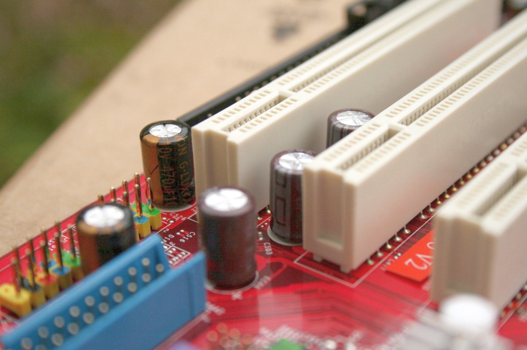

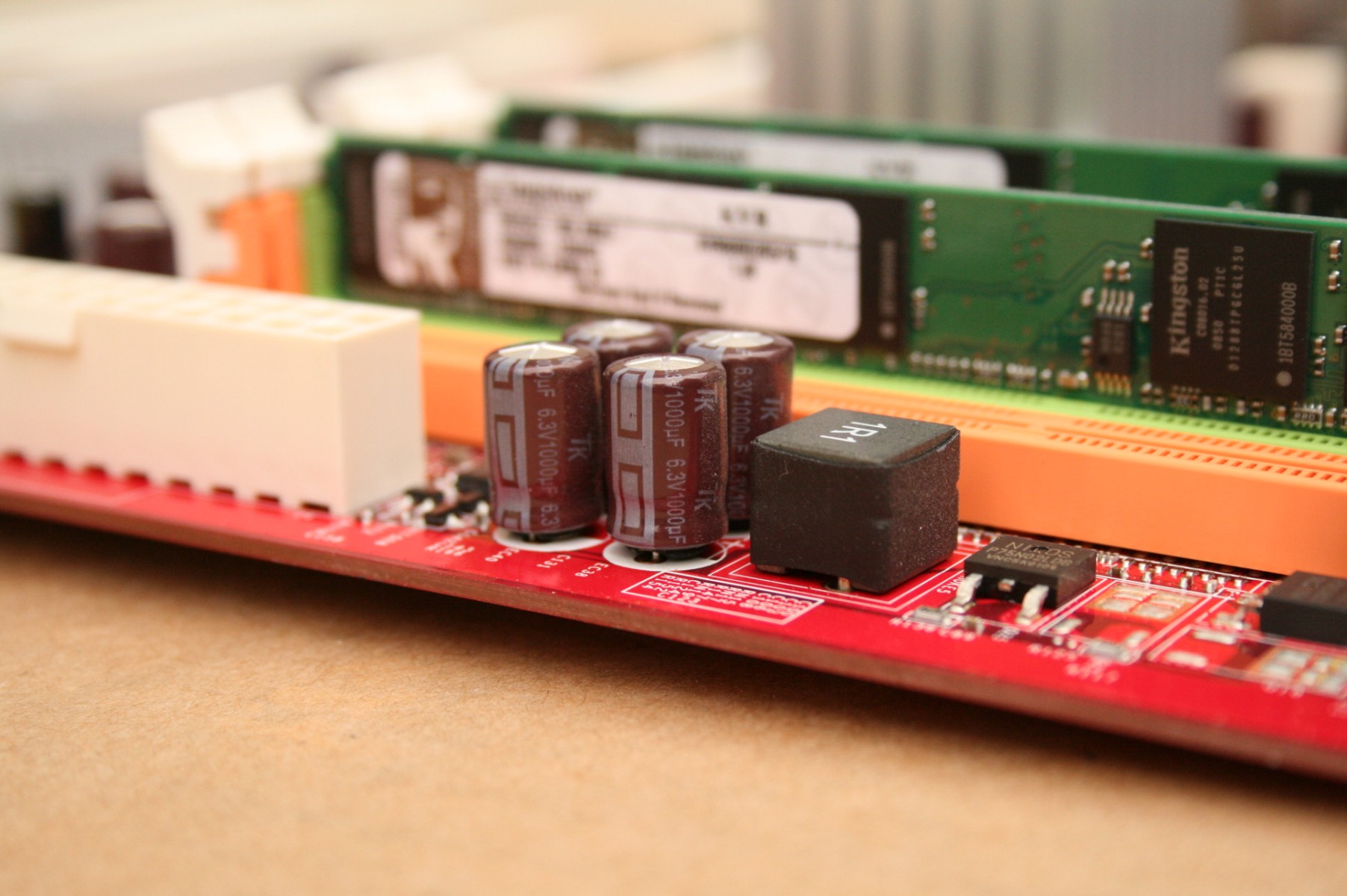

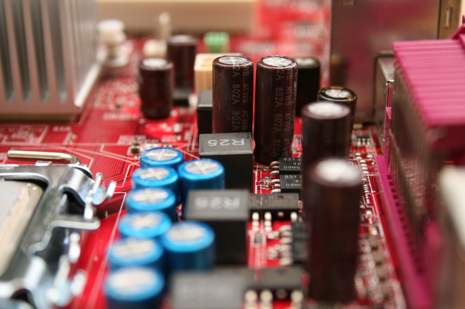

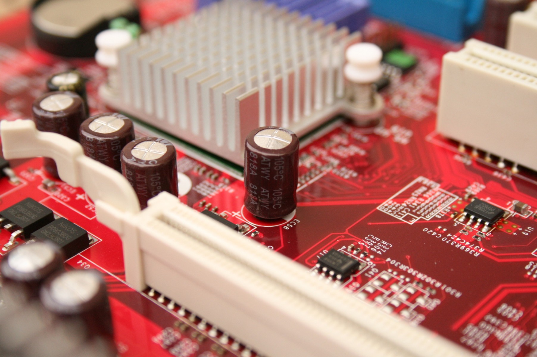

    Hello All,
    I got a four year old P31 Neo V2 equipped with TK, Ost, G-Luxon and one Teapo. By now 16 out of 19 of the small TK ATWY 1000uF 6,3V TK caps have bulged.
    The problem is, I cant manage to find any datasheet mentioning these. This one is all I found. But, the caps MSI used here are 8mm in diameter and I would guess 11,5mm high. What would you suggest to use as replacement?

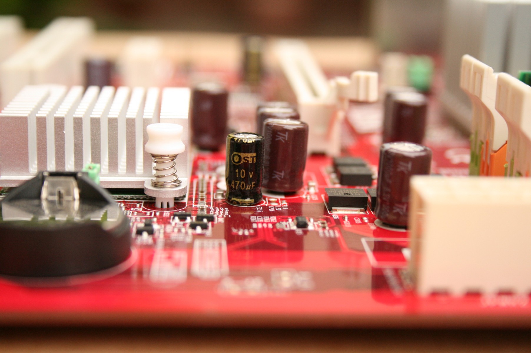

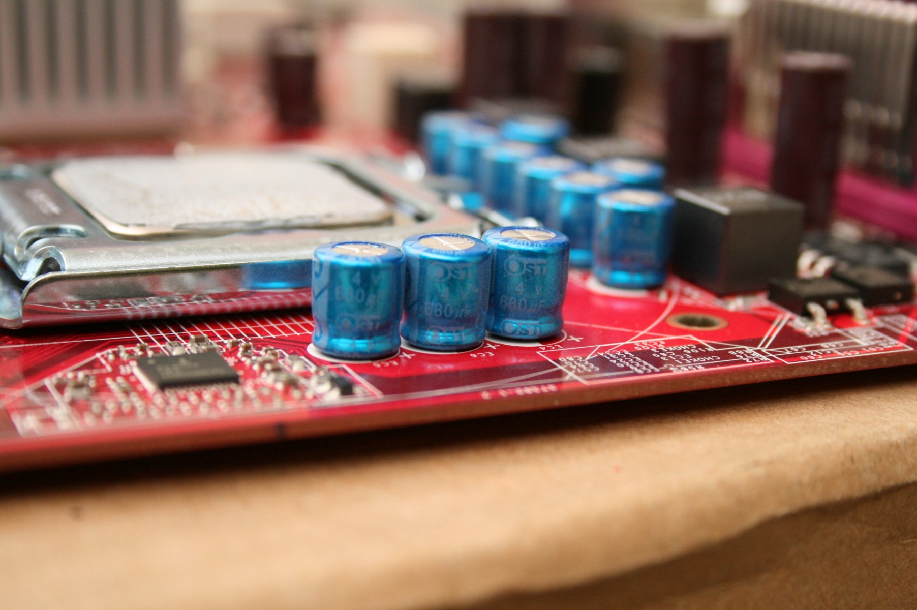

    I guess it would be wise to change the other TKs aswell. They are in primary CPU VRM and primary aswell for RAM, I think. What would you do with the shiny cyan Ost near the CPU and the 8mm G-Luxons for USB 5V?
    I wonder if it will be worth it, probably not if I had to change just every singe cap on that board. The PC is on light, only private use and decently cooled. So these TKs really could not stand anything. Who knows they would have gone awry if stored in a warehouse, aswell.

          Use capacitors rated for 10v or 16v where you can, instead of 6.3v. Bigger can size, better specs.
          A few mOhms extra won't make much difference and i do believe those were somewhat optimistic values listed in TKs datasheets.

            I would advise changing those capacitors CPU VRM (those blue OST), for a solid. are bad, I had a MSI 661FM3-V and is swelled several of these capacitors causing failure.
            A photo of a several swollen ...
