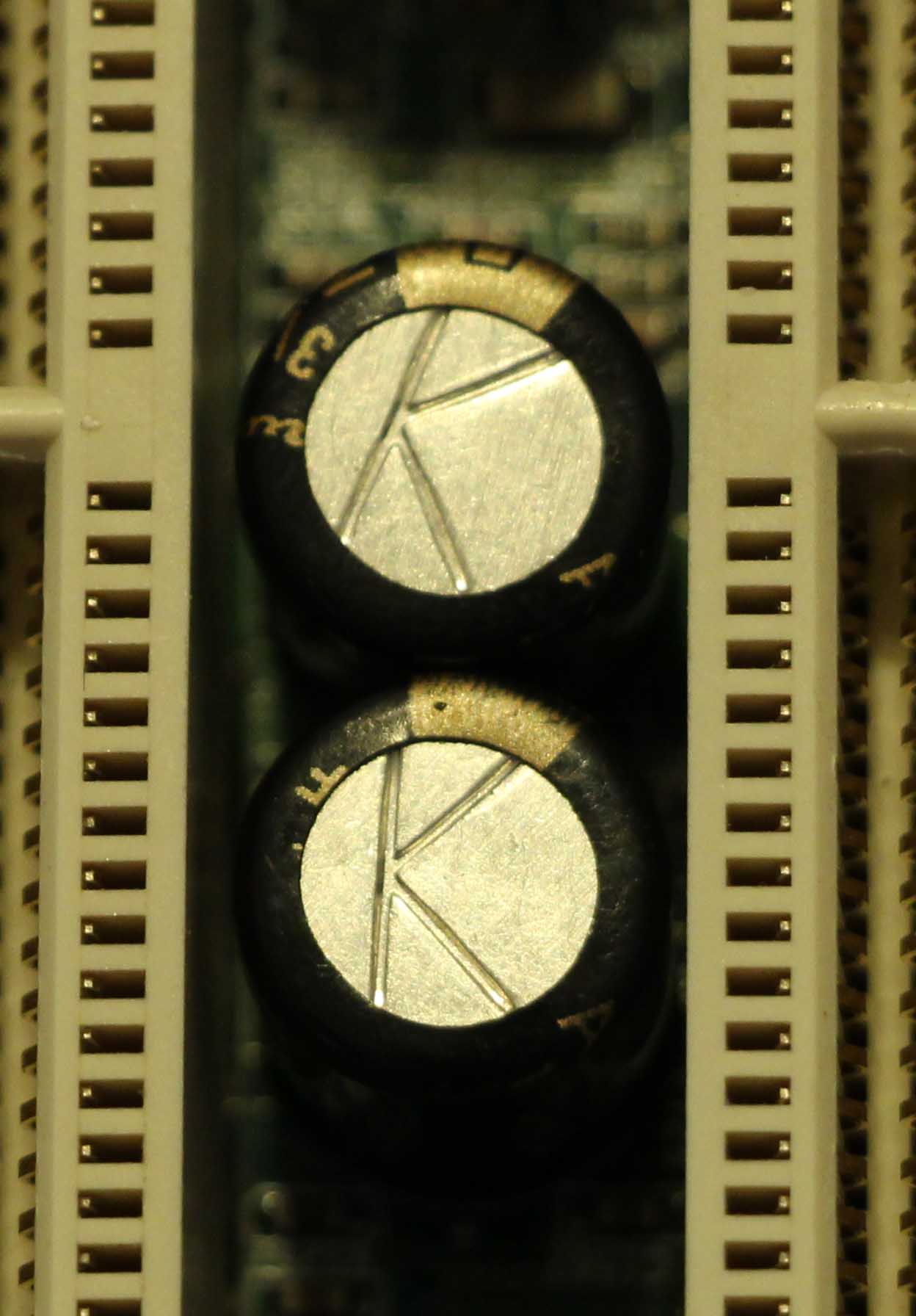

    I am new to this forum and hope that someone here can give me a little assistance with my project I am going to try myself. I also sent this to the website admin under the contact us page, but wasn't sure how busy the admin is and if he could get to my message so I am posting here as well.
    My brother-in-law has a sign business and he has high end workstations to run his sign programs. Aobut 2 years or so ago he bought 2 Hp xw9300 workstation cheap from a local computer shop that got them from a local college surplus. I don't buy HP or Dell products personally and I normally build his computers for him when he needs a new system, but he bought these pretty cheap trying to save a few bucks. They worked for about a year until the first system stopped working, and now this past week the second system has stopped working.
    The motherboards are dual AMD 940. After looking at the boards and noticing the number of bulging, leaking caps, and doing some research on the net about these boards, it is pretty safe to say that the boards failed because of the caps. Both boards are identical in where the bad caps are located. The hp part number for the board is 381863-001. I also noticed that Tyan manufacturers this board for HP. The tyan board model is Tyan Thunder K8WE S2895.
    The bad caps are as follows:
    12 -KZG 6.3v 1500uf bad caps (11 of which are located around the PCI/PCIE slots, and one of them is next to the 24 pin ATX power connector.)
    1 - KZG 6.3v 820uf bad cap (located in the middle of the 3 onboard chipsets, next to the clear cmos button)
    The boards also have a mixture of other caps, ranging from 820uf KZG to Rubycon 1800uf, and 3300uf. There are also a number of aluminum caps scattered on the board.
    I have attached a photo of the Tyan board that is the same board as the hp board with red blobs where the bad caps are located for reference.
    When I go to order replacement caps, can I just replace the bad bulging caps that I have listed? Also, what is the best cap to use when replacing the caps? I have always heard Rubycon or Panasonic are the best brand. Can I replace the bad ones with aluminum polymer caps since this a high end workstation that may see extreme heat at times?
    Also, I want to check my tools and solder I have. I borrowed a Weller WES51 50watt variable temp control dial iron from where I work. It has a soldering pencil tip with it. I also picked up two types of solder also and I am not sure if either is useful. One is 0.8core 60tin/lead super solder. The other is Electrical 60/40 Rosin Core leaded solder, 0.62/1.6mm.
    Thanks for any information that you can give me on this. If you need more information from me, please let me know.

    Replace all the KZGs. You might be able to use polymer caps, but I don't think anyone has tried on that board. Just find replacements from a good manufacturer (Rubycon, Nichicon, Panasonic, or Sanyo/Suncon) with similar specs to the KZGs. I think Nichicon HM series is an exact replacement for those.

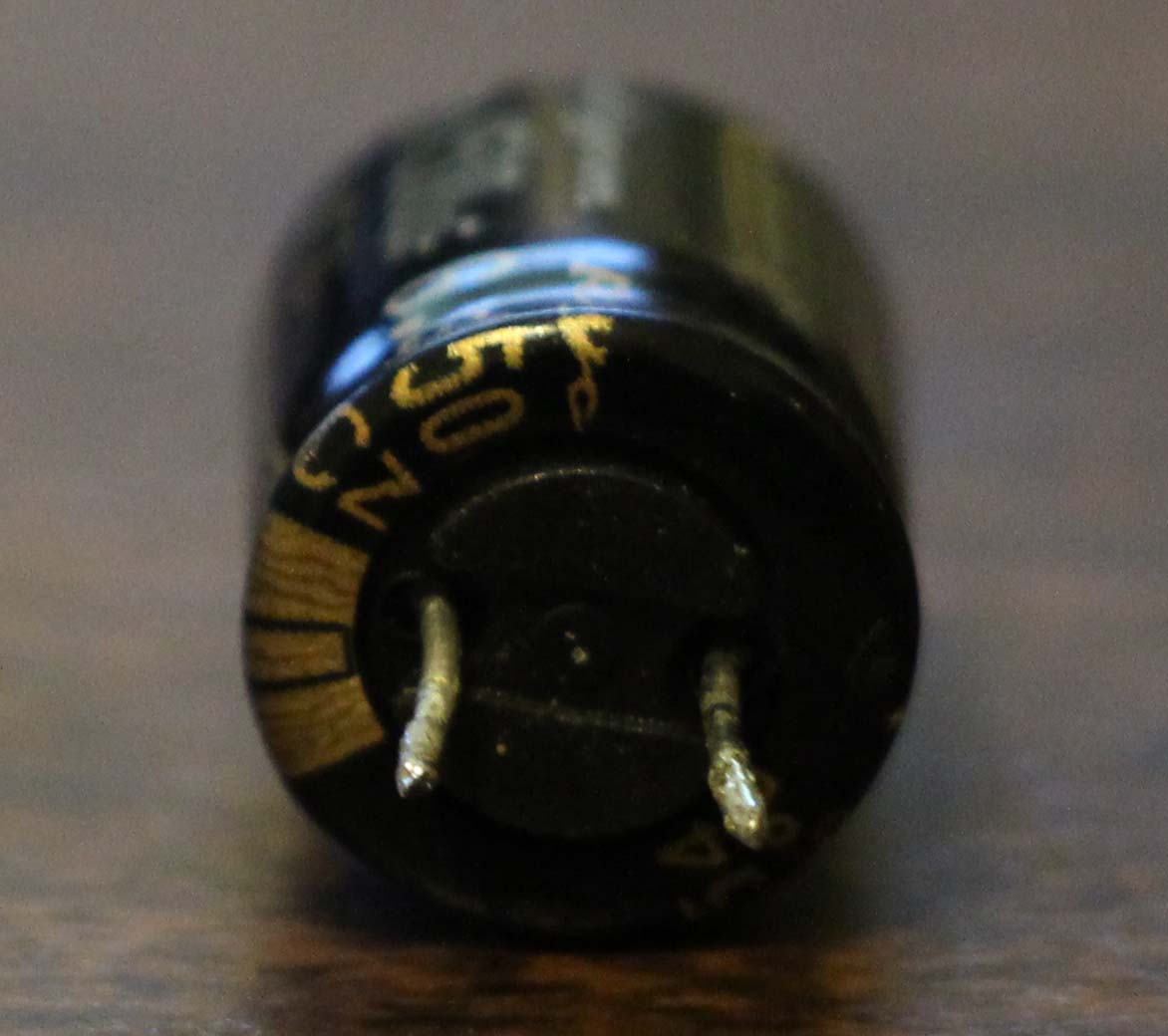

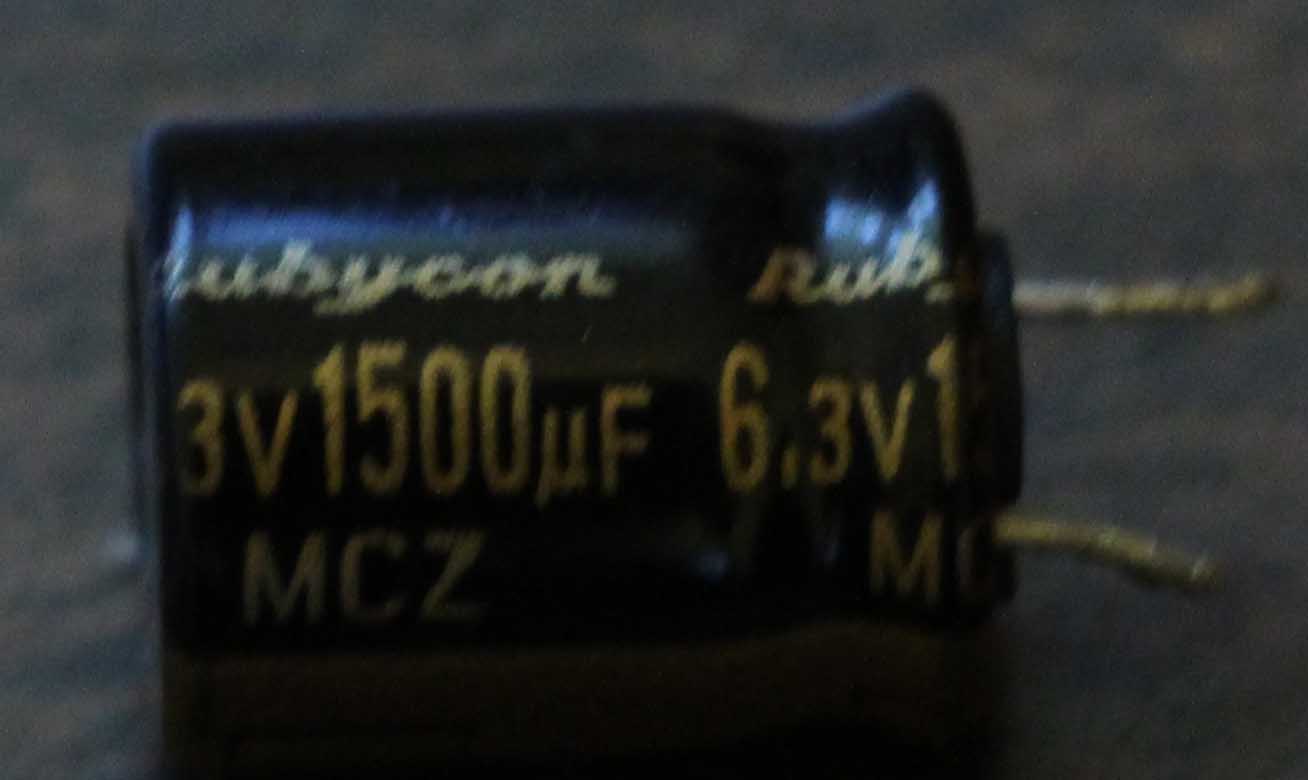

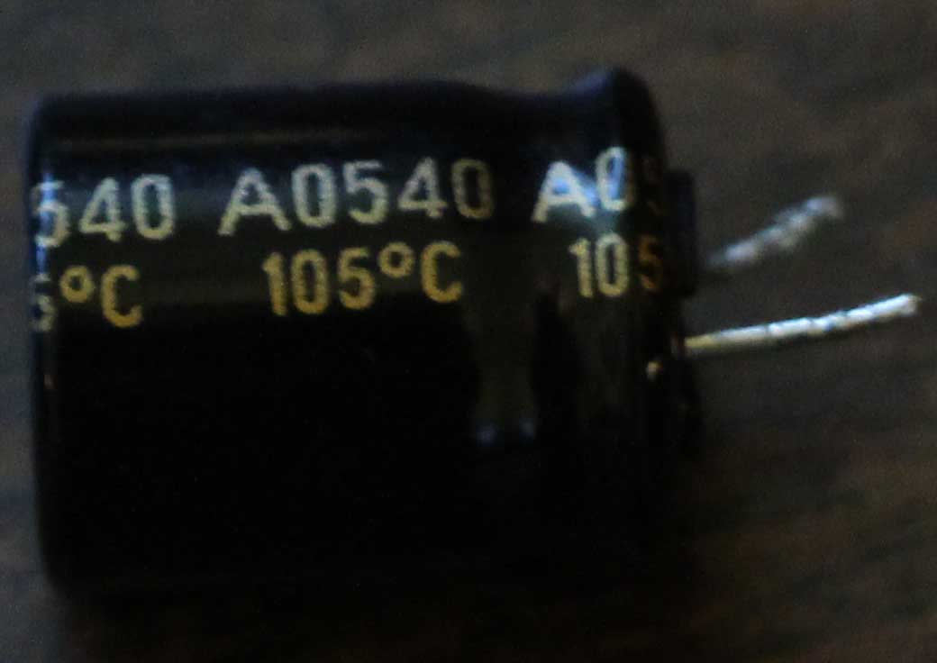

              I would suggest posting some pics of the eBay caps.
              Post photos of the bungs as well as the vent. I can see the bungs on the eBay auction photo, but can't see the vents. Post each anyway, just to be sure on both as for what you received that is.
              Then the experts here can identify whether they're fake or not.

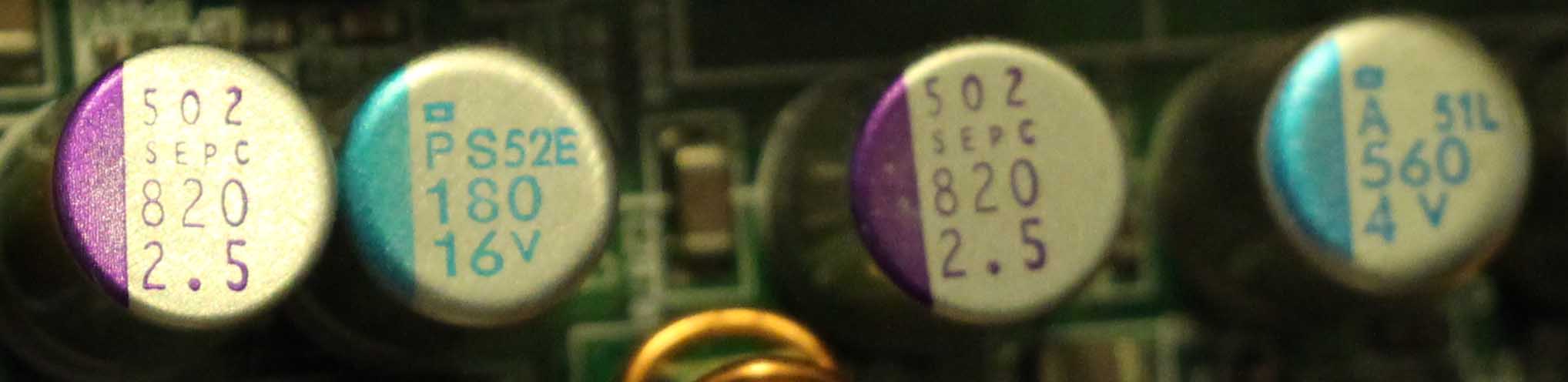

              What brand/series are the blue polymer/hybrid caps I see in the photo?

                          First off, I didn't mean to offend you Topcat and your site. I did look through your store for some Rubycons in the 1500uf 6.3 and did not find any. I didn't even look at other brands because after reading many sites, I thought rubycon was like the better brand. Don't forget I am noob with this stuff so I don't know what's what. Also, I noticed on your shipping page you said you only ship on Tuesdays and Fridays. I wasn't sure how long it would take to get them and I had a brother-in-law wanting something done fast for his business, so I jumped and ordered the ones I ordered. I have another board or two laying around that I want to play around with and there is no rush on those, so I will order the next caps from you. Again, I apologize for doing what I did.
                          Thanks for the reply y_not. Sorry if I got you in deep caca.
                          I took some pictures (hope they are clear enough) of the things you asked about. I de-soldered the cap that I put on backwards and left it off thinkng that it might have blown it. That is the cap that I took photos of.
                          The 820uf caps I didn't replace on the second board were already rubycon mbz's. Just an fyi on this board, there are 2 220uf KME caps, and 3 16v 1800uf KZG caps. The rest are ruby's of some sort or poly's which I took photos of. On the system that is running now after I replaced the 1500uf caps, it had 820uf kzg caps still on it.
                          Hope this helps.

                            The blue polymers are Sanyo/Oscon. The others are UCC. Brand wise they are good, and failure rates are low in polymers assuming no moisture gets in them.
                            With those UCC KZG/KZJ caps, it's my understanding that they should always be replaced, mo matter what. They're a good brand, just a bad series. They can't handle the heat and they like to dry up, going way out of spec sometimes with no visible signs of failure. Near as I can ascertain, the KMEs should be fine, series wise.
                            Of course one never knows for sure without an ESR meter. So replacing the aforementionedseries may, or may not fix anything.
                            As for the reversed cap, I can't really comment on that, someone else more knowledgeable than I will have to answer that one. Which cap was it, ie. where is it located on the board?
