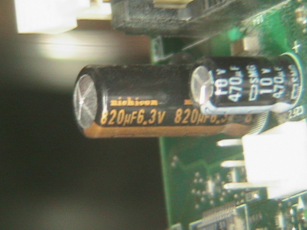

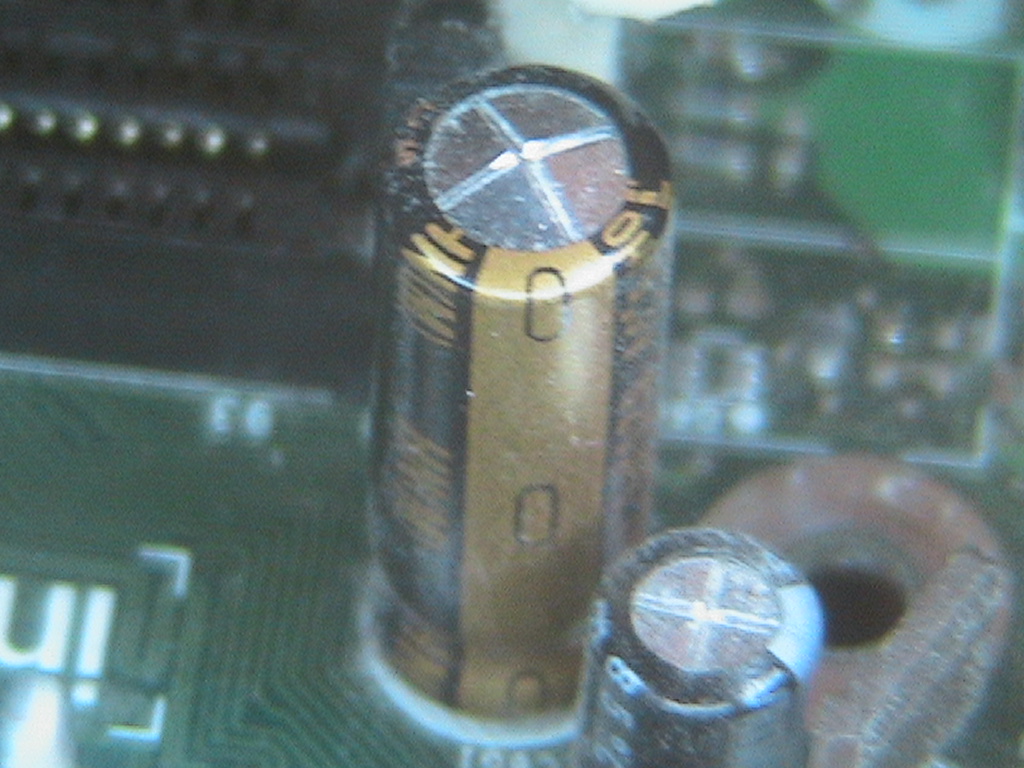

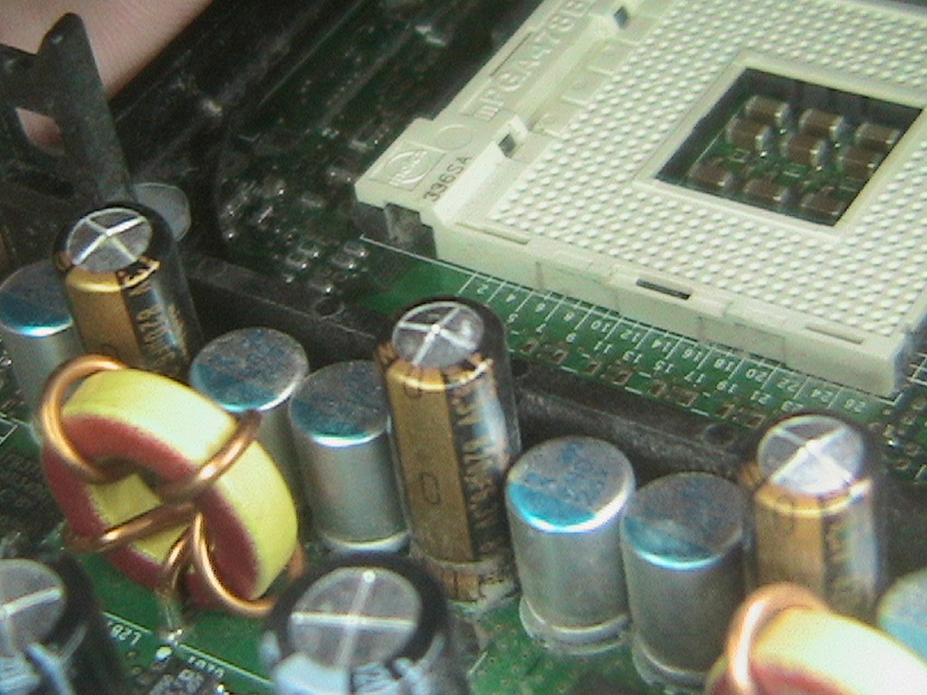

    I powered off the system again and upon further inspection, noticed some caps that were bulging.
    I have a few reasons I'm seeking the lowest cost solution that are not particularly of self-interest (see: family). I saw Intel offers a 3-year warranty on their boards, though I believe I'm just outside that window.
    My question: Are these caps causing the problem? I know it can't be said for sure, but what do you think?

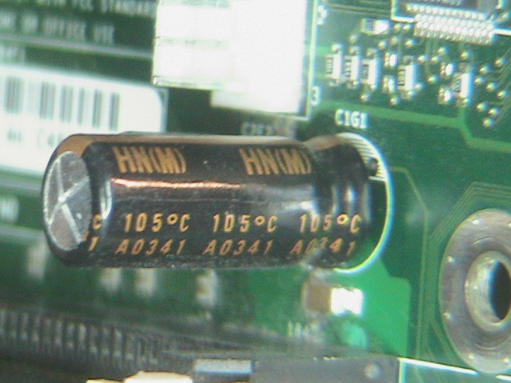

    yup those HN(M) are bad.
    try outside warranty replacement with intel they are aware of this problem. you will have to be pushy though.
    dont bother any more troubleshooting until the board or those caps are replaced

        Same Nichicon caps here --> https://www.badcaps.net/forum/showthread.php?t=2866

          Classic case of bad caps. Shoot me a PM if you want it recapped.

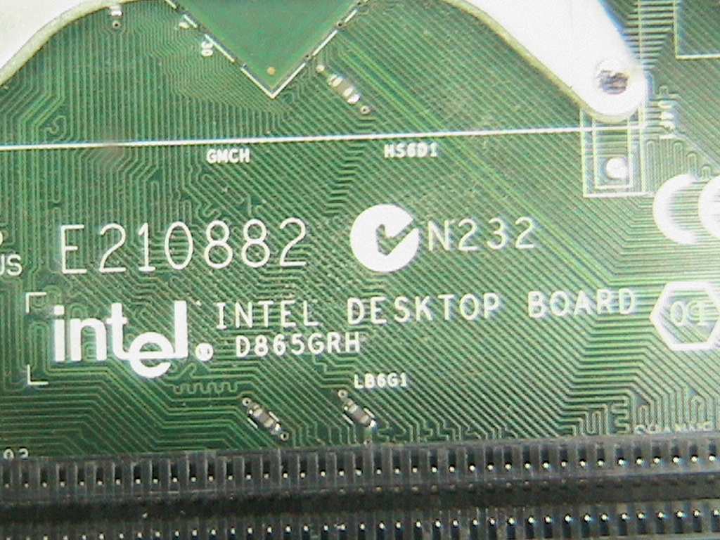

            Big Pope: Yep, we've got the same caps. Our boards look very similar as well--the d865 series.
