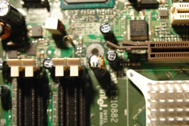

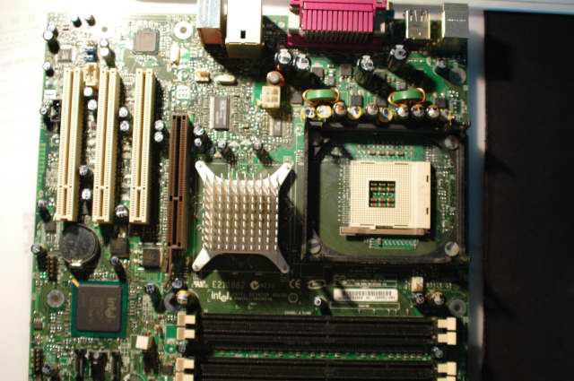

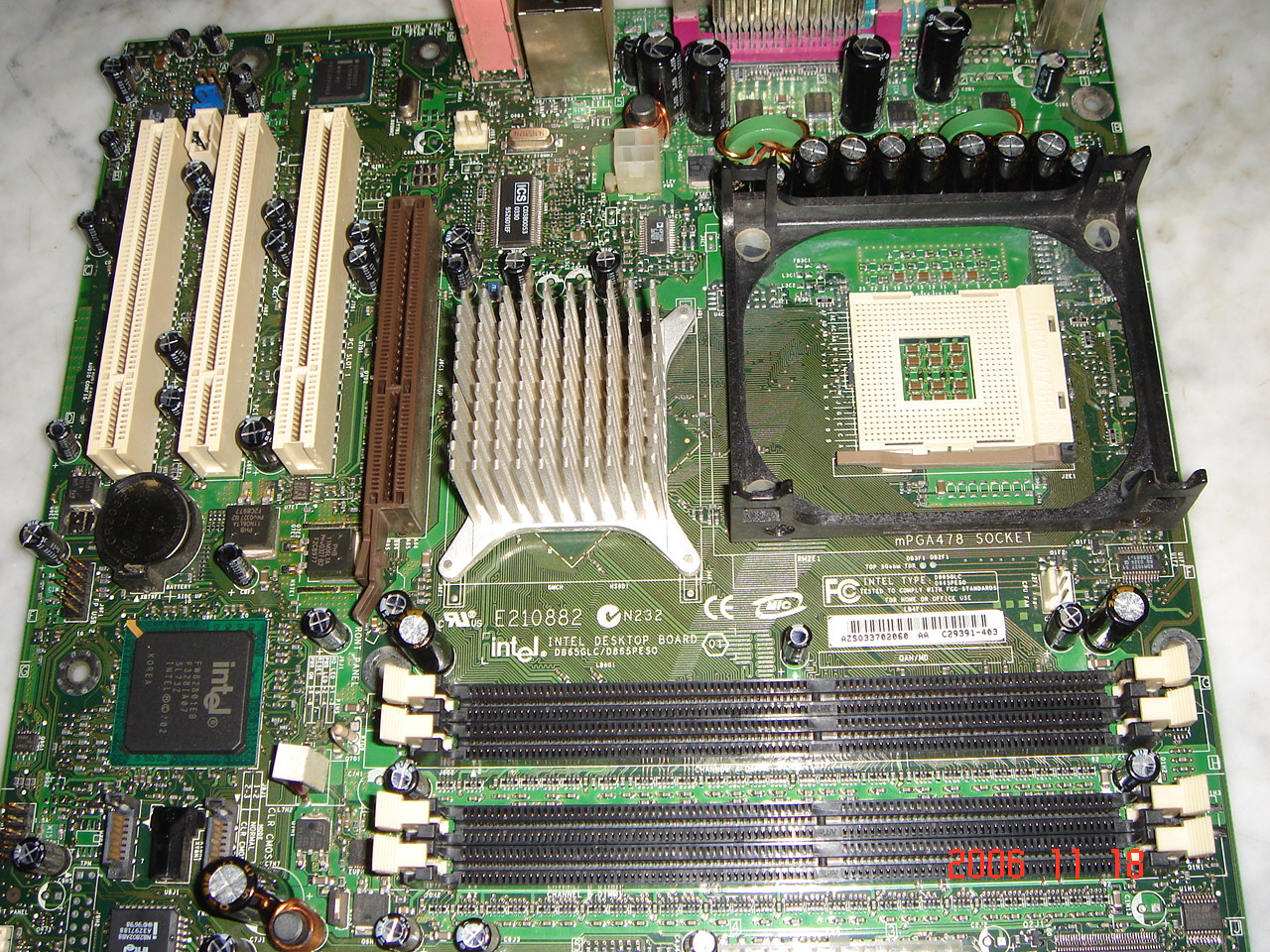

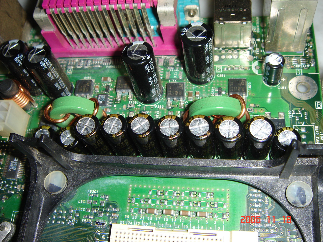

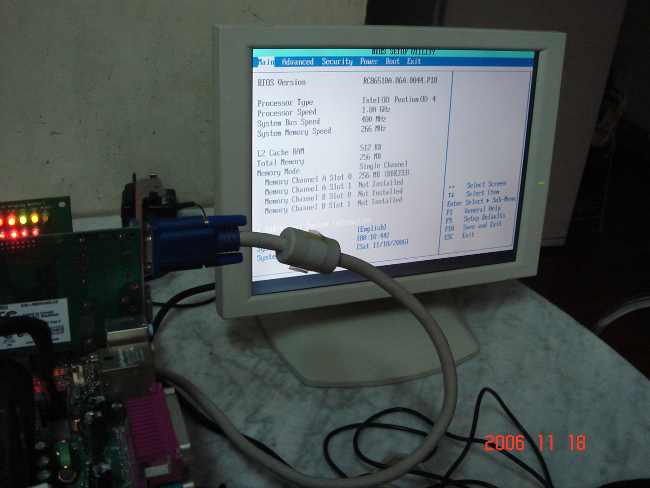

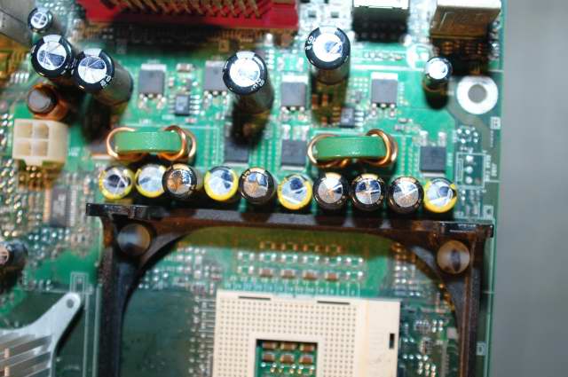

    I heard some users' Intel mobo crap with Nichicon 820uF 6.3v, and don't know how to got replacement. I got a Intel D865PESO last week, and some of Fujitsu polymers(yellow caps) on CPU VRM(output).

    Now, recapped with Samxon GC 1500uF 6.3 D8mm at all, rock stable.
    Of course also can recap with others brand Ultra Low ESR caps, such as Rubycon MBZ/MCZ and UCC KZG/KZJ etc..

      I've seen a stock board that has Rubycon MCZ at the VRM output and Nichicon HD for a few larger caps, including VRM inputs. The caps must have been upgraded mid-production.

          Yes, but there are only a limited number of series that offer 1500/6.3 in 8 mm - including Samxon, Panasonic FK/MCZ, and Chemi-con KZG. You may have better luck with 1200/6.3, where Chemi-con LXZ is widely available, but does not have as low an ESR as the MCZ or KZG.

                                Because I don't trust reliability for these 5 Fujitsu polymers (yellow only), so i recapped at once.
