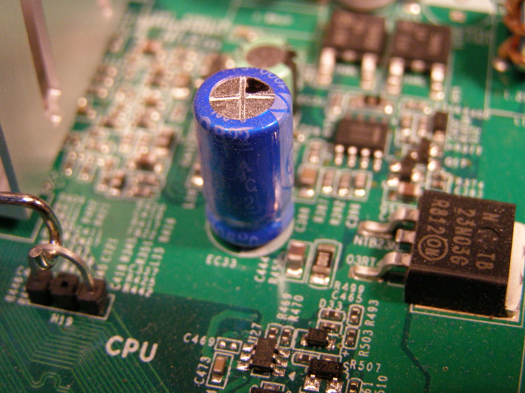

    IT dept. sold me a half dozen dc7800's, all with at least one bad cap.
    I've read a couple of posts on here where people said get rid of all OST caps. That would be a big project, because HP used a bunch of 'em on these boards.

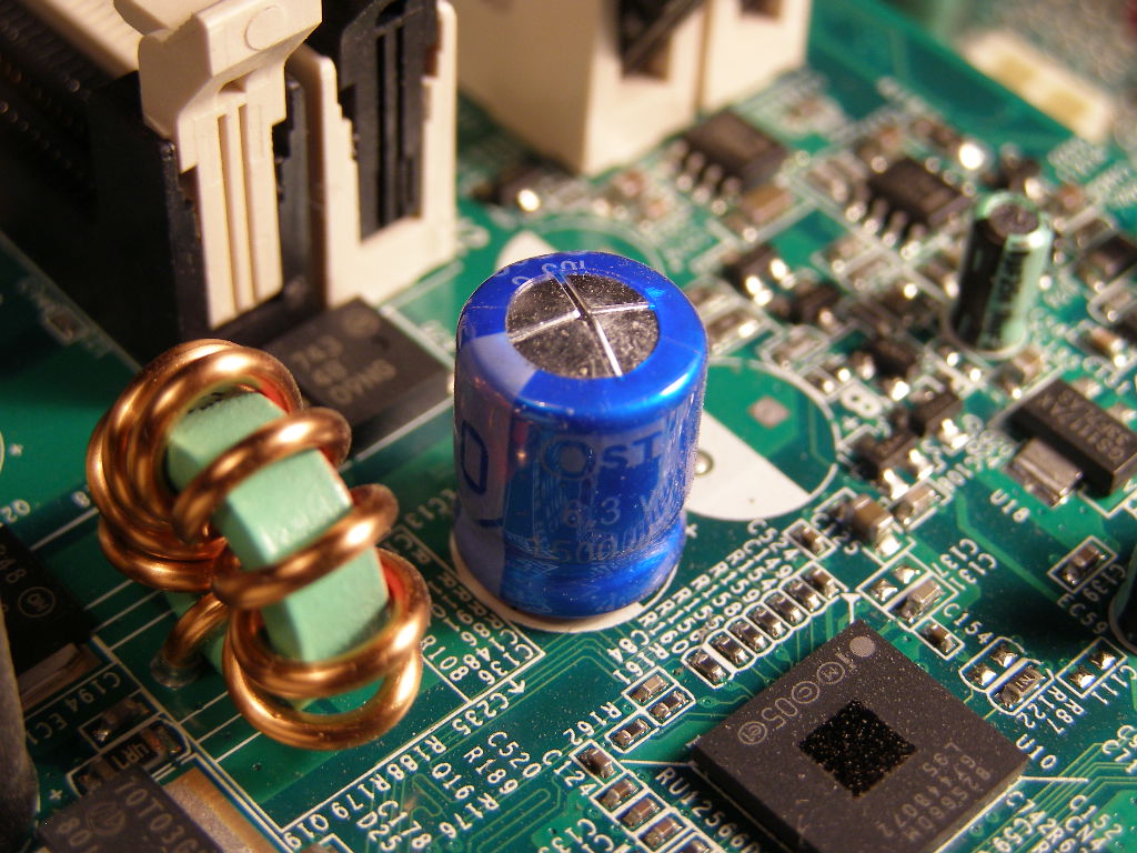

    5 of 6 boards have a short, fat OST 6.3v 1500 uf cap next to the memory sticks (1st attachment) and they're all swelling. The 6th board has a black & gold cap instead (Rubicon) and that one looks OK.

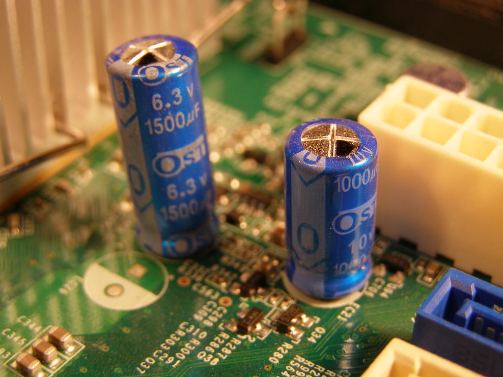

    There are some 10v 1K uf OST's that are swelling. 2nd attachment.

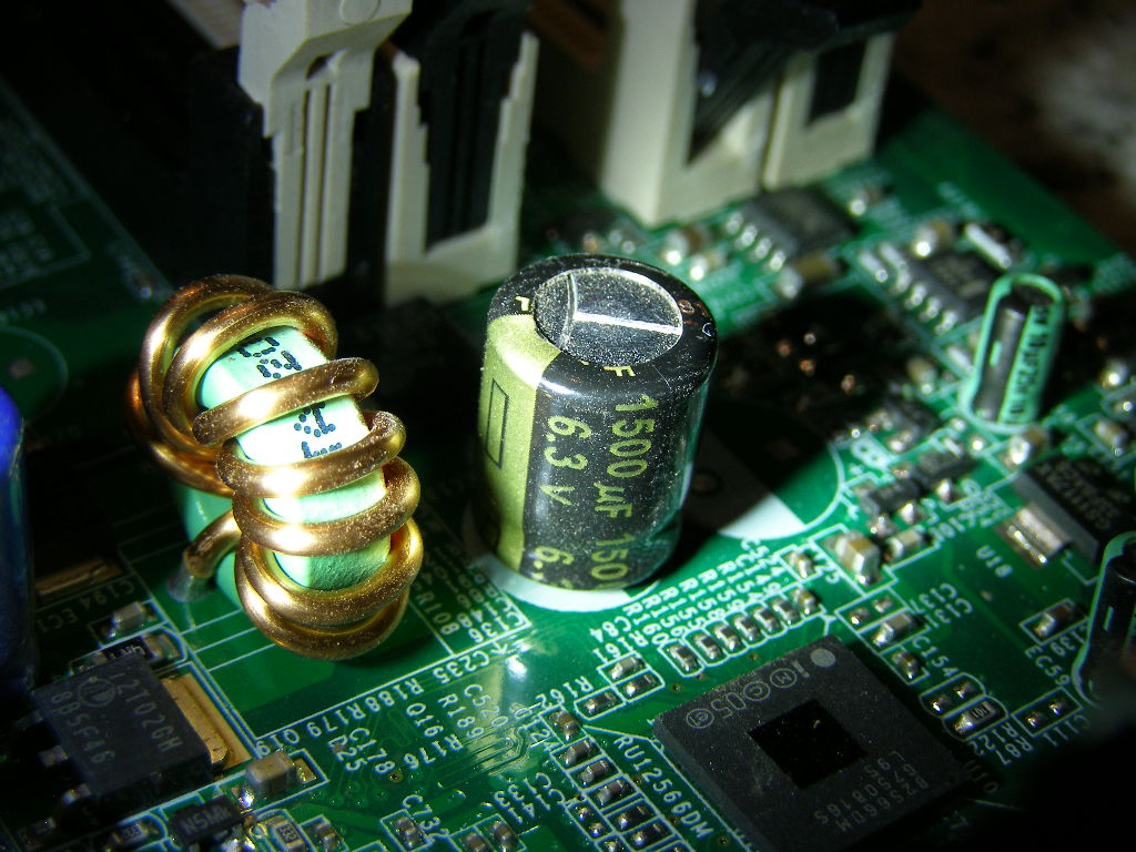

    There are some taller, thinner 6.3v 1500uf OST's in other spots that are starting to bulge. 3rd attachment.
    I don't have the right tools for this, but maybe I can get some help. My first question would be about those OST's. Are they that cheap of a brand that you would consider replacing all? Or just the ones that are visibly sick?

    3-4 of my last 5 motherboard failures happened when OST caps popped around the DIMM sockets.

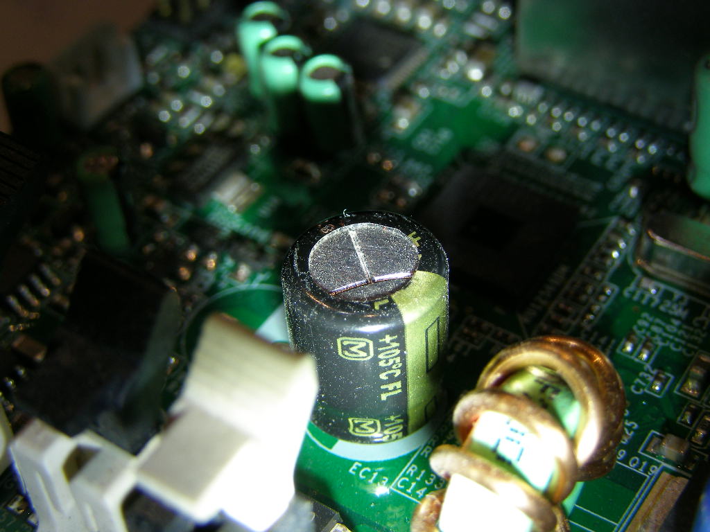

        In the first post I mentioned that all but one of the boards had bad OST's right next to the DIMM sockets. So, I thought, let's get the exact model from the one board that didn't fail. The attached pictures show the cap that replaces the OST RLA on the one board out of six. The black color made it hard to get a decent pic. The black/gold looks to this newbie like a Rubycon but it's such a stubby capacitor that all I can see for an identifier is that "W" or "M" inside the box. Anyone know what this is? AFAICT they're 10mm by about 12mm. Very short because it sets almost below the DIMM socket retainer lever. I could get away with a few mm taller...
        If someone would just please tell me exactly what to buy
        I poked around in the Good Caps thread - that little "M" inside the box is Panasonic?!? OK, wait, the M stands for Matsushita. It appears FL is not common?

              Both are trash series (as is Ost in general) that should be replaced regardless of their state, especially in small "mini-oven" SFF and USFF desktops.
              Yes, the [M] loo in a box stands for Matsushita, aka Panasonic. FL are actually used quite often on motherboards so they are not uncommon. However, Panasonic sells FL series caps only to board manufacturers, so that's why you won't see them for sale in any store.

                      OK, thanks, the Good Caps thread mentioned several Matsushita caps (FE & FZ I think?), but FL was only mentioned once so I assumed it was rare.
                      Probably FC, FM and FR. I don't think there is FE or FZ series from Panasonic. There is FZ series from Sacon - those are extremely horrible (i.e. they usually go bad and litteraly pop/explode). If you have some older mid-to-low end EVGA video cards (and also XFX, I think), check them. They are notorious for having Sacon FZ.
