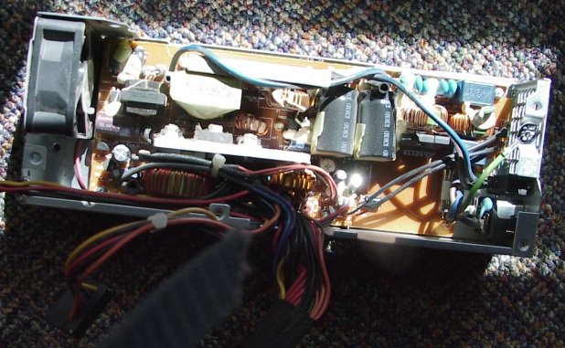

    An HP Slimline S3321p appeared dead.
    suspect: Power Supply
    HP P/N: 5188-7520
    Delta Electronics P/N: DPS-160QB A Rev: 01 F
    It has a mini motherboard connector so I couldn't immediately hookup another power supply to test.
    after popping the cover on the PS
    PCB
    Delta P/N: DPS-160QP

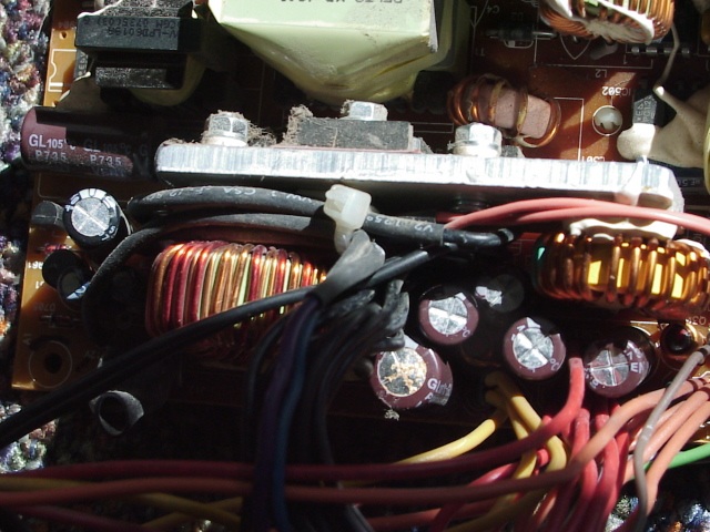

    I noticed a swollen cap
    decided I would give it a shot so I disassembled the PS.

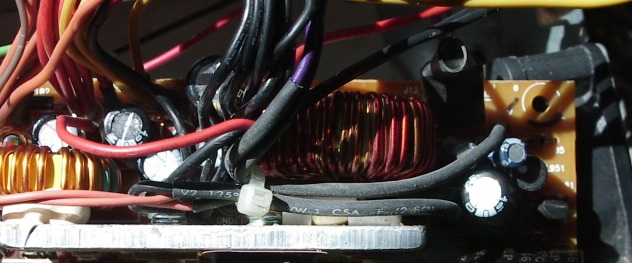

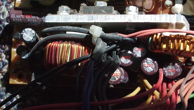

    Upon further inspection, hiding under the motherboard bundle, I find more blown/swollen caps

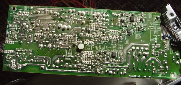

    Back side of board looks good (???)
    After digging through my capacitors I have them all except 2.

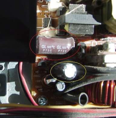

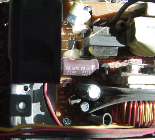

    The first cap I saw was 1500uf 16v so I decided to substitute in a 2200uf 16v (???)(red oval).
    The 2nd was a 1000uf 10v (HD)(yellow oval). I did have a 1000uf 10v (HM), but I didn't substitute. (???) Old one looked good so I left it. (???)
    If I read the board right:
    C904 1500uf 16V substituted: 2200uf 16v
    C152 1000uf 16V
    C303 1000uf 6.3v
    C103 1000uf 10v
    C302 1000uf 6.3v
    C102 1000uf 10V
    I get them replaced
    put it all back together and the computer fired right up.

        I did the same repairing. There was a blackout in the house and when the power returned the HP Slimline didn't start. The PSU turns the green led on when connected, but when you make connection between power on and gnd, it will turn off. So I opened the PSU and took a look to the caps. Three of them were leaked: the one that Hoare marked with a red oval, and two of the section from the third image he posted (both of 1000 uf, can't remember exact voltage). The problem was: that section is really hard to work, all the components are too damn close. So you need to remove all those caps there to see if they are leaked or not.
        Denpending on where you live, this PSU is hard to find or is a little expensive, so I'm happy I could repair it using just a few caps removed from old mobos and non-working PSUs. Your post helped me to find all those bad caps, thank you.
