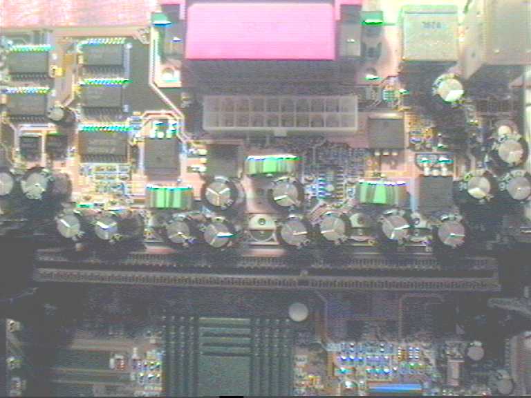

    Abit BE6-II v1.2 - Bad Caps
    Abit BE6-II Version 1.2 with badly swollen Teapo and Jackcon caps. This is one board that a 10mm cap replacement would be near-impossible!! I used all 8mm Rubycons, of course, working perfectly. Sorry, I forgot to take before pics, I just got some afters...
    Willawake, here's another array of pretty rubies for ya...

              You have changed total of 22 caps?
              You used 1500uF for those around slot 1 and 1000uF for the rest?
              I'm asking because I have a BE6-II 2.0 with bad caps, some guy attempted to repair but he messed up and used wrong caps in wrong order, now I don't know how they were placed in original board.
              I'm extremely ashamed for not doing the job myself, as I didn't have the replacement parts, and give the motherboard for some "experienced technician" do the job.
              And I'm afraid the motherboard will not work again because the stupid guy placed one of the caps (EC 15) in the wrong polarity!!!!! :evil: :evil: :evil: :evil:
              Aparently it has nothing else damaged, just the wrong positioned cap looks bad.

                If someone recapped it and installed the caps backward (wrong polarity), don't even power up the board! It will be a problem! Yes, I used 1500uF caps around the CPU slot, as you can see in the pictures. The rest were 1000uF caps.
                The BE6-II was a pretty standard recapping... I have actually done one of these boards in 10mm caps. Although it was difficult, it was not impossible, and it didn't look rigged.

                  Thanks for your reply...
                  The guy dumped the older caps (Jackson - Green color) so I didn't remember if the caps around the Slot 1 where all 1500uF. I'll recap it using 1500uF 10V caps instead 1500uF 6.3V caps along the slot. An the rest, all 1000uF 10V.
                  So I'll need 15 1500uF 10V caps, right? Even the first 4 small. The guy used 1000uF caps to replace those 4, man what a complete mess :evil:
                  The "tecgnician" returned me the board saying that he recapped it twice but the motherboard failed at burn-in tests, so he said that something else should be wrong with the board, not just the caps.
                  But now, when I got the board back in my hands. He was supposed to be a person that knew what he was doing. I noticed ONE cap placed in the wrong position.
                  I don't know if the guy turned this thing on like that and the motherboard died or if it's still working. Gotta replace all caps with quality caps before doing any tests.

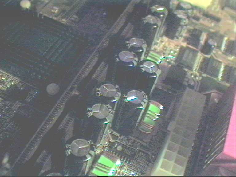

                  Actual pictures:
                  As you can see, the bad cap is marked by the red arrow, it's normal laying sideways because it's a 10mm cap and not enough space there, but u can see the wrong polarity and it's "bigger" than the others, I don't know if you understand what I mean, I forgot the right word to describe it.

                    I have a BE6-II version 1.0 that I am currently recapping. 20 (!) of 22 capacitors were bad; all 22 are Jackcon. Here is the distribution list from my board:
                    1000uF, 10V: EC1, EC2, EC3, EC4, EC7, EC8, EC9, EC13, EC23, EC24, XEC1
                    1500uF, 6.3V: EC10, EC11, EC12, EC14, EC15, EC16, EC17, EC18, EC19, EC20, EC22
                    Don't know if Krohling has finished recapping his board, but he's right; the cap is definitely backwards, although that's actually EC16.
