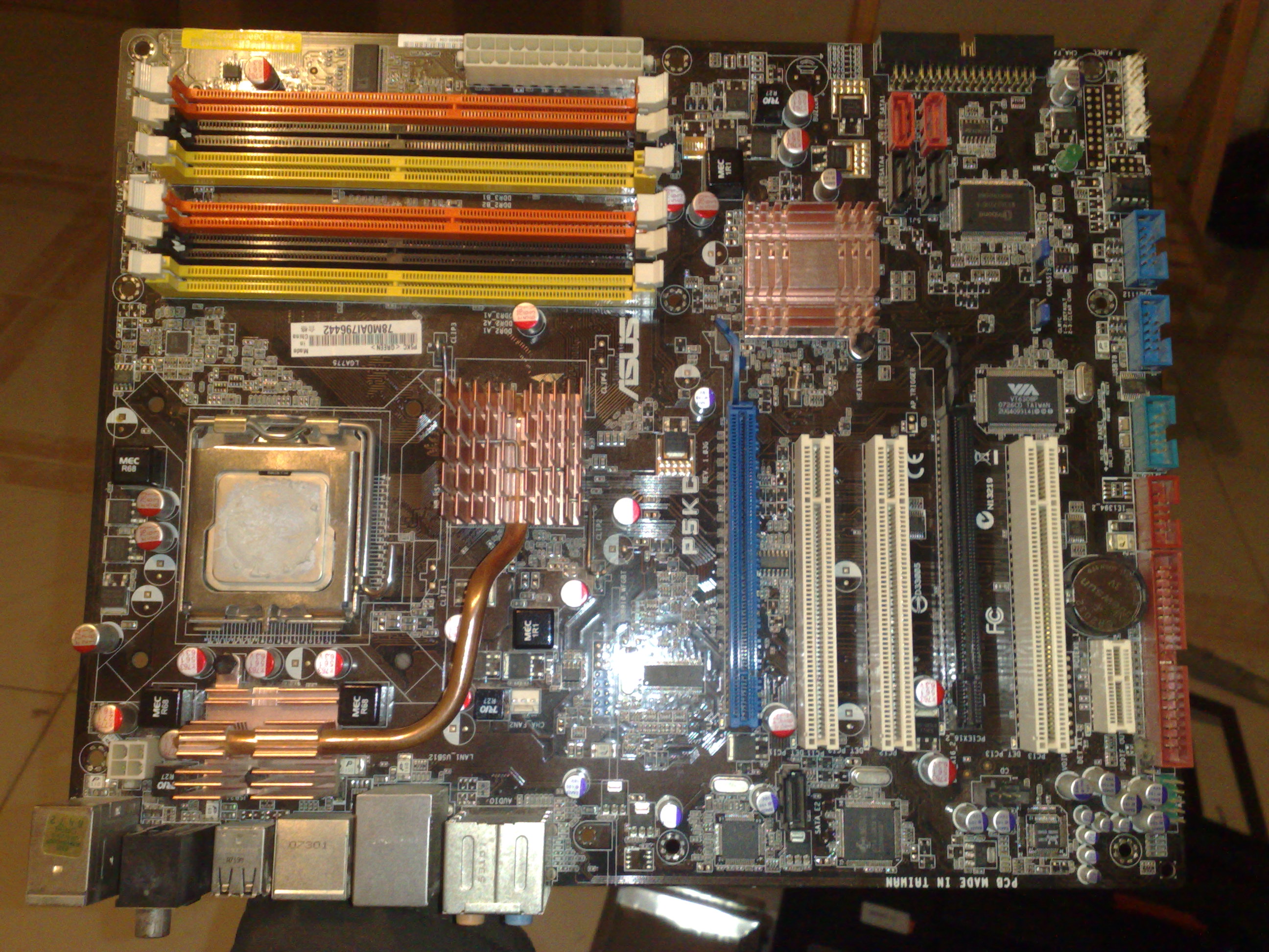

    Hi there,
    I have this Asus P5KC motherboard which I really liked (when it was still working). I wish to repair it if there is the chance.
    Symptoms:
    PC starting but no display and not even posting.
    It suddenly restarts the computer. (When it was still booting up)
    When shutting the computer down, the power supply never turns off, one will have to turn it off manually. (When it was still booting up)
    Thanks.

    It could be that ASUS random death 'feature'.

        Have you tried another power supply or opened up the power supply to see if you have bad caps?

          yes i did try 3 different psu's and the problem remained the same

            hold down firmly on nb and power on.repeat sb.bet it posts.
            bga strikes again.
            last 2 a reflow of nb and sb fixed them

                  This is a FET problem... Test the FETS (That is if yuo can desolder them) on the bottom left corner of the board. If they test OK, test the VRM FETS. Asus used underspec'd FETs on that generation of board...
                  Replace with FETs that have a higher amperage rating and a lower RDS on.

                      i held down firmly both of them and problem persisted.

                        How can I test the FETS with a meter? I'm not experienced.

                            One thing that I have to point out is that when trying to power the board on, it powers but no display. It then turns off and turns on again automatically and stays on with no display.
                            I have just noticed this now while doing a bench test.

                                  it seems that I can't figure out which are the FETS of the board.... can someone help me please?
