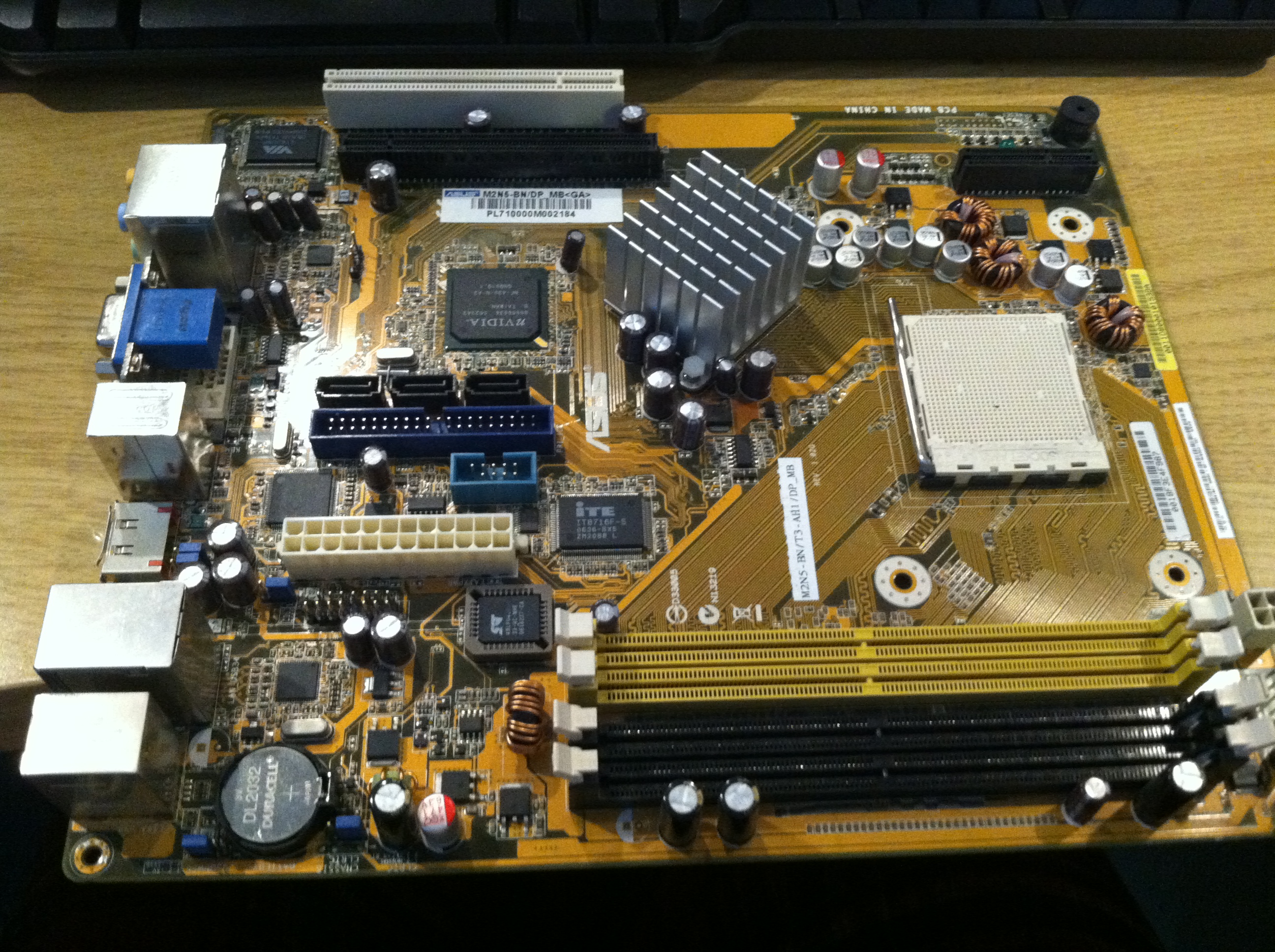

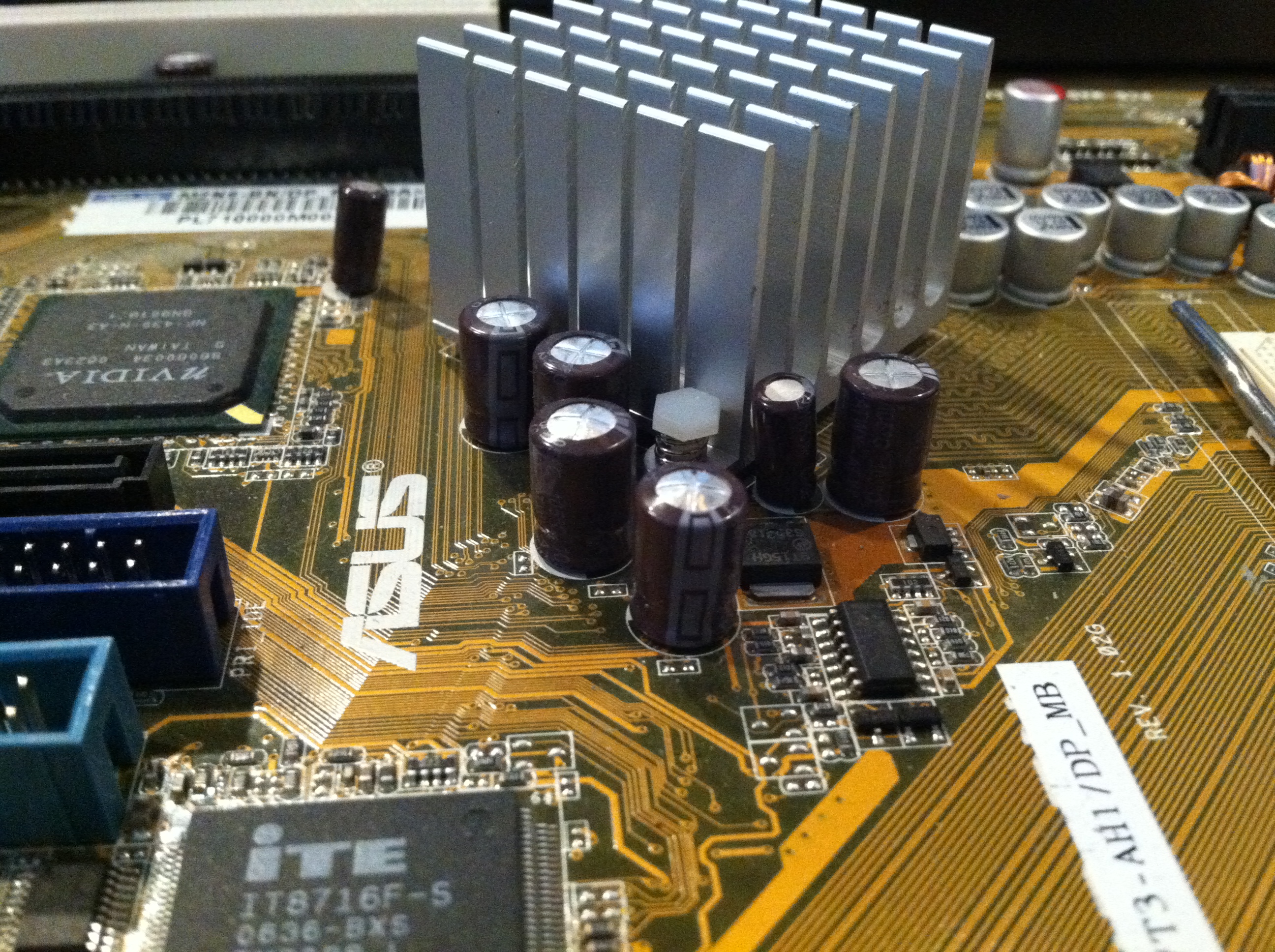

    ASUS - M2N2-BN - Barebone Board
    So I got this case free w/ a dual core CPU cause there was some blown caps. Wondering which ones I need to replace (besides the obvious blown ones). But was thinking that just the cluster by the north bridge needs to be replaced. And badcaps.net happens to have them, so I thought I'd buy from them. CAPs
    Sorry for the poor quality of photos, just used my iphone.

    Re: ASUS - M2N2-BN - Barebone Board
    No Love? Looks like I'll just repair that cluster of them by the north bridge and see what happens.
      Replace ALL of the TK caps on the board.
