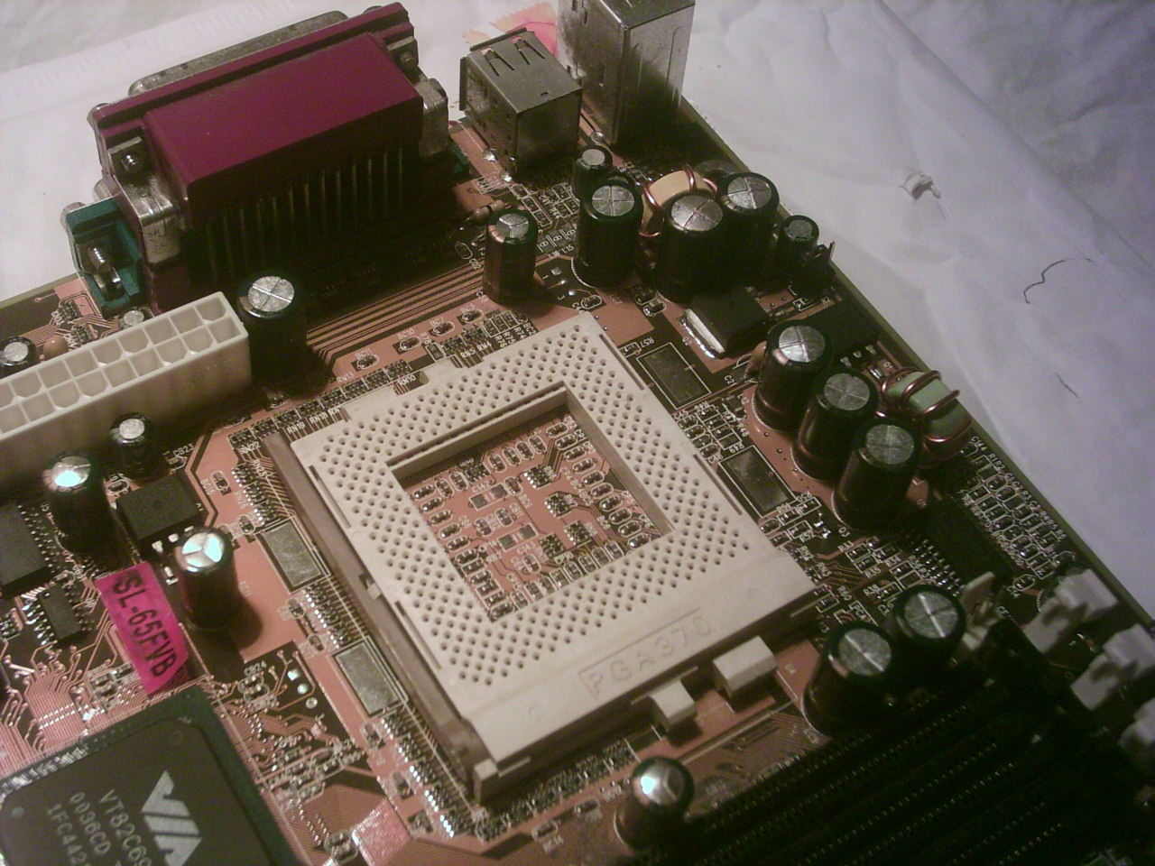

    I recently acquired a bargain P3 motherboard off eBay, as the title of this thread suggests it was a Soltek SL-65FVB, reportedly it's symptoms were "At times, it produces no picture on the screen..." amongst others
    So it arrived in the mail yesterday, and I couldn't wait to rip those Tayeh & GSC's off... in my haste to right the wrongs (so to speak), I did manage to get a before picture, the butcher's bill was high however luckily I had enough SamXon Low ESR caps on hand as it needed...
    10 x 1500uF 6.3v
    6 x 1000uF 6.3v
    And strangely enough a chipset cooler into the bargain

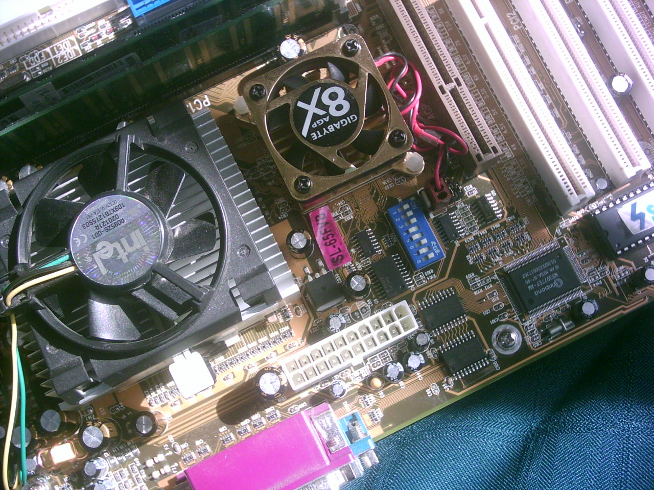

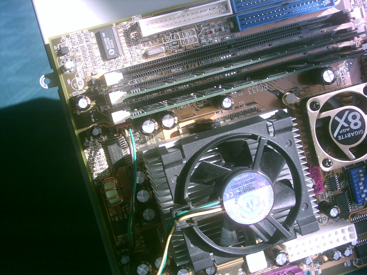

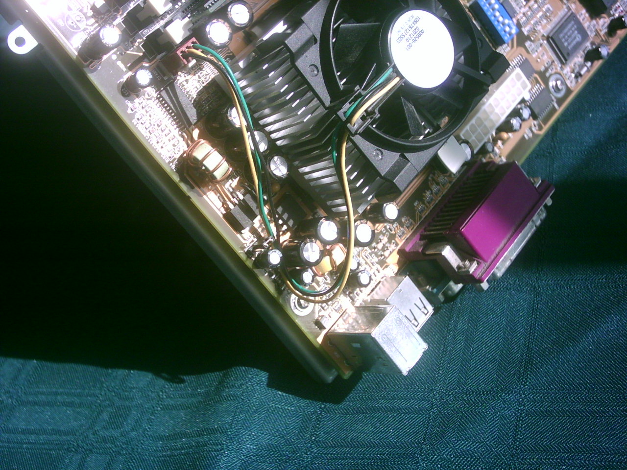

            Well it's completed the mandatory 10+ hour prime95 burn-in test flawlessly, so I'm happy to say yet another successfully recapped unit saved from the landfill!
            Thanks for your input Yanz, I haven't owned many Pentium based platforms (being an AMD fan) so the chipset info was appreciated, I still added the cooler however as most likely it'll be used for F@H, and stability (in summer especially) is everything
            So below you'll find the digicam shot of the completed work (after a nice methlyated spirits clean with a toothbrush), seems this board was produced by Soltek as a OEM package, as all identifying labels are adhesive even the BIOS/POST screens don't indicate a Soltek heritage
            As always, any questions, comments or feedback are welcomed
