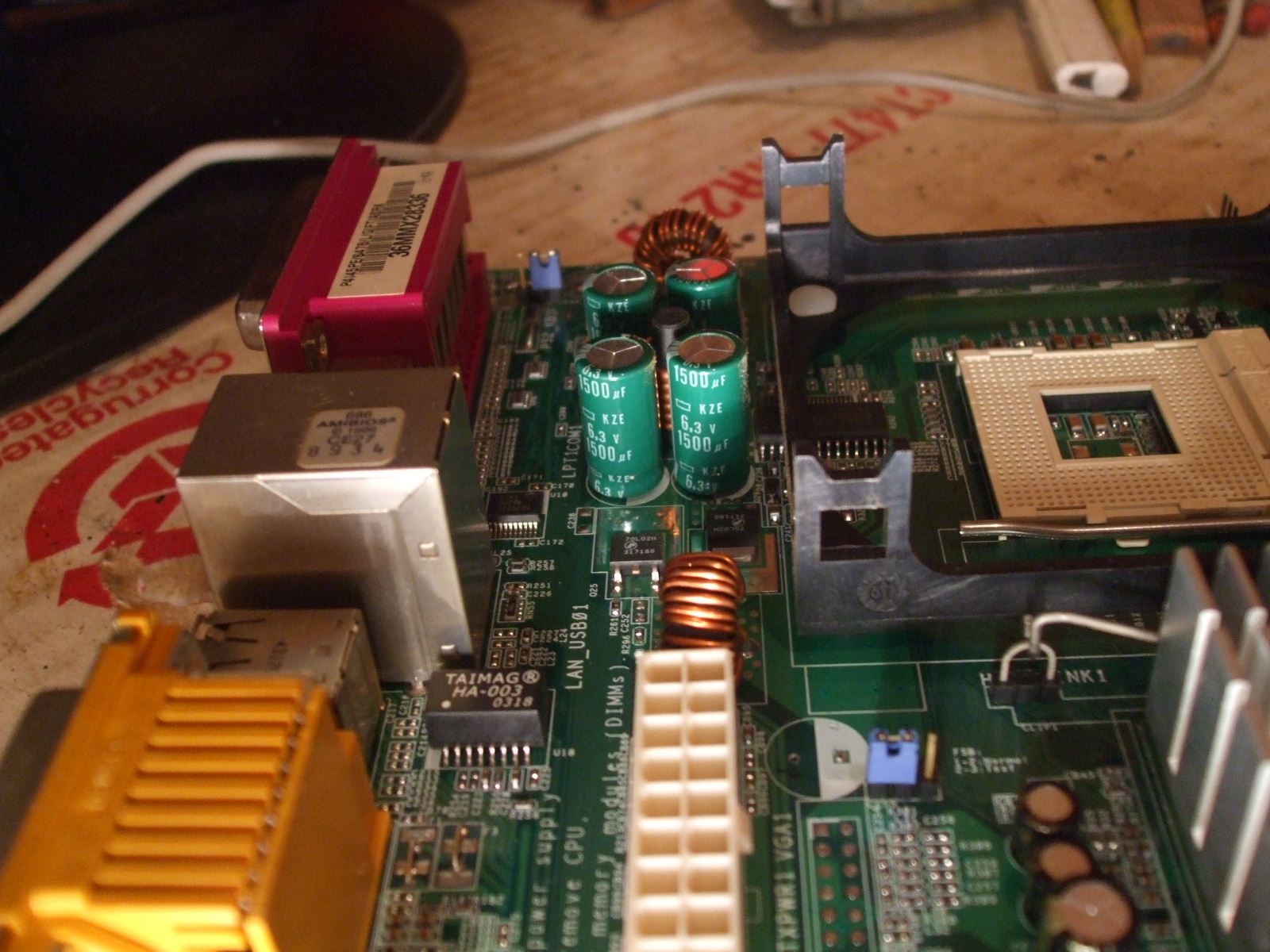

    All of a sudden, I started getting blue screens, freezing, restarts, just after posting, when Windows XP was starting. I've checked the hard drive, memory, graphic card, power supply, reset BIOS, nothing makes much of a difference. With a different power supply, it got thru the post every time, start loading windows (I was trying to do a clean install), and the process would just stop at different points when booting from the disc.

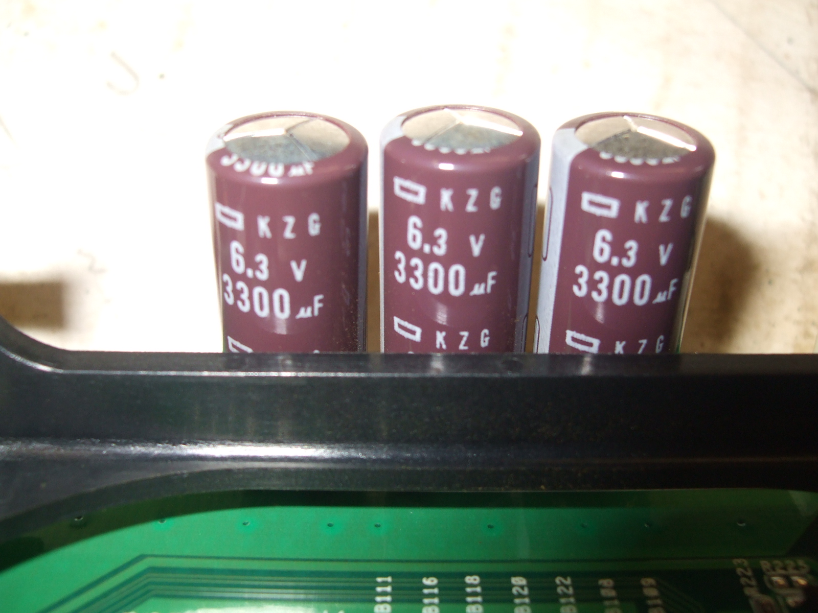

    Got it apart, all 4 of the 3300 uf caps looked domed.
    3300 uf 6.3v KZG (M) 105º
    KZG 10.3mm dia 22.23mm tall (brown)
    The four 1500 uf 6.3v look Ok, they had KZE on them 10.3mm x 19mm (green)
    Need advice on type of replacements.
    I've got some pictures, not able to upload them on dial-up. I'll put them on here later.

    Re: Bad ASRock P4i45PE Motherboard
    Replace those KZG with Nichicon HM, HN, HZ (good to best). UCC KZE would work though ideally you'd want something even better than KZE there.
        No, I meant KZE series capacitors of value 3300uF 6.3v would work instead of KZG but they're a bit less good on paper compared to those Nichicon HM, HN, HZ capacitors. They're not ideal, but in real world I believe they would work fine.
        The circuits where those KZG capacitors are connected to are quite sensitive about the "degree of performance" of the capacitors, they have to be quite high grade.
        Let's say on a scale of 1 to 100, the circuits need any capacitor with a score above 90. KZG is about 93 on the scale, while KZE is about 85-88. Nichicon HM is about 90, HN about 92-93, HZ about 95-97
        Your swollen capacitors are now probably at about 60 but you have to keep in mind, the capacitors started to go bad slowly before they even started to swell up.
        So the circuitry on the motherboard still worked even when the capacitor's quality went below 90 by quite a lot, and at a certain point it just stopped being reliable. Hence why I'm saying a KZE with 85-88 would still be safe to use, the circuitry kept the system stable with even worse capacitors.
        Other parts of the motherboard aren't so finicky about what capacitors are used, that's why you see KZE and probably other brands and series in other parts of the motherboard.
        KZG is a series made by Nippon Chemi Con / United Chemi Con (NCC or UCC, however you want to say it) that had some manufacturing issue, it's flawed, the capacitors of this series go bad often. KZJ series is another series using the same substances as KZG so it's also bad, but luckily it's not so common.
        Other than these two series, NCC/UCC is a very good manufacturer, reliable, just like Nichicon or Rubycon or Panasonic. That's why you can leave those KZE 1500uF if they look good, it's unlikely they went bad.

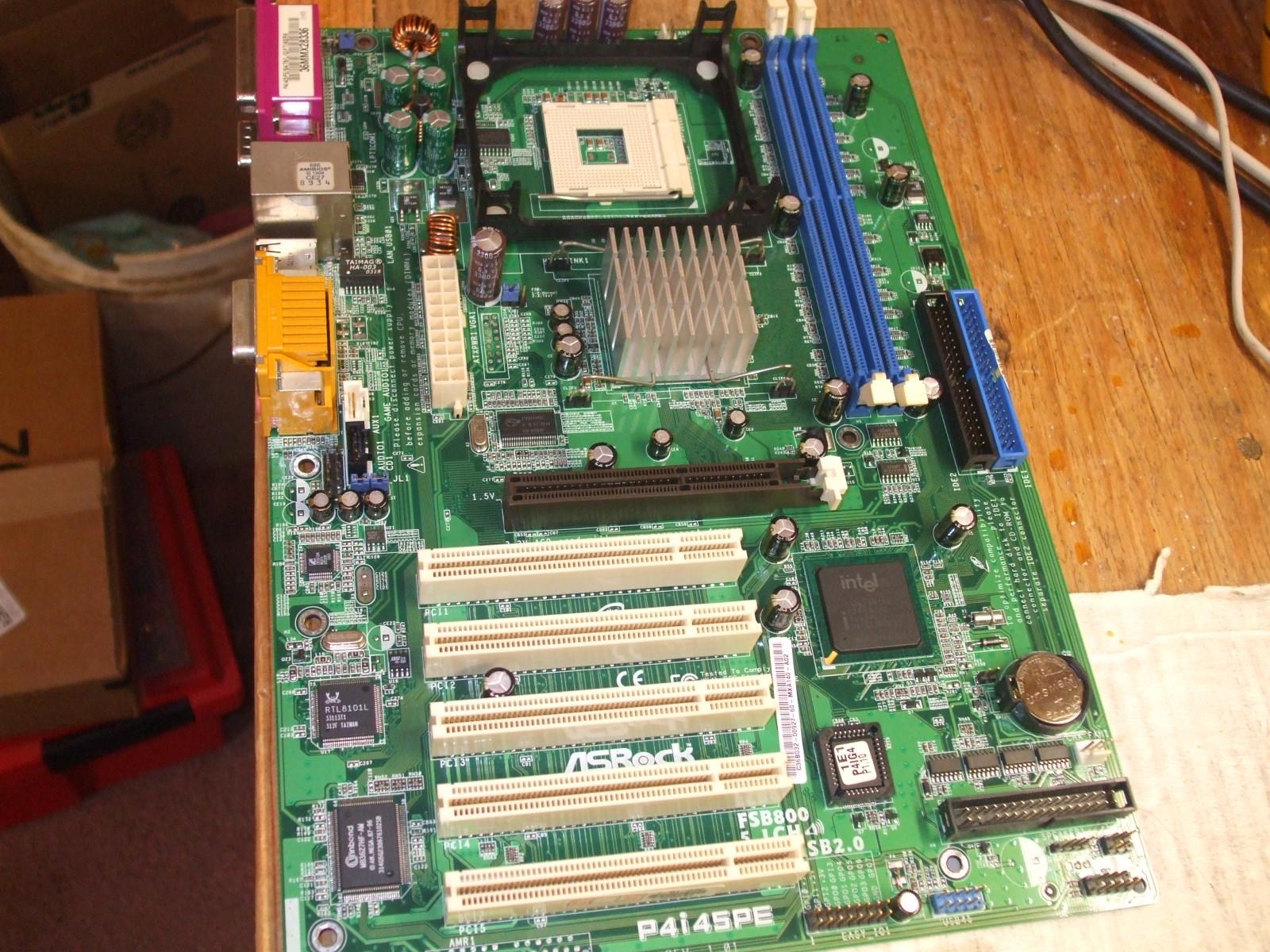

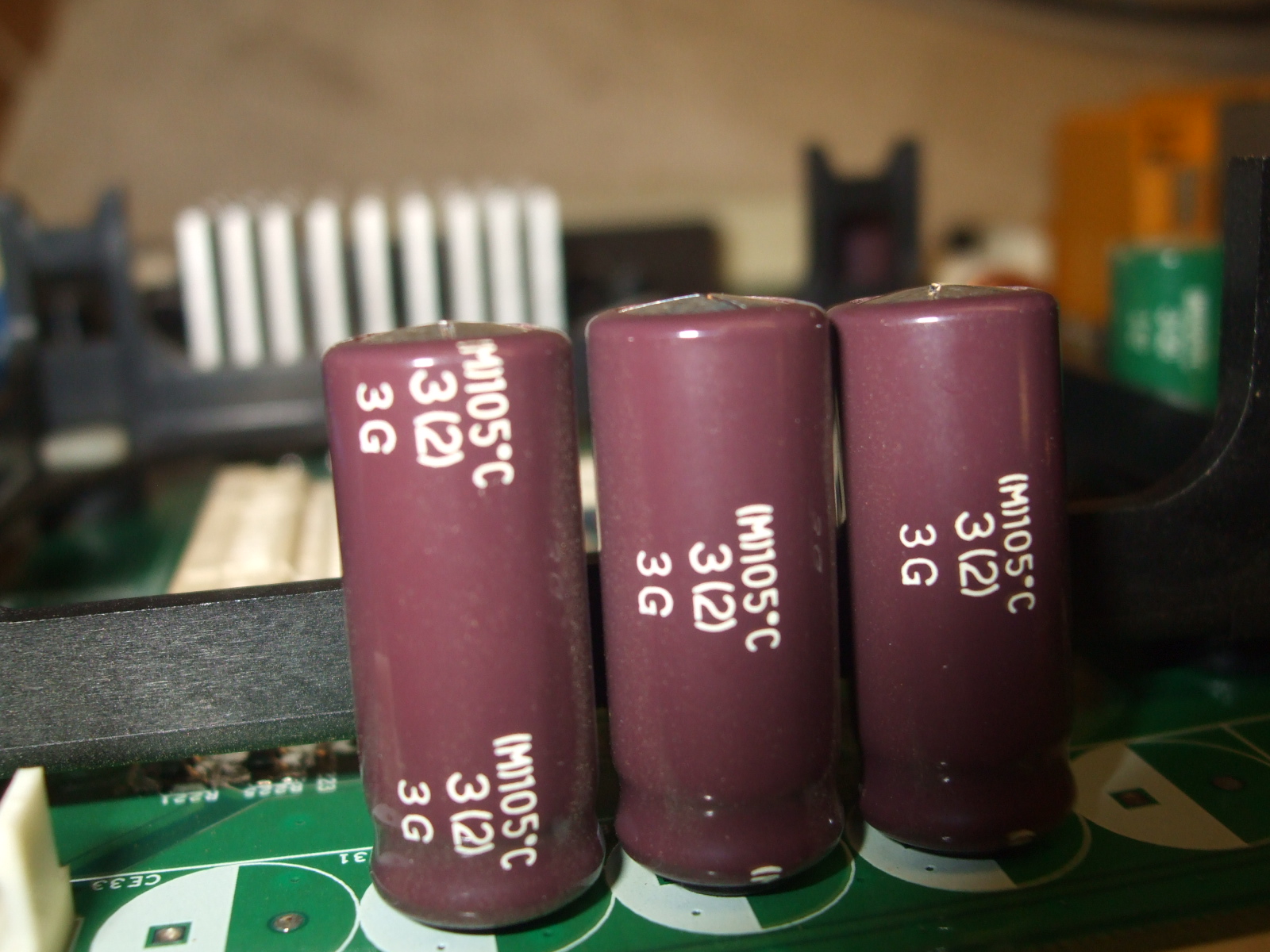

          Finally able to upload pics Of motherboard. I've gotten the 3300uf caps off the board. Still don't know about the 1500uf replacements.
          The pics should help.

            1500uF 6.3v Nichicon HN on Mouser. They are slightly shorter, and have a lower ESR than the KZE.
              Will the Nichicon HMs be OK, I jumped the gun and have alteady ordered them
              • mariushm
                • May 2011
                • 3799
                Yes, they'll be OK.
                Don't worry about it. There's quite a bit of tolerance in the board like I explained above.
                But I don't think you have to replace those KZE, I'd say replace the KZG first and run some stability tests
                    GOOD NEWS, got the 3300uf caps from Digikey, put em on the board and it works like new. I just had it set up on the bench, but it posted, booted from XP disc and I went on and did a clean install. 45 min of running, all was good.
