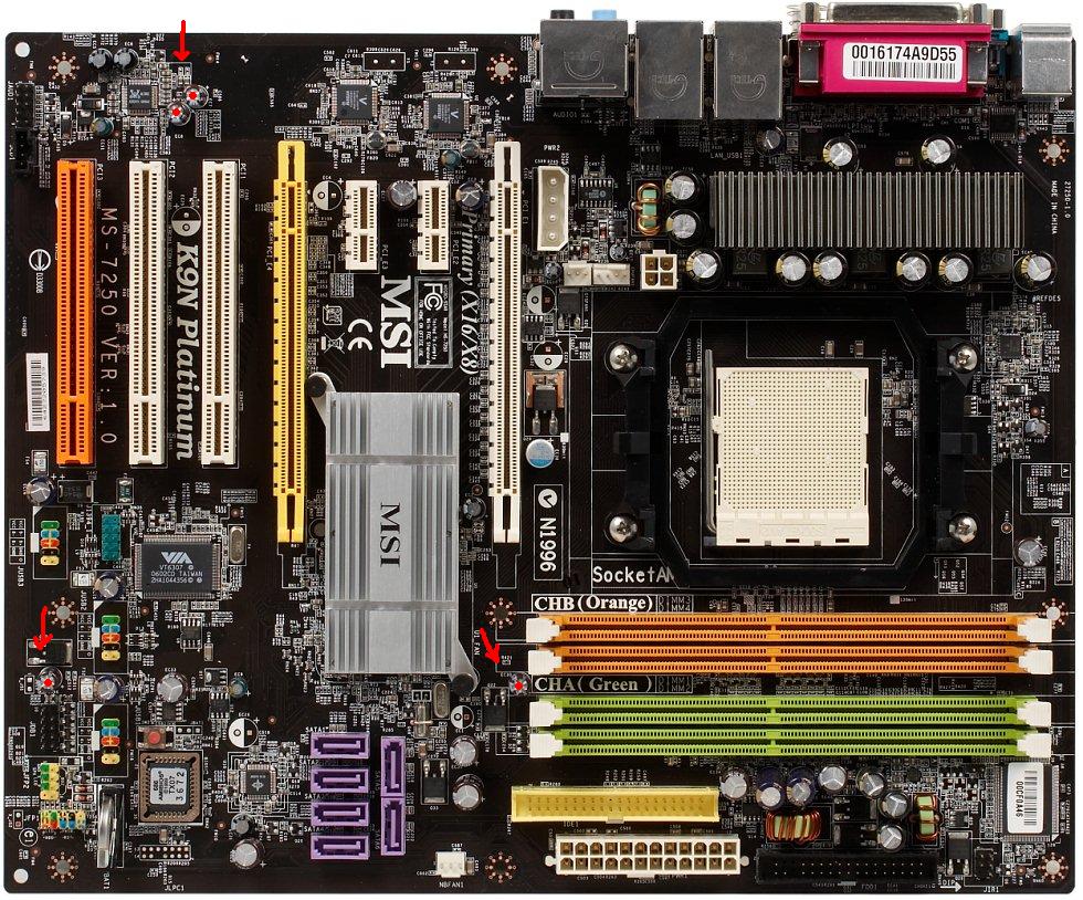

    Today I examined the electrolytic capacitors on my newly bought MSI K9N SLI Platinum. I noticed the board is packed with a variety of capacitor brands. I was hoping you guys could point out any potential problematic ones (if any).
    • Teapo
      -1x 04/06 - SS 105°C - 10V 220uF
      -3x 04/06 - SC 105°C - 100uF 16V
      -1x 04/06 - SEK 105°C - 100uF 16V
      -2x 01/06 - SS 105°C - 10uF 25V
    • G-Luxon
      -3x FX 105°C - 602 P(M) - 100uF - 16V
    • United Chemi-Con
      -5x KZG - 16V - 470uF - (M) 105°C - 6(7) - 2M
      -7x KZG - 6.3V - 1000uF - (M) 105°C - 6(7) - 2M
      -1x KZG - 6.3V - 1000uF - (M) 105°C - 6(7) - 2I
      -3x KMG - 6.3V - 470uF - (M) 105°C - 5N - N(Q)
      -1x KMG - 6.3V - 470uF - (M) 105°C - 5N - L(Q) (not sure about the L(Q)..was a bit unreadable)
      -3x KZJ - 16V - 1000uF - 5(9) - P3
    • Panasonic
      -2x 61IIOU - 1500uF - 6.3V - +105°C FJ
      -1x 62IIRZ - 1500uF - 16V - +105°C FJ
      -2x 62IRZ - 1500uF - 16V - +105°C FJ
      -1x 61IRS - 1500uF - 16V - +105°C FJ
      -6x 62IVTR - 3300uF - 6.3V - +105°C FJ
    I also would like to note that some of them are not installed 100% perpendicular to the motherboard..does this matter? Some of the Panasonic ones look a bit "filthy" on the top compared to the rest, nothing major though. And some of them have a bit of white sticky substance on them (some sort of glue I guess), I also find this on my MSI graphics card.
    Thanks!

    all values below 330uf are disregarded because likely not to fail. the rest are fine. KMG are general purpose not low esr caps, where are they located anyway for curiosity's sake? its probably fine though.

      Sounds fine to me. Similar to my EPoX, except that there are Rubys in place of the UCCs.
      The little G-Luxons are on everything, but I've never seen a little one fail...yet...now I'm jinxed though.
        I included a picture of the board, the KMGs have a red dot and a red arrow pointing towards them.

          well who knows what those caps do.
          it has three phase power which is poor but they certainly did not skimp on the amount of caps. tell us how it goes.
            Re: my MSI K9N SLI Platinum
            MSI has other quirks, so they usually do not install those high uf ceramic smd caps on the board and they had left some silk scren where some elektrolytic caps should be installed.
            In my opinions, trodas work has for me proven the importance of those bigger ceramic caps, as for the first micro or nanoseconds of an transient the bigger caps can`t deliver the current. This is not particularly new for anyone familiar with elektronics.

              i would like to say that i no longer agree with this. recaping those tiny caps (teapo or else) arround bios battery/cmos chip on some 3-4 year old mobos will cure some misterius problem like unable to restart/shutdown altough the pc is 100% stable. i would say it's not urgently to recap those little caps, but eventually it need to be recapped.
              all the panasonic caps are made in 2006. thanks for including the details (date code of the FJ caps). i would be very interested to know the height of those FJ caps (to be included in my database of FJ caps, FJ caps caractheristic is about the same with OST RLX)...
              i think those KMGs are fine there. those places probably wont have excessive loads, so no need for caps with lower esr, just the capacitance will do.
              about what gonzo said, that is if you want to overclock your cpu to ~3ghz and you need to do about every optimization that are possible. but for me, i wont do that with a msi board.
