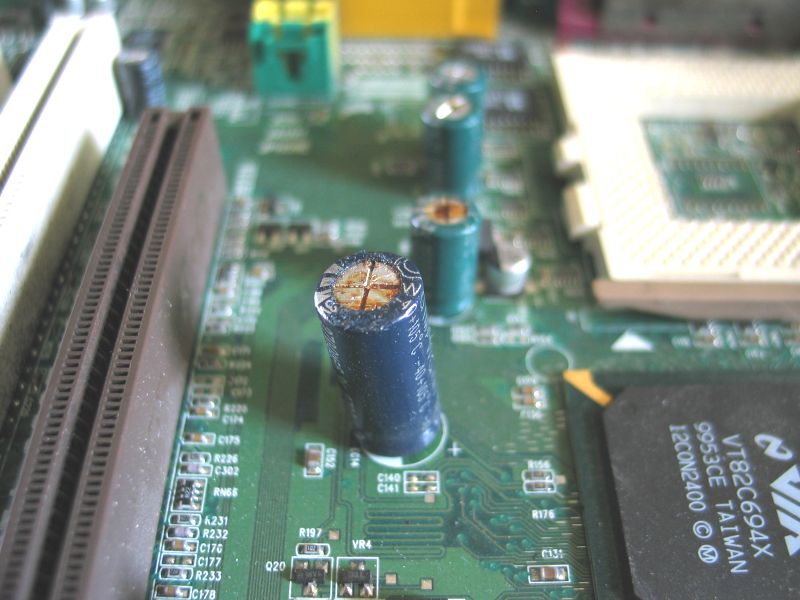

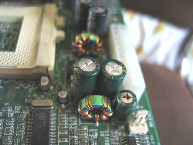

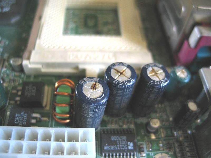

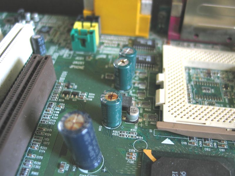

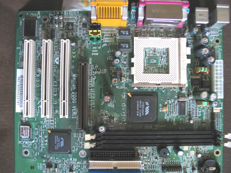

    Got a "Medion 2000" labelled board, looks like MS-6318 (that's on the bar code sticker). (also testing "new" camera)

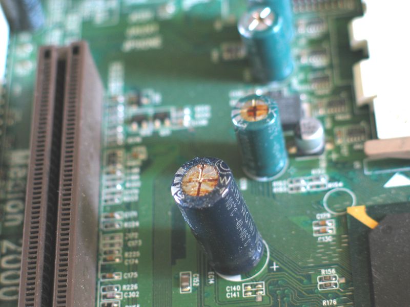

    It's full of bad leaking Chhsi caps:
    One interesting thing about these caps - they are only very slightly bulged, if at all.
    The mosfets are visibly OK but multimeter shows that they're shorted. Hopefully at least the VRM controller is good.

      Removed 2700uF and 1500uF caps.
      All 2700uF show ESR around 10ohms.
      And both 1500uF show infinity and 0.2uF capacitance - completely open...

          Both FETs (CEB703AL) were shorted, replaced with CEB6030L.
          Replaced 2700uF caps with 2200uF KOME, 1500uF with 1500uF Panasonic, 1000uF with 1000uF KOME. There was also one 100uF and one 470uF - replaced both with 1000uF.
          ESR tested all the SMD electrolytic caps - and found two of them bad (10uF/16V) - one completely open, one with higher ESR - so replaced them too.
          The battery was also missing and the clear CMOS jumer too - it wouldn't power up without that.
          And it works It's Coppermine-only, no Mendocino (tried that first before reading manual).
