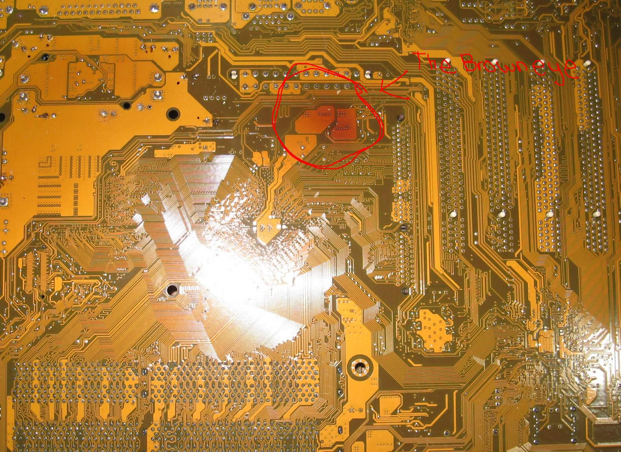

        Well the computer is back up and running, i put in a used board after butchering the other one with a low watt soldering gun. I'm sure it was fried anyway but this mark was before i even started to recap it. I thought 30 watts would be good enough but apparently not from that weller from radioscrap..
        So this was what i was talking about the brown spot on the back of the board which just didn't look right at all. Also like I mentioned my brother had the same board and the exact same symptoms then dead.
        At least now with the new cpu cooler it's at 37 C instead of almost 70. I have some questions about speedfan though but i'll ask in general computer.
        I circled the brown part and it wasn't dirt and was cleaned before that. Knew it wasn't the PSU or bad ram and works fine now cept for readings from speedfan which show temps 105 c from power....power what? and 105 from AUX...again auxilliary what? All other readings show cooler than normal.

          Whatever is on the other side of the board was getting hot.

            Something next to the ATX connector - some mosfets possibly?
            More pictures of butchery! It may still be savable.

              Re: Symptoms of an Asus
              went hunting for a pic of the other side on google.. guess what..
              http://www.pcbonto.hu/portal/static/...6083_orig2.jpg
              toasty :O
                They might be OK... I've had some P5L-VM 1934 with blown KZG and a hot mosfet for/in the circuit of the SATA controller. They work OK after a re-cap, but disk access is a bit slow, might explain why. When the cap fails, SATA disk access is gone completely.
