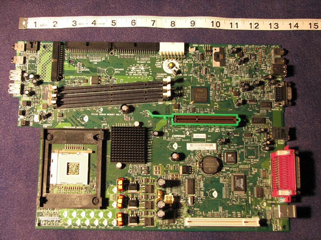

    1. Video is 16 MB 4X AGP, LOW PROFILE. Right now, Win Seven is using the basic VGA driver and gives 1024x768 (maybe could go higher) at 32-bit color. It is going to suck. Any AGP low-profile from eBay will suck almost as much. I've got a PCI Radeon 9200SE that was decent the last time I used it, but....
    2. Looks like Windows Seven was installed July 14, 2009. There are no documents or pictures on it, maybe it was lightly used since Seven was installed. The Windows license is something like "5 digits - OEM - 7 digits - 6 digits". Not sure of the age of the hard drive, but I could just set it aside, frankly.
    3. I still don't know what OS I want, but if I ever match this machine up with a 16x9 monitor, linux could do it nicely, Win98 or 2000 probably could not. It will be a learning experience mostly (first, learn soldering, then learn about networking).
    4. The reason it was trashed may be failure of the mobo's Ethernet chip/port (but the mobo caps would have killed the board at some point). I'll need a PCI ethernet card, and it might as well be wireless. No shortage of those in my basement!
    Important questions:
    1. There are 4 unused places for capacitors near the CPU. They are clearly in parallel with the other 10 (which I am removing). Should I put 14 back in, or only 10? If I upgraded the CPU to the maximum 2.2 GHz ($15 on FleaBay), would your answer change?
    2. Can I do this with my Dad's 25W Weller pencil-iron? Removal is going painfully slow. Would cleaning holes and inserting new caps be impossible? Should I grab the Weller WLC100 (with narrower tip, sold separately)? (I'm not looking to spend 2-3x as much for the fine soldering stations that you would use, just to do one project).
    Thanks in advance!

      I'll take it in reverse order as you listed the most important things at the bottom...
      Nope, a 25W iron won't cut it. It doesn't have to be expensive, it has to be more powerful. 60W should do nicely.
      There should be no harm in installing all 14 caps.
      Both 98 and 2k work fine with a 16:9 monitor. That computer however is from the XP age already, 98 will not like it very much. Win2k is a lot of work to get it up to speed. I'd just put XP on it and call it a day, or go the open-source route.
      A working TV? How boring!

        Hondaman - post pics of the mobo in this computer. It sounds like one of the Evo's I've recapped in the past 2 years. The original Nichicons had bad (too much) electrolyte and coupled with the heat in the SFF case will need a recap.
        A 25 watt iron simply doesn't have enough mass to recover from heat loss. The mobos are 4-layer (minimum) and have copper planes on the top and bottom. The copper planes will suck the heat out of a small (<50 watt) iron. I have an 800* tip on a .25" chisel tip, add 60/40 solder to that **** RoHS solder and have still problems with some Dell boards.

          I should get the Aoyue 937 station in a few days (45W digital variable). I hope it will have enough power. I think I got the 1.2mm and 2.4mm tips. Should I get others?
          Below is a picture of the board. (EDIT: heatskink, CPU and capacitors removed). The cutout (lower left) is where a vertical 60mm fan blows air into the front of the case and across the CPU heatsink. Paperboard glued to the heatsink then directs air onto three chokes and the bridge chip heat sink. The PSU sits above the mobo (yes, it is a slim "pizza box" desktop case). An 80mm fan blows air into the PSU (diagonally above the other bridge chip, near memory and AGP slot).
          Capacitors between the CPU and the edge of the board (side of the case) are in a "no wind" area. Plus they were made during Nichicon's "problem time" of 2001-2002, a primary reason why this website exists.
          Yes, it looks like memory, a faster CPU and add-in cards are still cheap and available. But first I need to solder successfully.

                Soldering was successful -- put 12 caps in (1 lost, 1 ruined - slight burn mark on plastic coating from touching the hot iron). Booted up, installed Mandriva.
                Next week I'll try to start learning about networking and file servers and all that.
