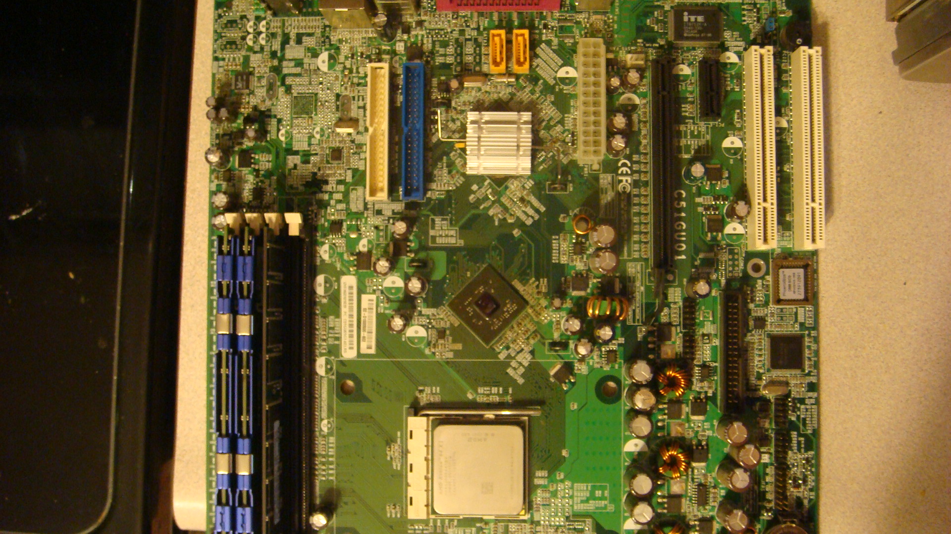

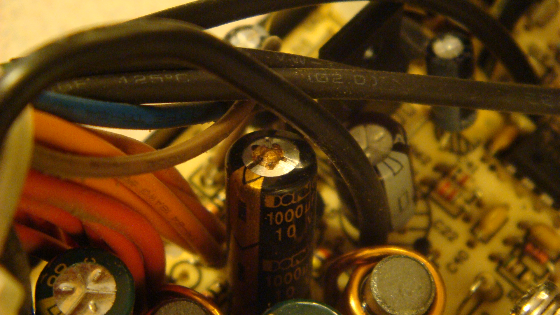

Here are the pics the last one is my thermaltake power supply. I need recommendations on which ones to replace, with what type should i replace with and should i replace any of the ones that are not bad. Basically if you were doing it which ones would you replace. Thanks guysComment
Re: Gateway gt 5034 (51GU01 Motherboard)
Open a separate thread for the PSU least things get too confusing.
PSU's have a little bit of a different approach anyway...
Basic idea [assuming you don't have an ESR meter, not everyone does this enough to justify owning one] is to replace anything known to cause problems -and- anything that has bloated. Bloated caps are sometimes heat or bad PSU issues or bad application issues rather than poor quality cap issues.
I see bloaters on both the mobo and PSU so there's a good chance a recap will fix things right up.

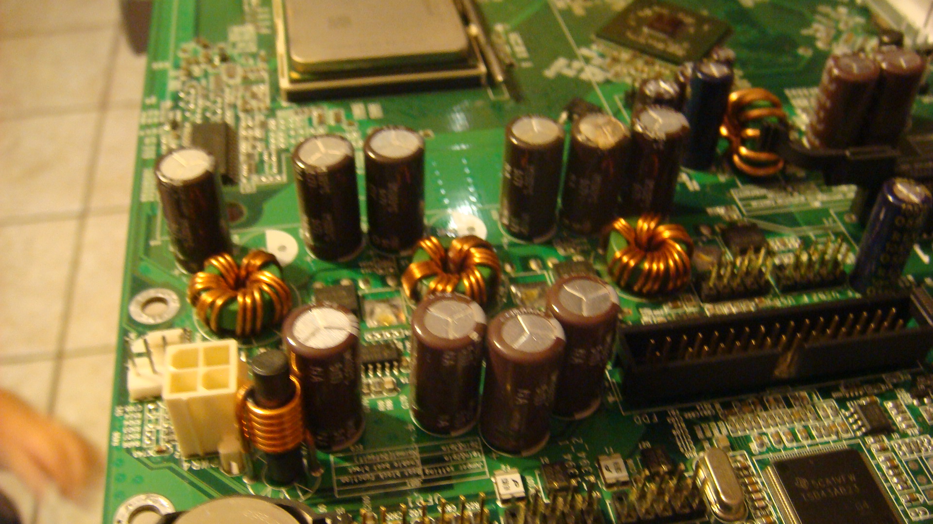

Okay...
Usually you can ignore the 4 & 5 mm diameter caps.
If none are bloated then don't worry about them unless you have odd problems later after the other caps are replaced.
These are usually only a problem if they are 85C rated caps and even then it's not that common.
[Same goes for 6mm if they are less than 220uF.]
Replace all of any kind [brand/series] that has one bloated cap.
If one was pushed over the top then the others probably aren't far behind.
Chemicon KZG and KZJ have very high failure rates and don't always bloat.
Best to just replace them.
Nichicon HN and HM with date codes for 2001-thru-2004 had a manufacturing error.
Chinese and Taiwanese brands are all suspect. No consistently good brand is known.
Now make your map and a list of what needs replaced.
List: Brand/Series/uF/Volts/Diameter [as a starting point]
From that their ESR and Ripple specs can be looked up in data sheets to make a list of suitable replacements.
- ESR should be the same or less.
- Ripple should be the same or more.
- uF should be the same. If you have to fudge that then go up one value. [Which is ~20%]. [uF goes down as cap's age.]
- Volts should be the same or more unless you know the actual circuit voltage.
[As long as cap's rated voltage is higher than circuit voltage you are good.]
[ON MOTHERBOARDS: 6.3v and 10v caps are interchangeable as the voltages present are 12v [which would not us a 6.3v or 10v cap anyway] or 5v or less [which can use either 6.3v or 10v].]
- And the diameter generally needs to be the same so they physically fit. This you can fudge if there is enough space.

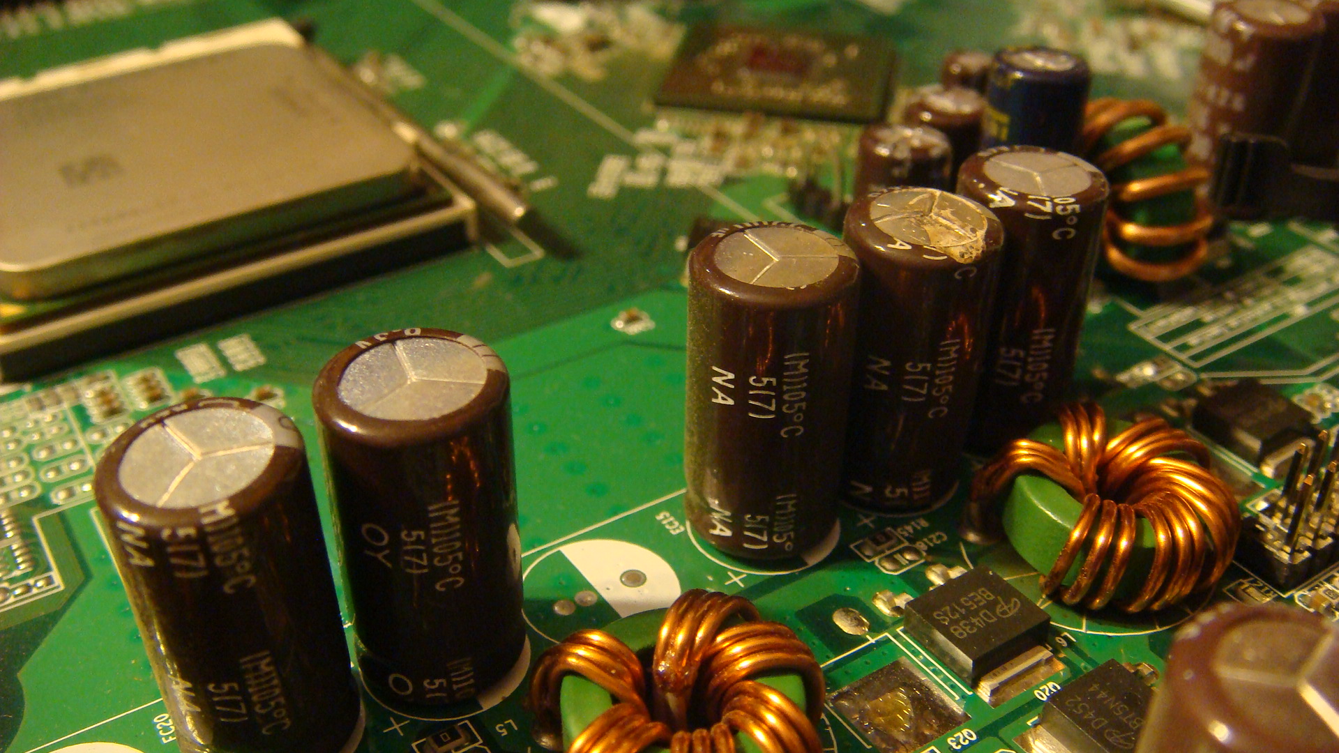

Ok Here is what I got,
6-6.3v 2200uf KZG 10mm Teapo.....1 bad
6-16v 1500uf KZG 10mm Teapo......0 bad
8-6.3v 1000uf SEK 8mm Teapo.......2 bad
6-16v 470uf SEK 8mm Teapo..........0 bad
Thinking maybe just replace all of them since same brand. Would that be correct or is my thinking flawed? And what should i replace with, brand wise. ThanksComment
Where are you located? [country]
- helps in suggesting parts sources.
- and that affects what is available as replacements.
Beware of eBay caps.
Probably 90+% of the low ESR caps there are counterfeits and eBay does nothing.
If you want to go there ask us about what you are looking at.
KZG are not Teapo, they are Chemicon.
The mark that looks like a shield is the Chemicon logo.
Always use 105C temp rated caps.
Want ESR the same or less.
Want Ripple the same or more.
On motherboards 6.3v and 10v are interchangeable [both are on 5v or less actual voltage] but that isn't always true on other equipment.
Don't lower the caps voltage rating unless you know what the actual voltage is.
Always use caps rated the same or more than the actual circuit voltage.
Ideally don't change uF.
If you MUST change uF then go up one standard value [usually ~20%]
That's because uF goes down as caps age.

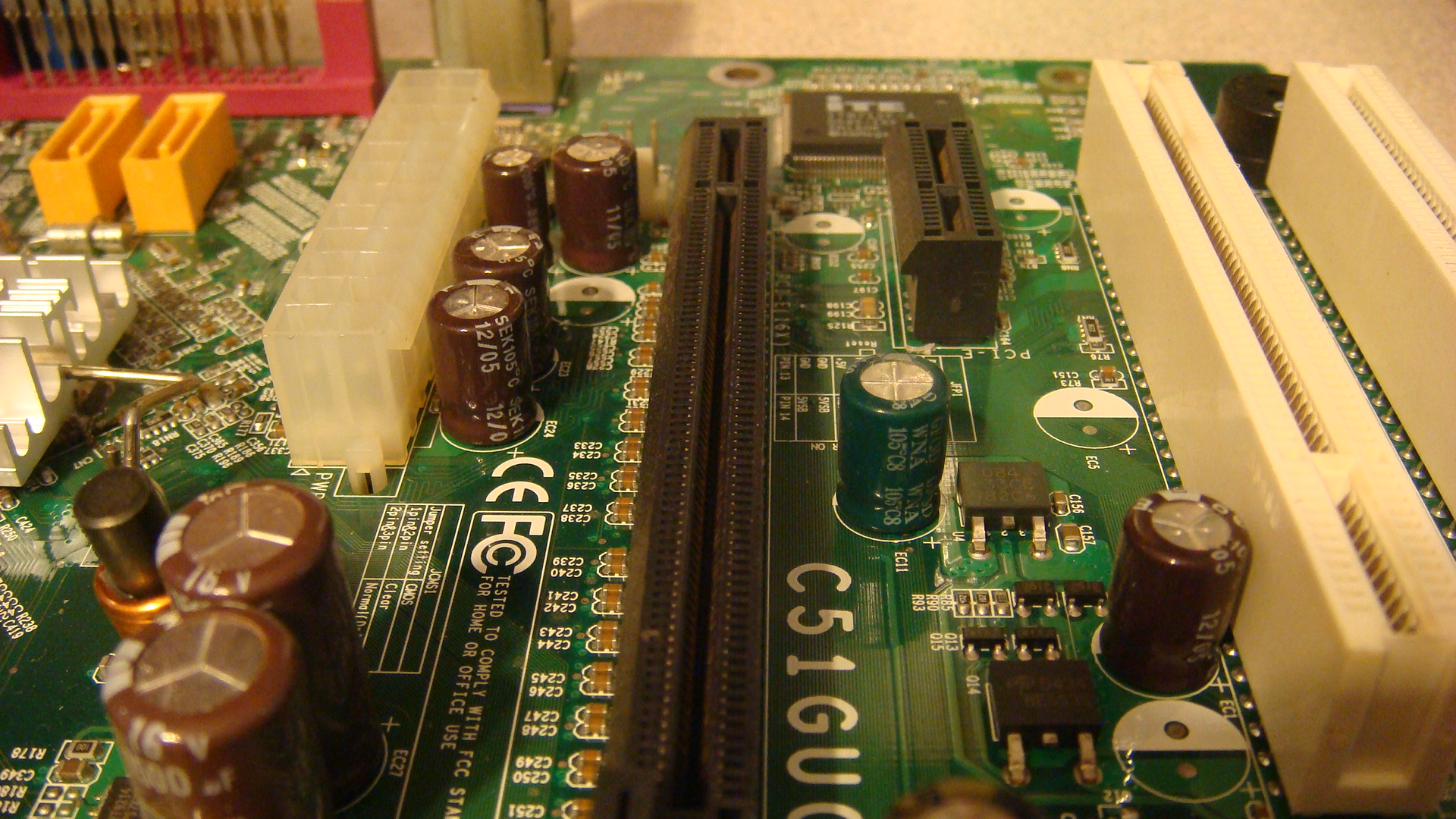

All those you listed should be replaced but I think you missed some.
- The blue and green ones I can't see well enough in the photo.
The blue look like maybe OST which are notoriously problematic.
The Green one, I can see WNA but that's not ringing a bell right now.
6.3v 2200uf KZG 10x20mm ..... Ripple: 2550 mA ... ESR: 0.013 ohms
16v 1500uf KZG 10x20mm ..... Ripple: 2550 mA ... ESR: 0.013 ohms
Typical equivalent replacements are
Rubycon MBZ, Nichicon HM, Sanyo/Suncon WG, Samxon GD, Panisonic FJ
Some 'one grade up' replacements are
Rubycon MCZ, Nichicon HN, Samxon GC
SEK are not even low ESR but those caps 'should be' low ESR
6.3v 1000uf SEK 8x11.5mm ..... Ripple: 370 mA ... ESR: n/a
16v 470uf SEK 8x11mm ..... Ripple: 310 mA ... ESR: n/a
16v 470uf SEK 8x15mm ..... Ripple: 360 mA ... ESR: n/a
Any 'entry level' or better low ESR caps with better Ripple than those should be fine.

I stand corrected on the chemicon. I did not see a name they are same color as the teapos so i assumed the later. Yes there are 3 ost RLX 6.3 1500uf caps. Not Bloated so assumed good. Will replace if necessary. The WNA is a Samxon 6.3v 1000uf. Im Located in Indiana. Was probably gonna buy of this site or the other one you guys recommend on here. Cannot recall the name at the moment.Comment
OST often fail without bloating so it's recommended to replace them to avoid 'invisible' bad caps on the board.
[That's any series of OST, not just RLX.]
6.3v 1500uf RLX 8x20mm ..... Ripple: 1650 mA ... ESR: 0.021 ohms
Grade is slightly less than KZG but not 'less enough' for the next lower grade of good caps to be good choices.
So, use the same list as given for KZG.
I'm not familiar with that series of Samxon but I haven't heard anything bad, it's not bloated, and except for a couple of old [and I think now defunct] series Samxon seem to be good caps so you can probably leave that one.

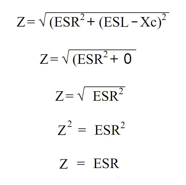

Bear in mind that a lot of formulas you'll find for filters use Xc [Capacitive Reactance] when they should use total Impedance [Z]. That's because they teach filters in schools at RF frequencies where ESR and ESL are nill so they disregard them and assume Z = Xc for a cap. Unfortunately often that's all they remember after school.
- At 100 kHz it's different than at RF.
At around 100 kHz the Xc and ESL cancel each other out such that Z = ESR.
[The formula is attached because I dunno how to do the square-root symbol needed.]
So, when you do the 'filter math' for 100 kHz [the typical Ripple frequency from an SMPS] you should be using ESR [which = Z] instead of Xc.
Notes on the equation.
The (ESL - Xc) is always zero or a positive value. Thus (Xc - ESL) is the same thing.
Might see it written either way.
ESL is sometimes called [written as] XL in the equation but in the case of a cap it's an 'Equivalent' Series Inductance like ESR is an 'Equivalent' Series Resistance so ESL is the proper term.
That equation is also why some data sheets say Impedance or 'Z' instead of ESR.
Since it is given at 100kHz the Z = ESR.
