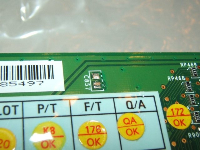

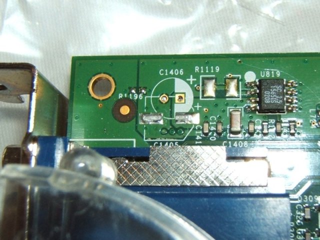

    MSI GF4Ti VGA, what cap is this?
    MSI VGA card "G4Ti4400-VTD", also known as "MS-8871 V1.0", "lost" two of its capacitors.
    Pictures 1 and 2: SMD C857 is gone ... :-/ Any ideas except finding out the case size of the former device and then playing trial and error with new ones?

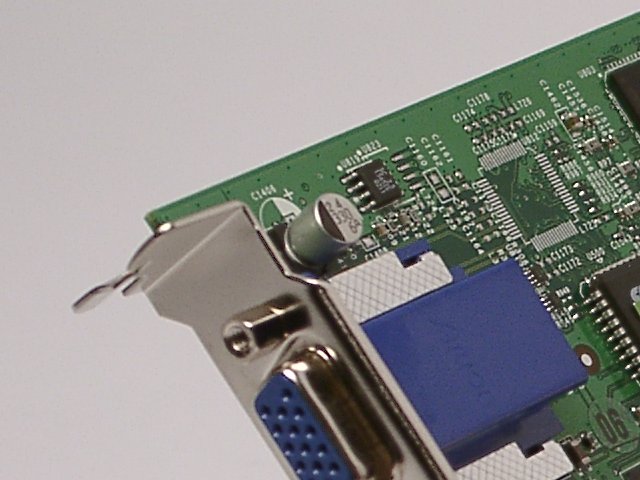

    Picture 3: C1405 is missing. It was a poly or lytic SMD. The board layout allows to use a standard through-hole cap C1406 instead.

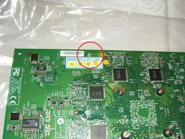

    Picture 4: Picture of C1405 on an almost identical "G4Ti4600-VTD" - what cap and manufacturer is this?

    Re: MSI GF4Ti VGA, what cap is this?
    Ha, found out myself! I think.
    Thanks to http://capacitor.web.fc2.com/solidcapacitor.html picture #4 seems to be a
    SUNCON EP-cap
    HVA series
    330uF / ESR 0,016 Ohm / 3150mA ripple
    Datasheet:
    This also means a Panasonic FM I have laying around here will probably not do the job, not even as an intermediate solution:
    330uF / ESR 0,130 Ohm / 455mA ripple
