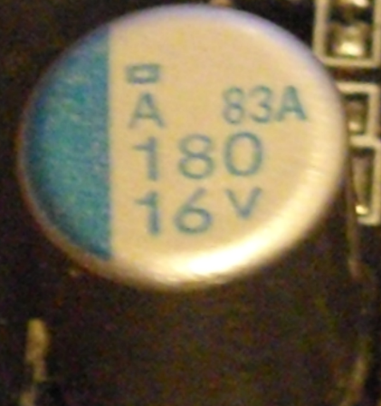

What cap is this and where can I purchase it?
  • Willnet
    • Nov 2010
    • 7
    It is a cap off of a video card. Thanks.
  • PCBONEZ
    Grumpy Old Fart
    • Aug 2005
    • 10661
    Re: What cap is this and where can I purchase it?
    Chemicon PSA 180uF 16v.
    ESR is like .025 Ohms. - Not that impressive for a poly.
    They don't go bad.
    EDIT: Whoops, it's not even in the data sheet.
    But it's a Chemicon PSA 180uF 16v Polymer.
        Are these SMD?
        That could be why I'm not finding any.
        If they are they would be PXA rather than PSA.
        - If they are then need to know diameter because there are two 180uF 16v in that series. [8mm and 10mm]
                      If they are 10mm these:
                      http://www.mouser.com/ProductDetail/...x6BYFFjzEW0%3d
                      If they are 8mm these:
                      http://search.digikey.com/scripts/Dk...=565-3078-1-ND

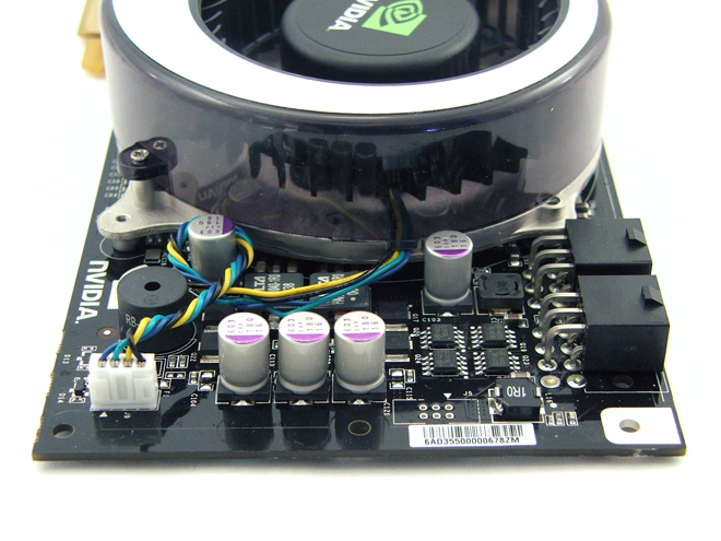

                        Originally posted by PCBONEZ
                        The ones I need are much taller, like 14mm. I searched around but no one seems to sell them. The chemicon website's search thing doesn't seem to be working. I remeasured the diameter and it is 8mm. This is how they look from the side:
                        Can I just use a similar cap, like the 8mm you linked?
                        • yyonline
                          • Jul 2009
                          • 692
                          Those are 8mm diameter x 12mm height caps. I can tell based on their height compared to the PCI express power connector. The next standard size up would be 8x15mm. These would appear much taller and it would be a very odd size for a polymer capacitor.
                          The ones in the second photo are Sanyo SVP, which has slightly inferior specs to UCC PXA. I'm assuming your card has PXA as that is what is in the first photo.
                          PCBONEZ provided a link to the correct 8x12mm replacement:
