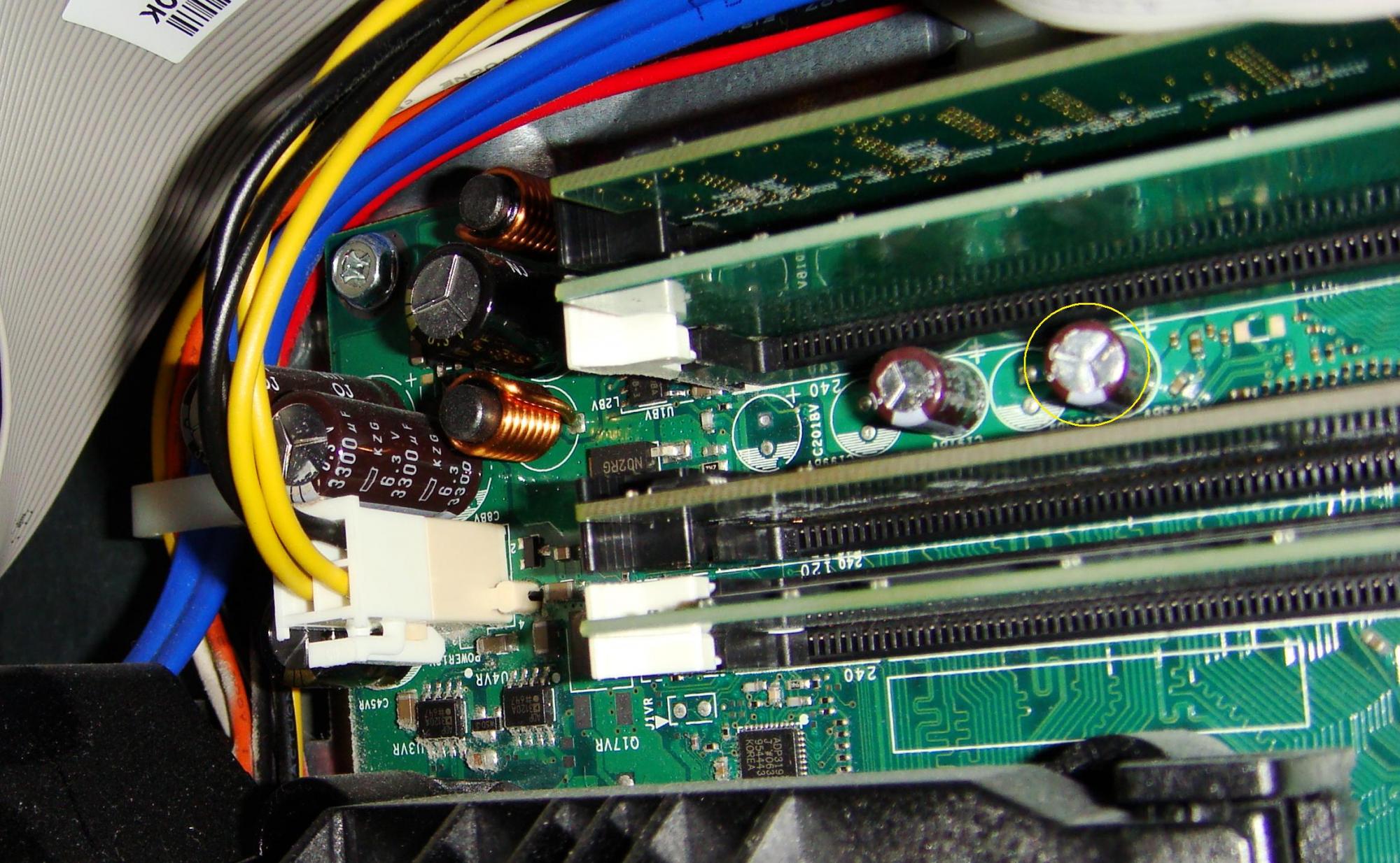

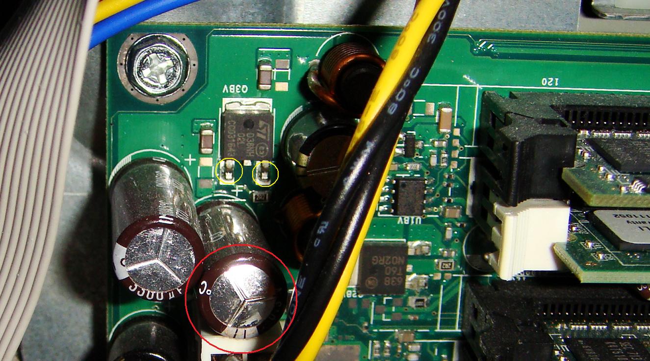

      Yikes!!! Running on borrowed time. Could it be some components on the board or perhaps the processor and the northbridge & southbridge themselves have already been compromised? If so, there's no point of fixing something that is already bound to fail sometime in the not-so-distant future. I ran the Dell 32-bit Diagnostics software comprehensive test and the board passed with flying colors. Is this a promising sign of a not-so-serious case?
      Here are some pictures.
      The ones marked red are bad caps.
      Just let me know if you need more pics.

        Re: 2007 Dell XPS 410/9200 with Bad Caps
        Oh look KZG - you need to replace ALL of those.
        If it's running now, it's fine. It's when it stops running that you have to figure out if it's just bad caps and/or a shorted component.
        Stop using it now, buy caps, replace caps, happy salamander.

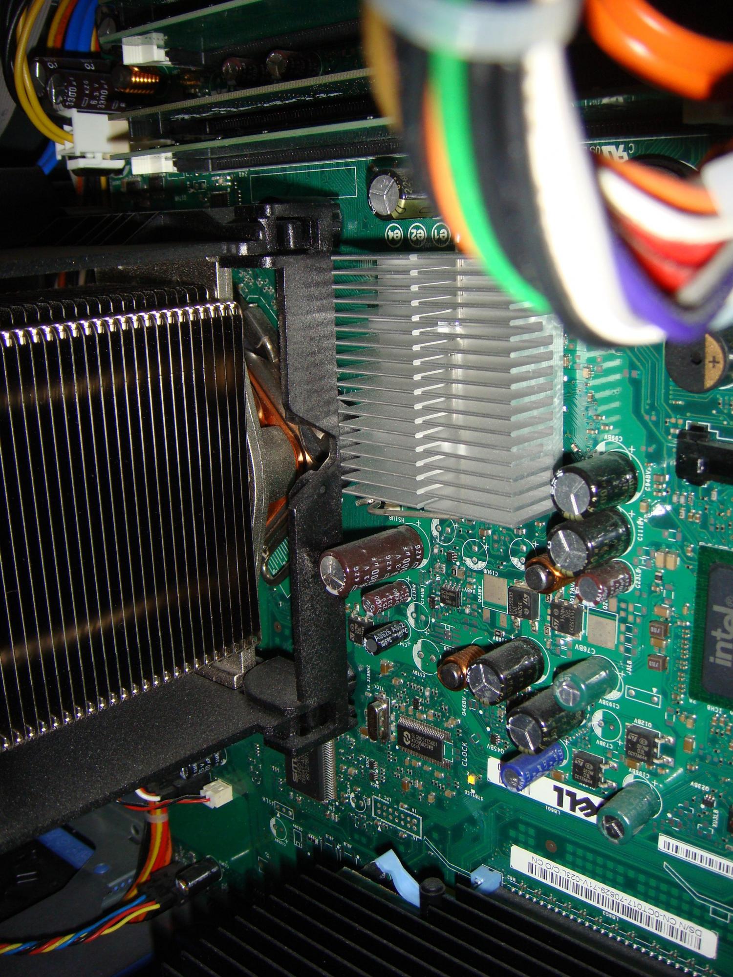

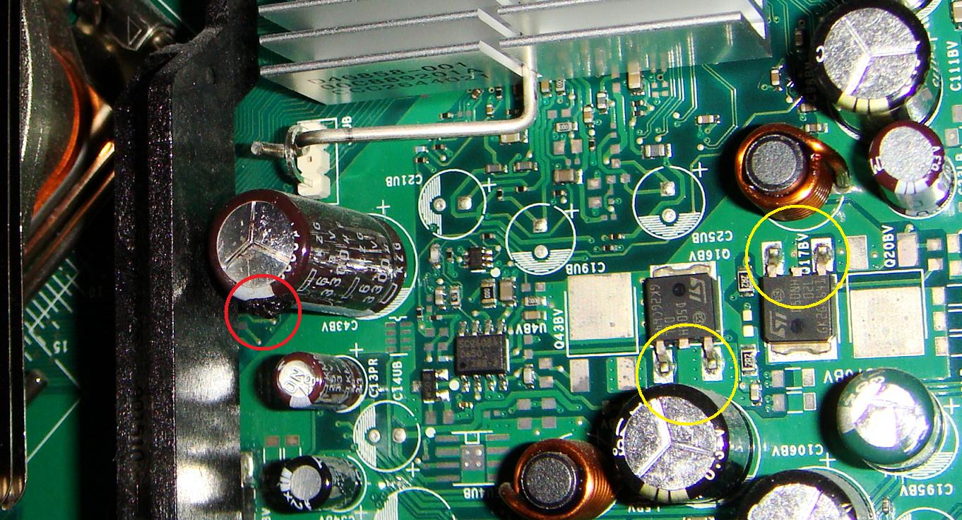

          More pics of the innards of my Dell motherboard.
          In P3, the one circled in blue at bottom center, is that a polymer cap? Can I go for all polys? In P5, the one circled in yellow, is that about to erupt?
            KZG and KZJ are bad, other caps by United Chemi-Con are fine.
            P3 - yes it's a polymer.
            What does that small cap say? I suspect KMG or KY.
