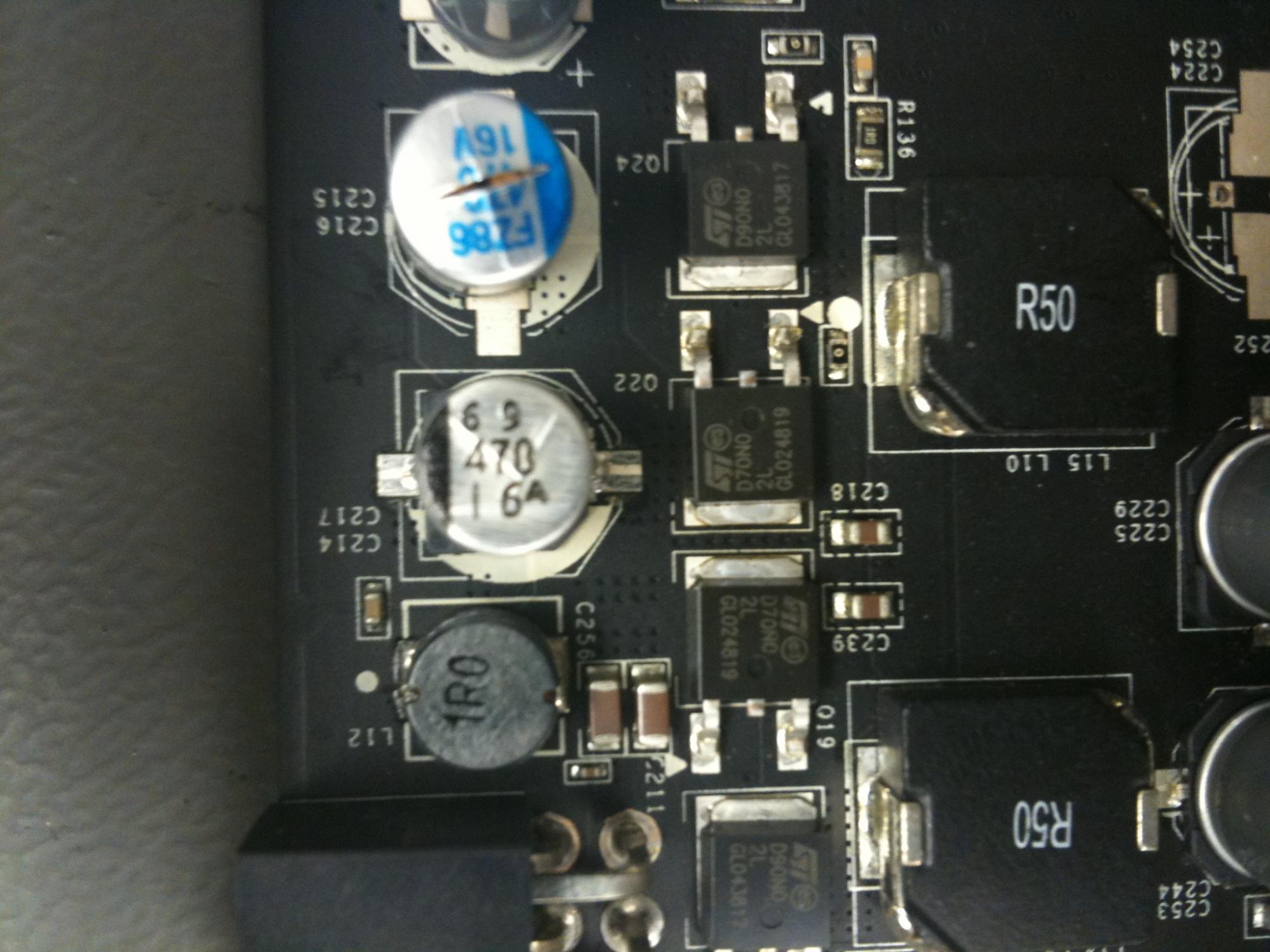

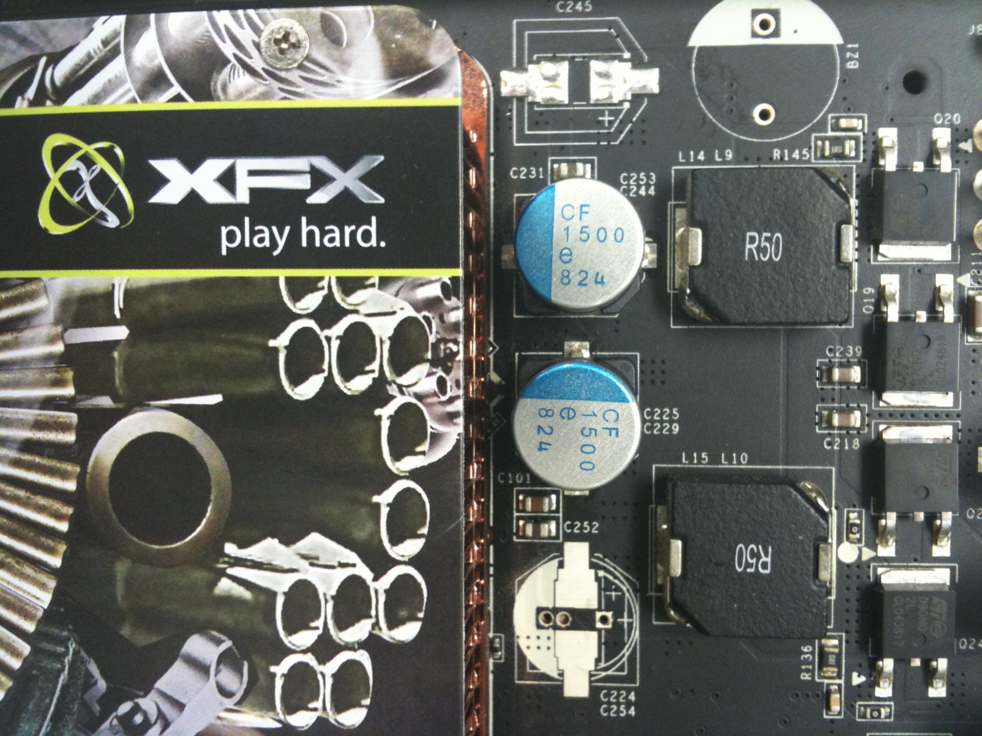

    Hello, not sure if this is the right forum but here goes,
    I currently have a xfx 9800 with bad caps, There are the fz ones which will be replacing, but these other ones looks like theyre on their way out. slightly bulged on top, cant see it, although they can be alright.
    one says 69 / 470 / 16A
    the other one is CF / 1500 / e / 824
    any help appreciated.
    thanks

    Here's the first one.

      Re: Help Identify these caps
      The other one is Suncon/Sanyo.
        The CF are polymer and should be reliable.
        The Suncon caps have very deep cuts for the vents, but the one you have in the photo doesn't look bulged to me. I'd say the slight raising you see on the cuts is normal for them. The grooves on most caps go "down" into the cap. The grooves on these surface mount Suncons always seems to go "up" from the cap, almost if it were scored from the inside.
            The ones in the second picture are Nichicon solids.
              Seems I got the photos backwards playing with the cycle photo thing.
              The blue marked with 4 lines are Nichicon Poly.
              The black marked with 3 lines are Sanyo / Suncon Lytics.
              [There is a key to the markings in the data sheet.]
              They are both good caps..........
              No need to change.
                OK, thanks a lot guys, I think ill leave those 3 alone.
                I will be replacing the FZ ones with some Panasonic equivalent ones.
