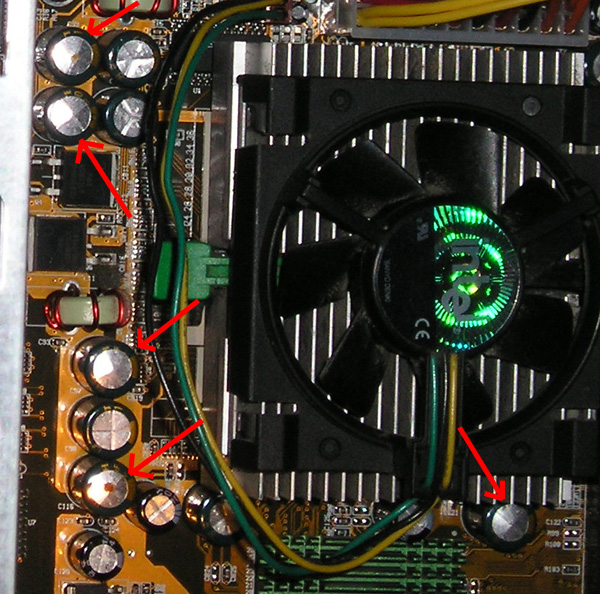

    Hi, this is my 1st post here. As I can see you`re all aware of the cap brand giving me trouble...Tayeh, but I figured I`d post anyway for more evidence. My computer has been giving me problems for the last year now. Started off once in awhile, then got progressively worse. Basically, restarting, failure to POST, etc. After trying everything else, someone suggested I check the caps. Sure enough, 5 of them are bulging (2 out of 5 leaking from the top)!
    After doing some net searches, I found tons of info, and came across this site. I had no idea this problem was so huge, but I feel better to finally have an idea of why my system is so unstable. I`m a bit of a newbie, but anything I can do to help the cause...
    The caps are: Tayeh 1500uF 6.3v.
    The motherboard is a: Jetway J694AS
    I took a pic but you can`t see the brand, only the bulging. I`ll post another once I remove the motherboard and can get a better shot of the caps.

    that looks like a tualatin. are you planning to recap the board yourself?
    • skinnybonesjones
      • Dec 2005
      • 28
      To tell you the truth, I`m not sure . It`s a Pentium III, and I was thinking it`s a Coppermine cause it`s 1GHz, but I`m not sure. I bought this system off my friend`s teacher a couple years ago, and he was the one who put it together. I`ve never removed the heatsink, either. As of about 1 year ago, I didn`t know a thing about computers (just use it for making music!), but this one`s been acting so mysteriously, that I`ve taken an interest, and have been learning everything I can on the net.
      Anyway, to answer your question, I`d like to recap this board myself. But the thing is, I don`t have a soldering station/solder sucker. I`d have to buy the equipment before I can get started. I took an electronics class a few years back, and we did a lot of soldering, but I still could use a little practice before I work on the mobo.
      My wife said her dad might have some equipment, but if he doesn`t, I`m thinking it may just be cheaper to pick up a used mobo out here, rather than buying a soldering station. I need a socket 370 board, with 168-pin DIMM`s for SDRAM PC133 capable of over 1GB of RAM (I`ve got 2 brandnew 512MB sticks of Crucial memory for this board which I`d hate to go to waste). The thing is, a lot of the socket 370 boards I`ve seen on the net only take a max of 512MB of RAM. So it depends on what I can find out here, and as my Japanese isn`t perfect(I`m learning!) it might be rough shopping for parts!
      I`m going into Akihabara (aka Electric Town) in Tokyo tomorrow. There are tons of electronics places there, so I`m gonna check for everything, and compare prices. I`d also like to check out capacitors, but I`ve got a few questions on what to look for:
      I`ve heard you can replace 1500uF with 2200uF caps. My question is, is it preferable to do so?
      Also, I`ve heard you can go up in voltage, but not down. But is going up in voltage preferable? Or it just doesn`t make a difference.
      On this site, I saw some good cap brand names recomended like Rubycon, Sanyo, Nichicon, and Panasonic, but I`ve also heard I should get low ESR caps. Is there a visible way to identify if a cap is low ESR?
      Anything else you can think of to look for would be really helpful.

        oh wow. you're a foreigner in Japan....what a trip! what is your nationality and how long have you been there. can you take a few pics of electric town tomorrow we would love to see.
        socket 370 and more than 512 ram......i would have said pick up a used asus cusl2 or tusl2 (if tualatin) but yeh they are limited to 512. the caps are not too bad, the majors are usually rubycon/nichicon the rest ost. maybe via chipsets would support higher.
        I`ve heard you can replace 1500uF with 2200uF caps. Also, I`ve heard you can go up in voltage, but not down.
        yeh you can go up in voltage and capacitance no probs. if you want to preserve the original design then stick to the same or just go up to the next value if you cant find. dont go down though unless you know what you are doing.

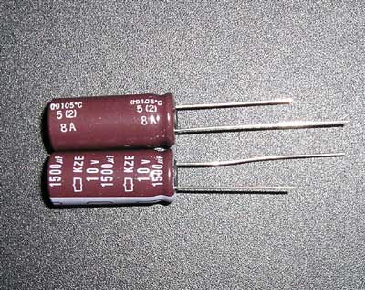

                      Back from Akiba
                      Searched all over Akihabara today, and couldn`t find a suitable used motherboard. I decided to give replacing the caps a go. I picked up a soldering iron for about $17.50, it`s a Hakko Dash(No.N453P). Supposedly, it heats up to about 430 C. I couldn`t afford the temperature adjustable solder stations.
                      I got some 0.6mm solder (too thin?). I couldn`t find any labels for 60/40, everything here was labeled by %. The one I got is 60% Sn, that`s tin right? Is this kind ok for soldering a mobo? It was really cheap, so if you recommend something different, I can pick that up.
                      Thanks for the advice on the low-ESR cap letter codes. It really helped me out when looking. I picked up 10 KZE 1500uF 10v caps to replace all the 1500uF 6.3v Tayeh ones on my board. I attached a picture. Let me know if they look legit.
                      Also found a junked soundcard to practice removing caps before doing the real deal.
                      Forgot to pick up the dentist pick. I was suprised that they were actually selling them there! About 500yen which is about $4.20. You can pretty much find anything, but looking for a Socket 370 SDRAM mobo is rough (guess they`re too old).
                      I read the Recapping FAQ thread, which is really in-depth, and pretty much answered all my questions. Basically, my only questions now are, when you stick the pick/needle through to clean the hole, do you hold the needle through the hole while waiting for the solder to cool, then wiggle it till the solder breaks off the pick, before pulling the pick out of the hole? My other question is: is the 0.6mm 60% Sn solder I got ok for the job? Thanks again for all your help, and I posted the Electric Town pics in the Lounge!

                        Whoops, I`m trippin.
                        I forgot to post a pic of the caps I got. Look ok?

                              Big Pope uses a hakko corded iron and did not mention any probs. his is a 40w though and yours is 25W. see how you go anyway.
                              it is definitely recommended to replace the 1000uF 10v. 470uF 16v is optional, generally if i see those or 300uf 25v i would recap them. so would a few others here. nothing smaller than that though.
                              here is the pick technique from TC. you should work with the pick and iron at the rear of the board. (as opposed to the faq which i havent changed yet)
                              You need to reheat the hole until the solder is melted, then insert the needle pick into the hole as far as it will fit without forcing it, going all the way through, immerging from the other side... Remove the iron and let the solder harden. Since the pick is stainless steel, the solder will not adhere to it. GENTLY spin and wiggle the pick around until it breaks loose, then remove it from the hole. Use your Exact-o knife and gently scrape the dry solder from the hole. And WALLA!! You will have a clean open hole, ready to place a NEW capacitor in!!
                              i use 0.8mm solder. i dont see the problem with 0.6mm, should be fine if not better. looks like you got lead free solder?

                                Thanks for the help! I went back today, and picked up some 1000uF 10v caps as well. Same KZE variety. I got a card from the guy there, and they`ve got a website. It`s totally in Japanese, but there are a lot of pics if you`re curious to check it out:
                                http://www.san-ei-denpa.com/
                                I also got a stainless steel pick and an ESD wriststrap, and I`m gonna practice some more on this junk soundcard till I`m more comfortable with the technique (always used a mechanical soldersucker before, but from what I`ve read in here it`s not a good idea on a mobo). The iron I got is hot enough for the soundcard, but we`ll see how it works on the mobo. I`m a little nervous to remove the CPU, before removing the mobo (never done it b4). Picked up some thermal grease in case it`s all dried out under the heatsink. I`ve been learning on the net the safest way to remove it. I know it all depends on the mobo, but if you`ve got any words of caution, let me know...I`m a bit of a newbie. Thanks again!
