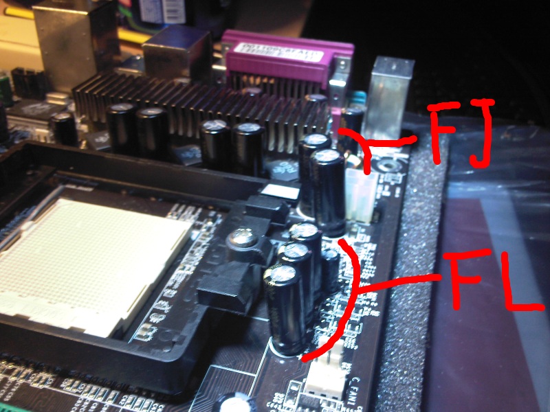

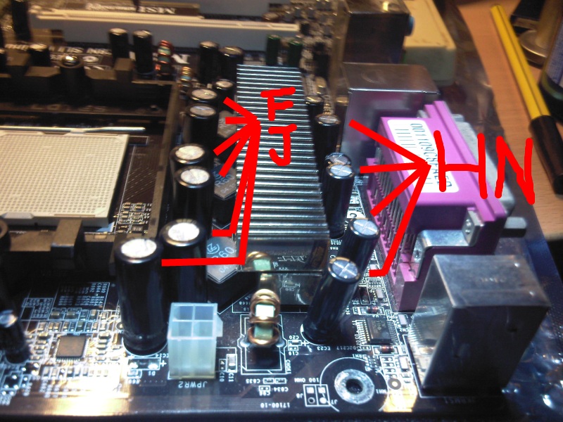

          A couple pics of the Panasonic FJs, FLs and the HNs.

            Those panny caps look fine from the pics. I wouldn't worry about them. Panny are a reliable brand.
