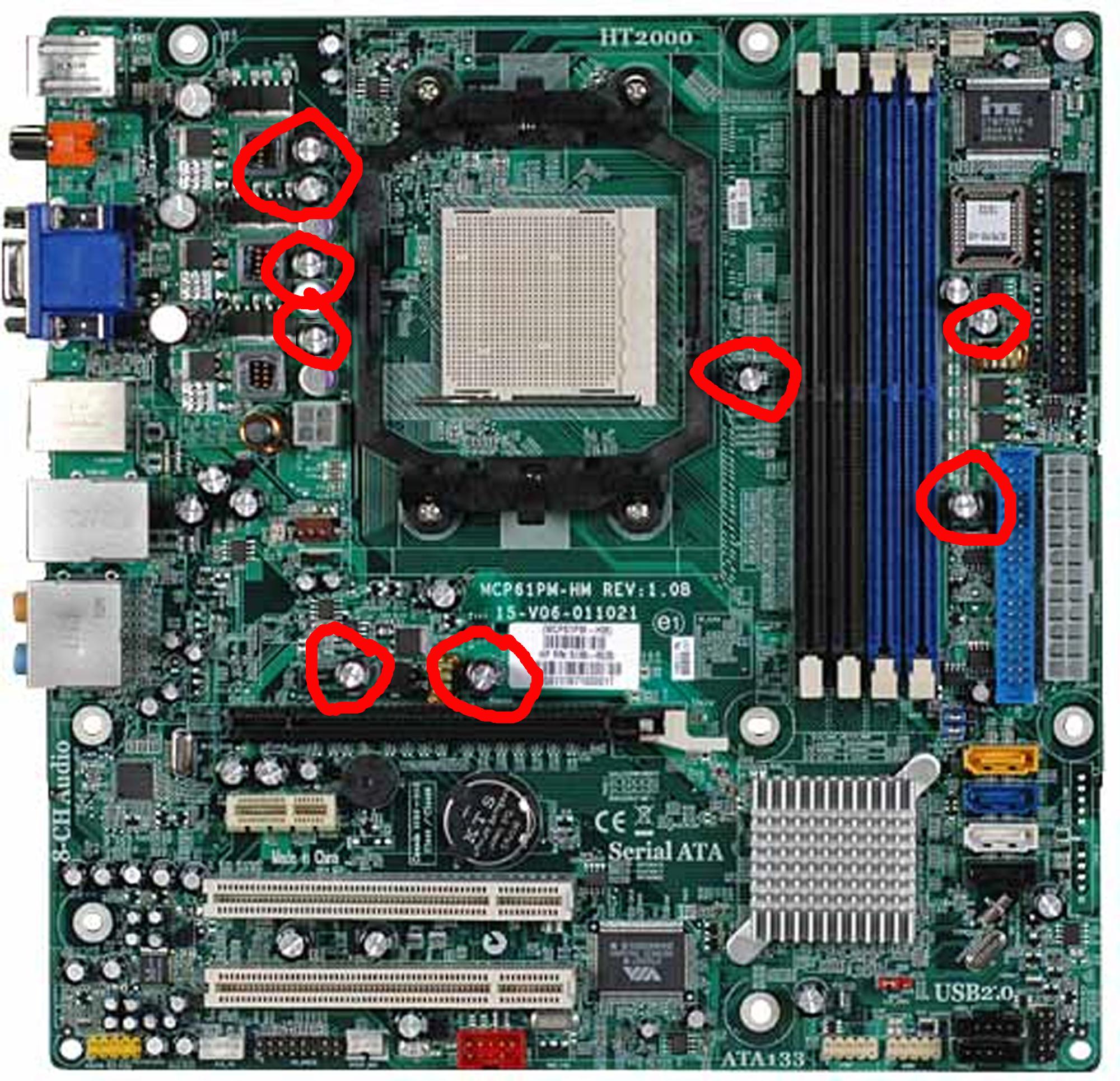

                                  Here is a picture of the motherboard with the caps circled that are bulging at the top.

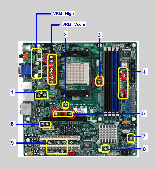

                                    Okay, I marked it up further in aid of communication.
                                    I looked at some of these boards on-line and you'll probably need to do a lot of caps.
                                    Please give me the brand name and series of each cap [or group] I have numbered.
                                    [In groups tell me all of them if they are not the same.]
                                    Once I know that I'll get more specific.
                                    - Hopefully some are good brands and can be skipped.
                                    In the VRM-Vcore you have mixed lytics and polys.
                                    What are the numbers on the existing polys?
                                    I'm going to recommend you change all the lytics to polys but I need to know what is already there to make sure you get enough total uF and low enough ESR in there.
                                    With a DMM check to see if and of #1, #2, and #3 are in parallel with the Vcore caps.
                                    [Only need to check against one Vcore cap because the Vcore caps ARE in parallel.]
                                    If they are in parallel...
                                    The + to + sides of the caps will have zero resistance.
                                    -and-
                                    The - to - sides of the caps will have zero resistance.
                                    None of #1 'probably' are but #2 or #3 very well might be.
                                    If you need help with cap ID then tell me as much as you can about the markings..

                                      Ok in groups
                                      Group:
                                      VRM-High: TK 16v 1800uf (qty: 3) 10mm x 25mm
                                      VRM-Vcore: TK 6.3v 1800uf (Qty: 4) 8mm x 20mm
                                      1: G-luxon 16v 470uf (Qty:1)
                                      OST 6.3V 1000uf (Qty: 2)
                                      2: G-luxon 16v 470uf (Qty:1)
                                      3: TK 6.3v 1800uf (Qty: 1) 8mm x 20mm
                                      4: TK 6.3v 1800uf (Qty: 2) 8mm x 20mm
                                      OST 6.3V 1000uf (Qty: 1)
                                      5: TK 6.3v 1800uf (Qty: 2) 8mm x 20mm
                                      6: G-luxon 16v 470uf (Qty:1)
                                      7: OST 6.3V 1000uf (Qty: 1)
                                      8: OST 6.3V 1000uf (Qty: 1)
                                      9: G-luxon 16v 470uf (Qty:1)
                                      The Poly's next to the Vrm-Vcore are labeled
                                      from top to bottom
                                      LF
                                      820
                                      e
                                      793
                                      • bruferrit

                                          OH MY,,, you have a Full House! - All of those should go.
                                          [You may now invent a new 4 letter word.]
                                          From looking at photos of other boards with these brands I'm assuming:
                                          - All the OST are the RLS series.
                                          - All the 6.3v TK are the ATWB series.
                                          If that is wrong then tell me.
                                          Need to know:
                                          Do you want to upgrade the VRM to poly and if so just Vcore or the whole thing?
                                          Is there a series name on the G-luxon? - It's usually a 2 letter code but they don't always mark it.
                                          Are the G-luxon all the same physical size and what size(s) are they.
                                          Are the OST all the same physical size and what size(s) are they.
                                          I need to know if #3 is in parallel with the Vcore caps.
                                          [Which would make it a Vcore cap and replacement options are different.]
                                          Sometimes they add some random Vcore caps around the CPU to keep the Vcore voltage 'flat' across the socket.
                                          I asked about sizes because those series both have more than one can size in those volt/uF combinations.
                                          The Poly's in Vcore are Nichicon LF series 820uF 2.5v
                                          The 'e' is the voltage code. The other number is a batch or date code.
                                          - You can replace the TK in Vcore with 820uF polys [2.5v or higher] which will be enough total uF [with 7x 820uF] and will lower ESR a bit more.
                                          The actual Vcore voltage is under 2.0v so 2.5v caps are fine.
                                          Can't do that with the non-Vcore TK because they will be on too high a voltage.
