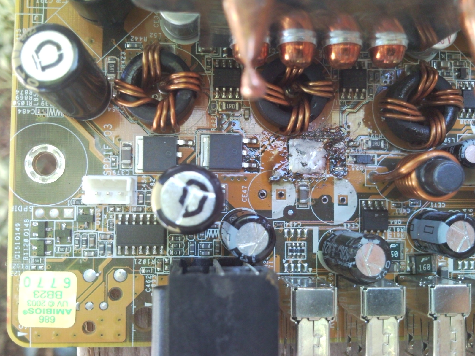

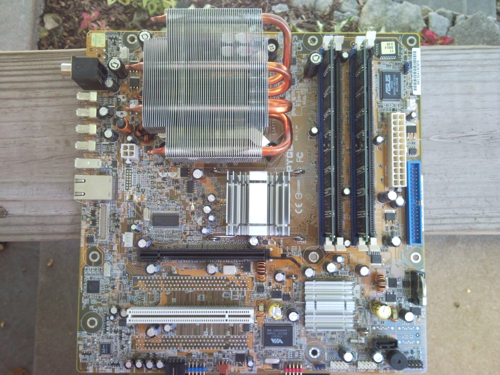

    This mb is out of an HP Media Center PC, about 5 years old, model 557z. One day it did not power on. I had replaced the power supply a couple of years ago. It is a small form factor/custom ps. This time when looking up the part it was about $150. It was for my work and they did not want to invest that much into an old computer, so I brought it home to see if I could salvage it, or at least some parts.
    I found some bad caps in the power supply, recapped, tested, looked ok. Plugged it into the mb, and saw some smoke between the usb ports and the cpu. Wasn't sure if it was from the caps or the transistors. Turned it off, then for some reason turned it back on and the ps blew the fuse and something else as I am unable to repair it.
    Then taking a closer look at the board I noticed 5 bulging caps, and one of the transistors (mosfet) where the smoke was tested bad. I replaced the caps (with Panasonic caps) and transistor (with exact replacement), found another ATX 24 pin power supply (too big to fit inside the case, but ok for testing) and it powered up perfectly. It worked for a couple of hours and then the transistor went out again.
    Here is what I need help with: the transistor is the kind that has two legs and the back soldered to the board. I only have a soldering station and don't know how to solder/unsolder these components well. Is it possible the new transistor failed because I was only able to get a little solder tacked onto the back? I also might have applied too much heat trying to get it soldered onto the board. If you look at the first pic you can see the mess I have made trying to unsolder/solder this twice. (I had not cleaned up the flux and extra solder when I took the pic.) I did test with continuity and it seems the board has not been damaged severely.
    I still have one more new transistor to try, but wanted some help before trying to attach it again. The only idea I have come up with was to clean it up good, then cover the area with ChipQuick, and place the transistor on that quickly before it hardens. But I don't know if ChipQuick will work over the long term.
    The caps that were replaced are the larger caps (two are removed in the pic) I have tested the other caps in the area with an esr meter without removing them, and they test ok, but I don't mind ordering some more and replacing them if they could be contributing to the problem.
    I have repaired a lot of LCD monitors with the help of this forum, but this is my first motherboard!

    You can't check ESR or uF on caps in a VRM without removing them.
    - They are in parallel.
    The large area on the back of those chips acts as a heat-sink as well as a connection.
    Yes full contact is important.
    I would tin the back of the chip and tin the pad with enough solder for a bond.
    Then position it and hold the heat on the tab until you feel it 'sink' into place.
    Do that before you mess with the legs....
    Good luck. Those are a pain in the as*.

        They are a pain in the ass, but a good deal easier to remove with Chip Quik.
        When re-applying, use normal solder. The method PCBONEZ describes for installation is good.
        I've done this repair on an ASUS SLI board which is working perfectly fine and a Gigabyte board, which hasn't been tested for long, but suspected fine.
        In both cases of my repairs, the mosfets had blown due to a short on the rear of the board.
        Perhaps your mosfet overheated the second time. What Panasonic caps did you use?
        You need to clean up that mess, invest in a good bottle of isopropyl alcohol and a tooth brush.
        Also, your PSU may be salvageable, there are many people knowledgeable in salvaging damaged PSUs - such as everell. Might be worth it in this case where it's a custom PSU.

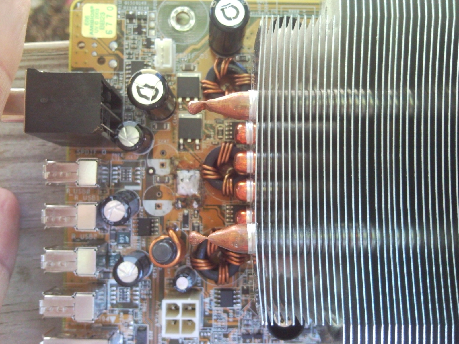

                      I replaced all three transistors with new ones, and figured out if I tin the board first, and hold the iron there for about 15 seconds before applying the transistor, then quickly place the transistor and apply heat to the tab, I can get a good joint under the tab.
                      But, less than 5 minutes after turning it on the same transistor failed again... All pins are open to each other. Obviously there is something else wrong, but I have not been able to figure it out. Any ideas where to look? Thanks.

                              Here is the order of events:
                              1. computer would not power on.
                              2. repaired the power supply.
                              3. turned on computer, saw some smoke in the area around the caps/transistor I have been working on.
                              4. Turned it off quickly. Couldn't tell where the smoke came from, and noticed the caps were bulging. Plugged it back in and the power supply POPPED and went dead.
                              5. Replaced caps (in the wrong orientation) and the computer would not turn on.
                              6. Replaced the transistor, and noticed the caps were backwards and re-installed them correctly.
                              7. It came on and booted up to Windows. I actually restarted it a couple of times over a 1/2 hour time, and then shortly thereafter the transistor blew again.
                              8. I then replaced the transistor again, trying to do a better job of soldering.
                              9. It came on for about 5-10 minutes before blowing the same transistor.
                              10. Replaced all three transistors in that area and it came on for about 5 minutes before blowing.

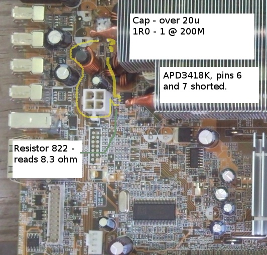

                                      I have been tinkering around and found some more info, but I am not sure if it identifies the problem or not... Here is what I have found:
                                      1. The small cap, 100u/16v right beside the 4 pin connector for the power supply had very high esr. I replaced it with a 100u/25v nichicon.
                                      2. Pins 6 and 7 on the MOSFET close to the same connector are shorted. I removed it from the board and found the MOSFET pins are not shorted, but the tracks on the board are shorted. Pin 6 is Power Ground, and Pin 7 is SW, which the datasheet says is "This pin is connected to the buck switching node, close to the upper MOSFET’s source. It is the floating return for the upper MOSFET drive signal." Is this ok?

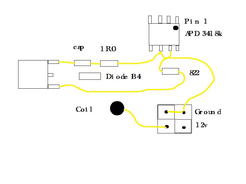

                                      I also traced the tracks and tried to draw it on the attached picture, and then did a drawing also. There is also a diode in the pic that is loosely connected to the trace that connects runs thru the smd cap and 1R0. By loosely I mean when testing it for continuity it acts like it is running thru a cap instead of being a closed circuit.
                                      I wanted to get some feedback before replacing the transistor again to see if the bad cap was the problem.

                                        Look at figure 1 in the data sheet below. It is a reference drawing for the MOSFET driver chip and may not be exactly what you have, but you can clearly see pins 6 & 7 should not be shorted together because if they were Q2 wouldn't work.
                                        http://pdf1.alldatasheet.com/datashe...DP3418KRZ.html
