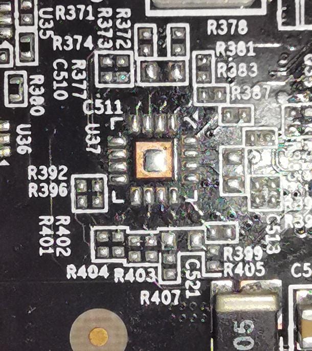

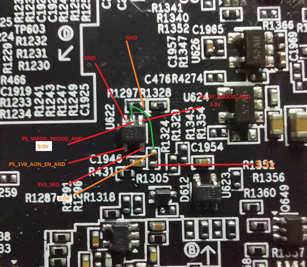

    Hi, I have a Gigabyte RTX 2080 Super graphics card, model gv-n208sgaming-8gc rev 2.0. The issue I'm facing is that I don't have the 1.8V voltage. I have checked similar schematics (from a Gigabyte RTX 2080) and found that the enable signal in U11, responsible for the 1.8V, is missing. Using a boardview of a Gigabyte RTX 2080 Super OC, I discovered an AND gate that is missing the PS_VMON_PGOOD voltage, which is provided by U37 (INA3221AIRGVR), but that component is not present on my graphics card. I would appreciate any hints on where I could look for a solution. Thank you very much. I have attached photos of the measurements.
    P.S.: The logic gate is functioning properly, and the resistors are not open; they have been removed, replaced, and tested.

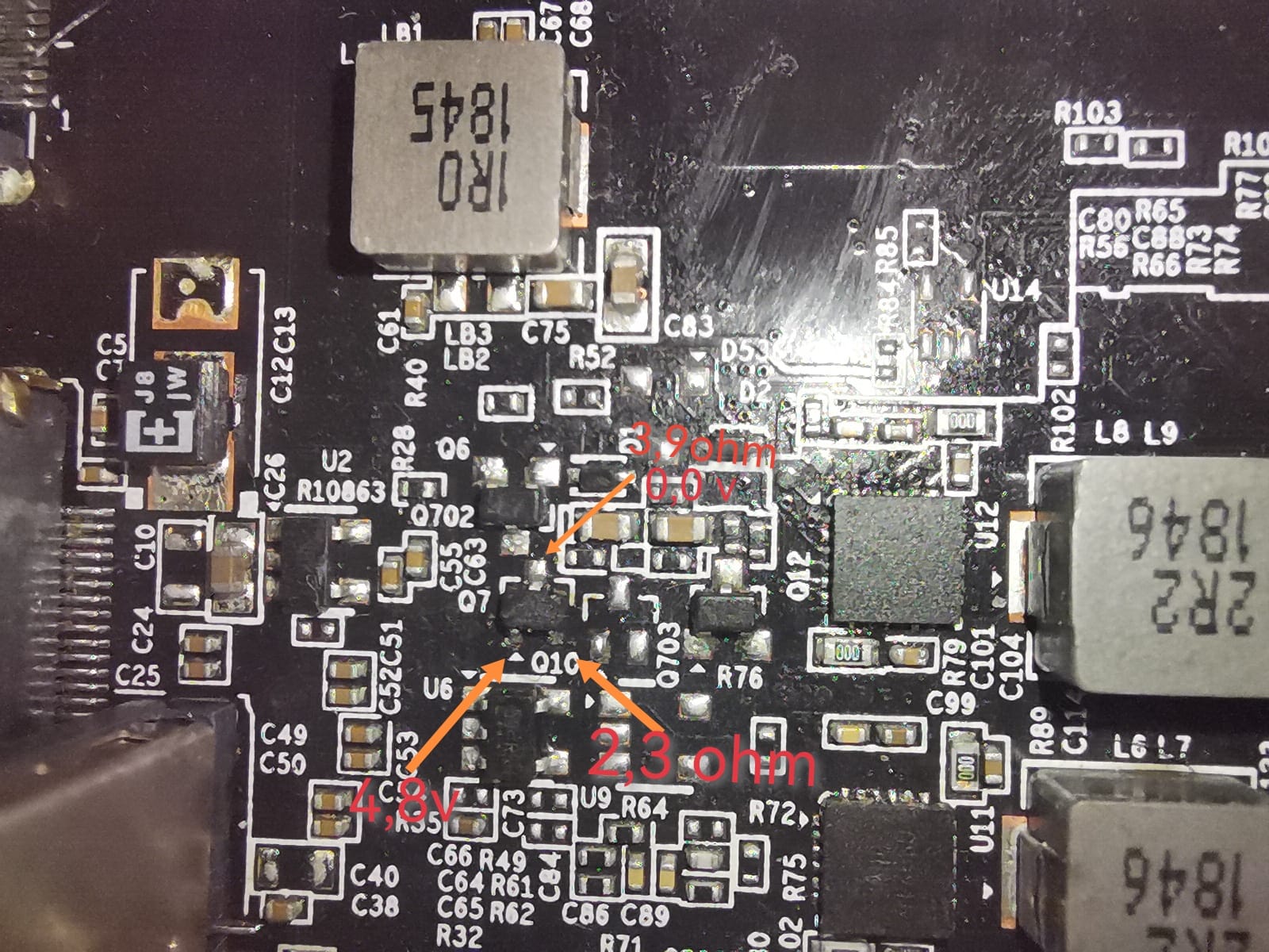

    what about Q7 and Q10 ?

      Re: gv-n208sgaming-8gc no 1.8v
      Q10 is not there and in Q7 I have the values of the photo, is q7 broken? Supposedly it is an LS3018NG-3T3R but I have not found the datasheet or the component to buy it.
        check schematic your measurements dont make sense

          Did you manage to solve that problem?
          The same thing is happening to me, in Q7 I have your same values​

            Just for the record.
            I managed to repair the graphics card by replacing that integrated LS3018NG (Q7), searching the schematic I realized that there is another one exactly the same that controls the voltage of the USB-C that the graphics card has, so I removed that integrated, and replaced it with the defective Q7 .
            I have not tested the USB-C on the card since I do not use it, but if there is no replacement, such a repair may be viable.
            For my part, I will order that component through Aliexpress to make the USB-C functional again.​
