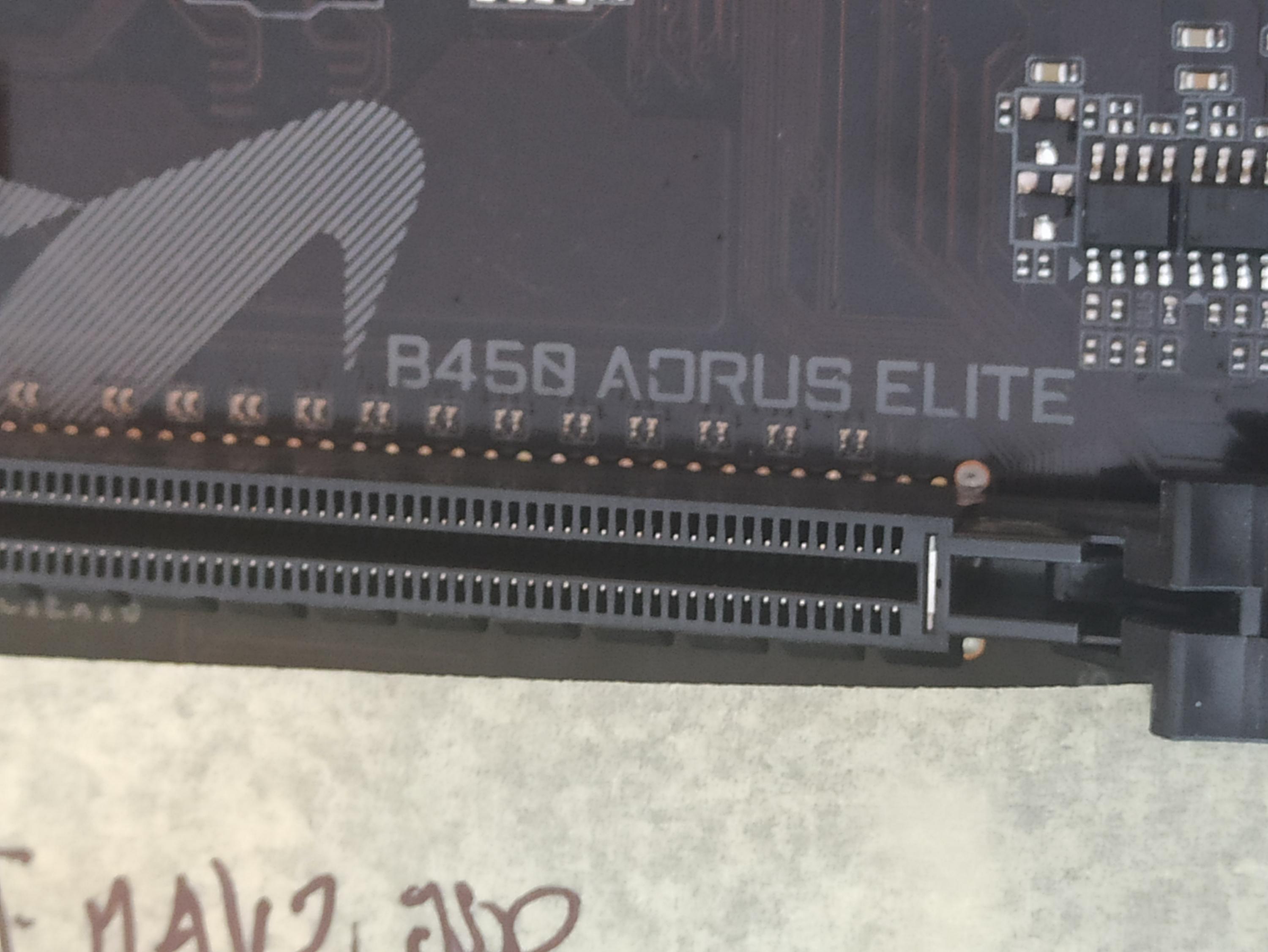

    Hello.
    Have this board B450 Aorus Elite that have burned MAU2 chip. i cannot identify it, so little help will be apresiated
    original chip was burned so here it is photo of same board
    • 21853
    Re: MSI B450 Aorus Elite - need identify chip
    Originally posted by ktmmotocross
    Hello.

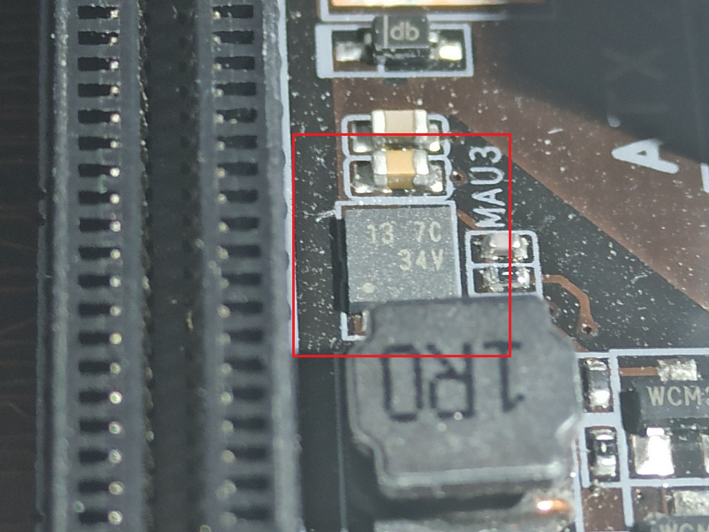

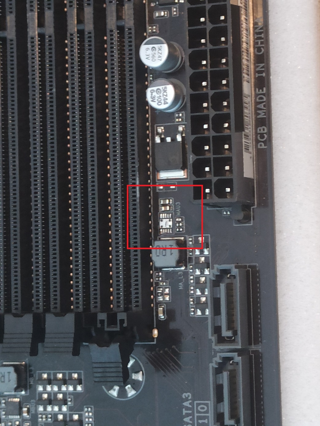

      hello.
      Have this board b450 aorus elite that have burned mau2 chip. I cannot identify it, so little help will be apresiated
      mau3 - rt8068azqw/wdfn-10l
        thanks guys i order it
