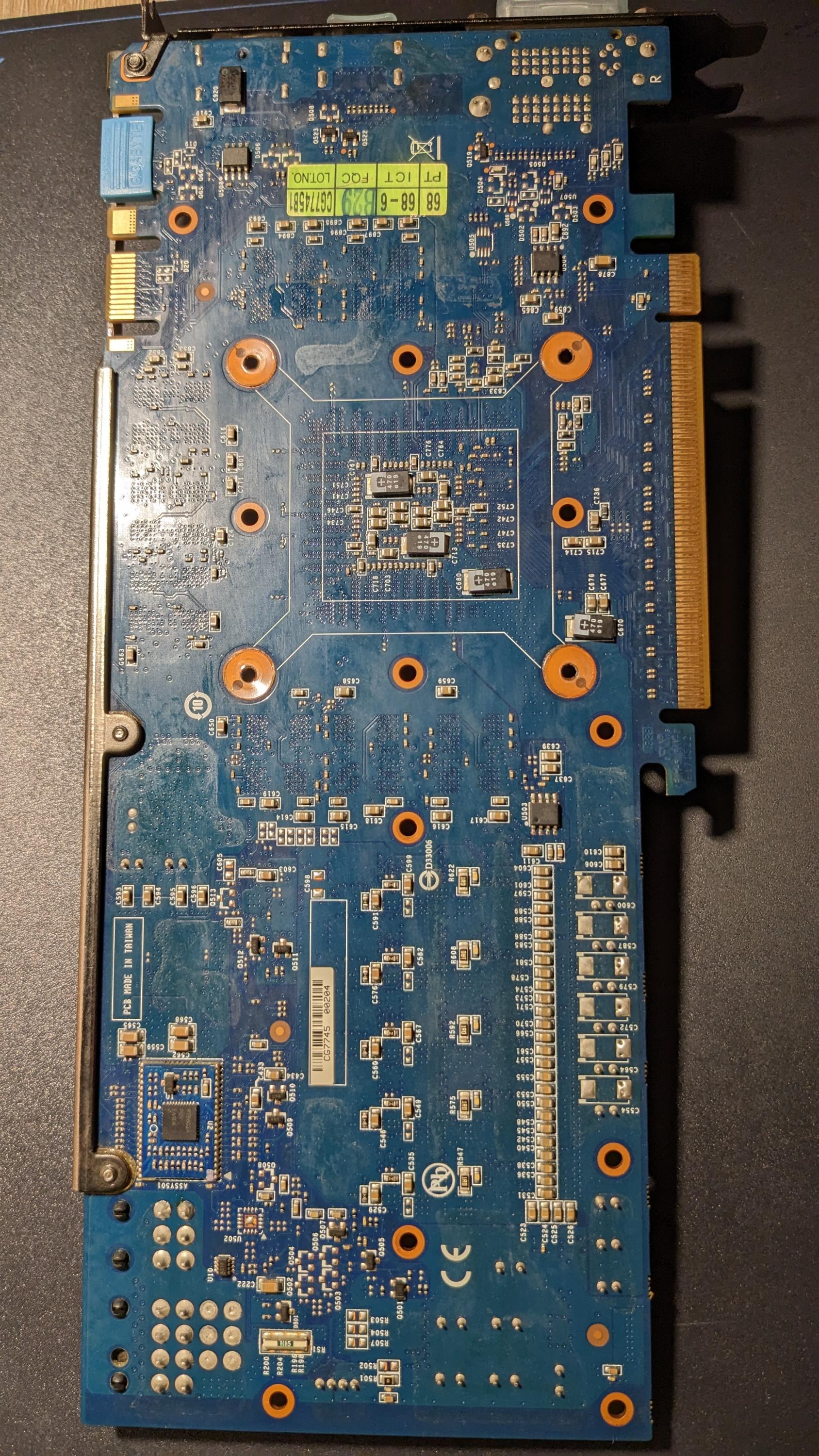

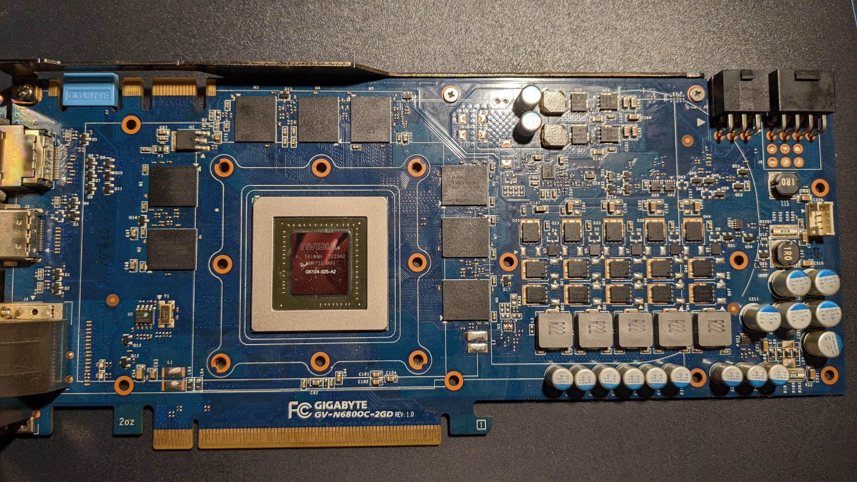

    i have a Gigabyte GTX 670 OC 2GB here which shows no picture.
    - Fans are spinning
    - Windows detects the card as „Microsoft VGA Adapter“ when inserted as 2nd card
    - MemVoltage = 1.6V
    - Vcore = 990mV
    - 3,3V and 5V ok
    - Pex = 1.054V
    - No short circuit
    - All resistances i could check are ok
    Is there anybody who wants to help me?

    Re: Fixing Gigabyte GTX 670 OC 2GB
    mostly memory comunication fault. bad connection under gpu, bad connection under ram chip.
    did windows try to download driver for that second card?

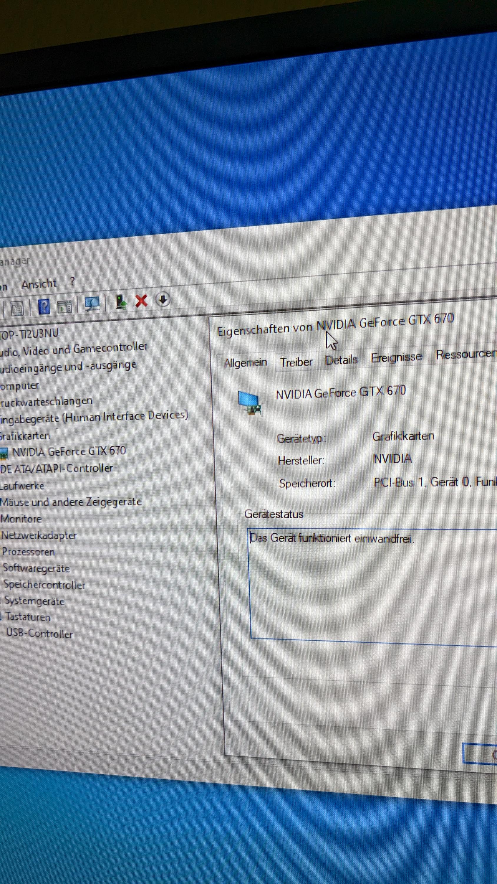

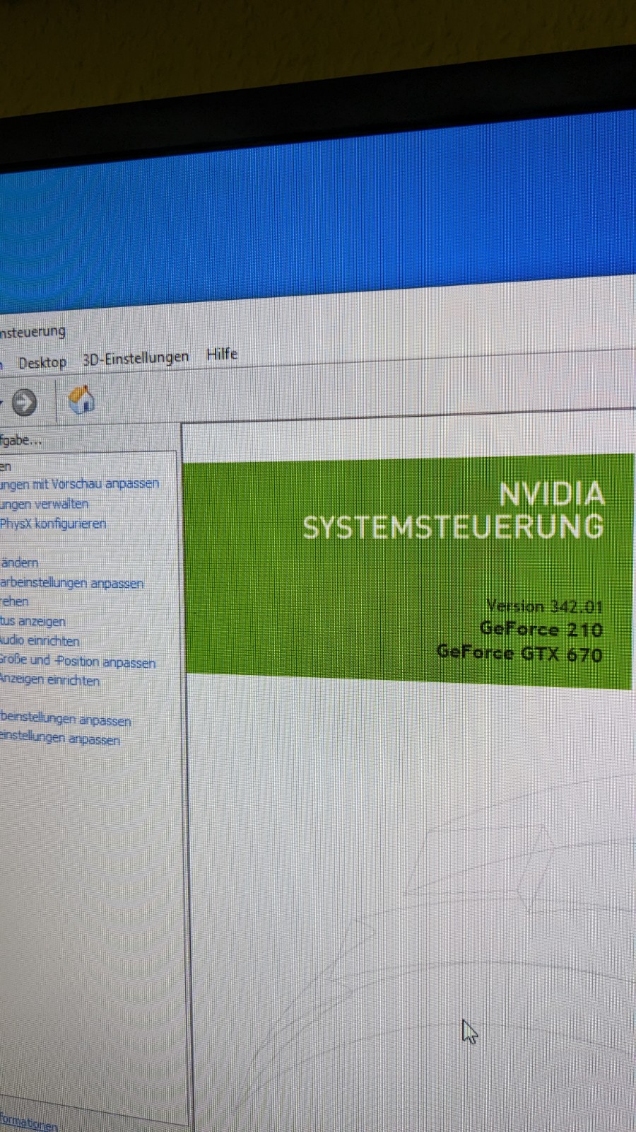

          what if u manually install driver?
          • saken
            • Feb 2023
            • 18
            • GER
            Hey,
            now windows is downloading and installing the driver correctly. It just took some time to start.

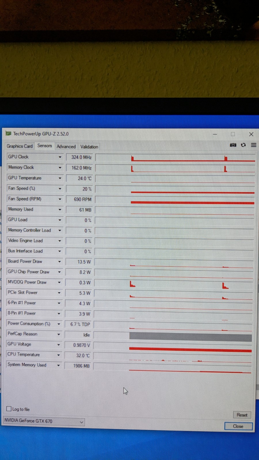

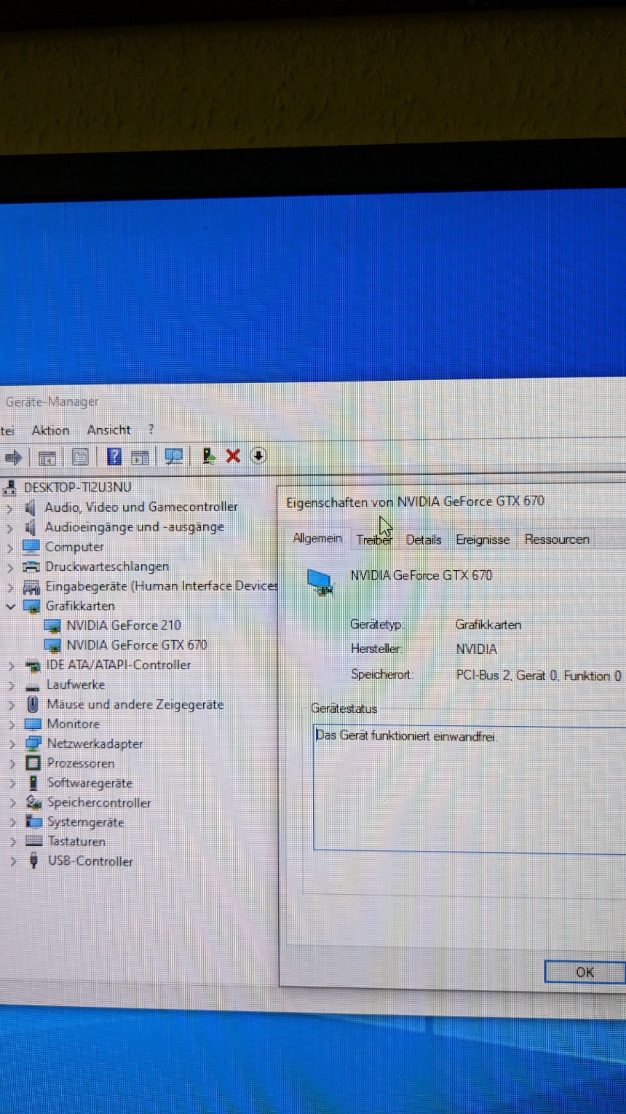

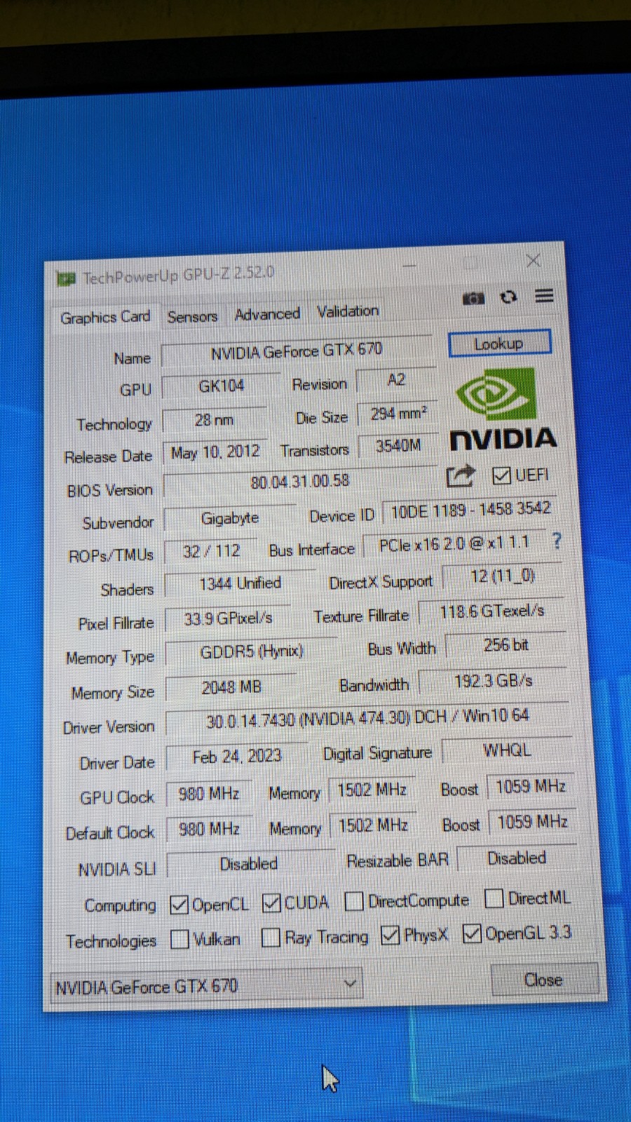

                    i got some news. When i connect the GTX670 with RiserCable as 2nd card. The card works, see Screenshots below.
                    But when i connect the GTX670 directly to the mainboard, the card is not detected.
                    Any ideas?
                      One of the series capacitor for a PCIe lane is most likely broken off. Or a PCIe lane is bad. Visual inspection and diode mode as always.

                              • GER
                              Originally posted by saken
                              Yes i tested already all outputs, no picture .
                              I was wrong. To be honest I can't remember. So i tested it again...and i get a picture with RiserCable and only the GTX670 connected, see screenshot below.
                              And something crazy after this, i tested the GTX670 directly connected to the mainboard and got a picture too. Only x8 instead of x16. After 15 minutes the picture freezed.
                              Soo...wheres the problem?
