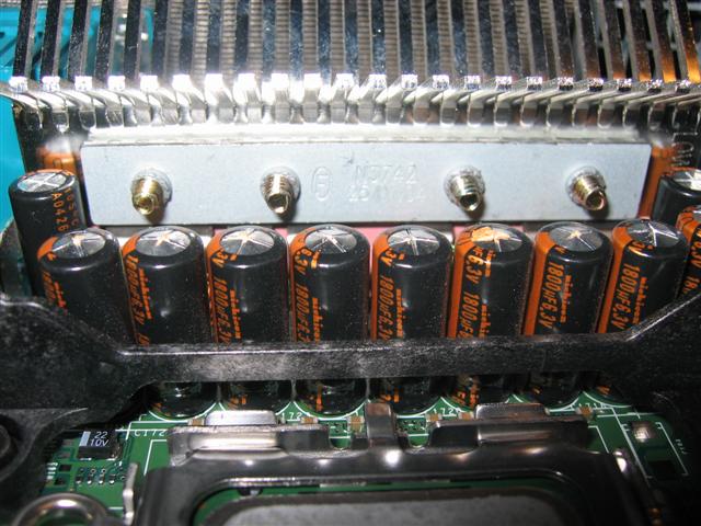

            We have approx 1200 GX280 in our organization and are experiencing major problems with bad caps. The machines was aquired about 18 months ago.

              how is dell dealing with your problem? do you have any pics of the failed caps?

                  Re: dell Optiplex gx280
                  Up until now we have just called Dell and got a repair-guy over the next day, but now the number of machines with this problem is steadily rising making that impossible. We have a pool of computers we send out to users all over the country, but the pool is now dried out because of the problems.
                  The situation as of now is that we have several user without the proper equipment to do their job.
                  We are going to have a sit down with Dell to find a solution.
                  I don't have any pictures at the time but I can post some when I get the chance. The caps affected is mostly the one between the cpu socket and the back of the computer - mostly bulging, but some leaking too. In some cases the row of caps by the memory sockets are bulging too.

                    give em hell. you are going to need proactive replacement off all suspected boards. if they have the bad nichicon HN or HM batch on them those caps will all fail.
                    it is bad the problem stretched to the GX280 series also. The date range we had for the GX270s was board manufactured 04/01/2003 to 03/20/2004. I think the problem therefore extends past that.
                    If you get better info about the date range or range of service tags of your affected units that might help others with the same problem.
                    hope you have success. the info we got for the GX270s was that they used rubycon capacitors in place of the nichicons on the replacement boards. should be fine for years. Check if your replacement boards have those.

                          I have just come from a meeting with Dell. They will do a preemtive repair on approx 200 critical, meaning they will replace the motherboard on 200 computers before any problems can occur.
                          The rest will be handled like we handle them now. The user reports to us of a problem with the computer. We, in collaboration with the user, troubleshoot over the phone, and if it turns out to be a problem with the caps we send out a new computer to the user and the user sends us the broken one. Then we report it to Dell and they come and fix the computer.

                                    Users report of loud CPU-fans. The the computer gets really slow and unstable. Then it won't boot anymore. They get through POST and starts booting Windows XP and then the screen goes blank and you have to pull to power cord to shut it down.
                                    Dell said they had a check list that they can go through over the phone to identify the problem. That was 2 days ago. I still haven't gotten any list.
                                    We need the list to be able to get Dell to repair the computers. Without it users have to send in the machines to a central location to be opened diagnose the problem/look at the caps. The users are not qualified to do this themselves and it is not part of the SLA they have with my company.
                                    • MD Willington
                                      • Sep 2004
                                      • 702
                                      That is the same (old) heatsink issue the GX270 had, the guy next to me had one that was like a freaking jet engine, just heard one again last week.
                                      Demand a replacement "performance heatsink", it has 4 heat pipes instead of 6 and is generally regarded as way better. If they give you grief about it, tell them that is what the moderators on the DELL forums have been suggesting for some time now.
                                        Here is a picture of some caps on the motherboard.
                                        you can find some more pics with better resolution here
