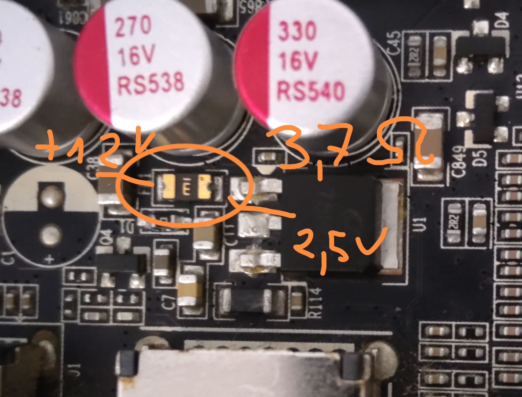

    Zotac Gtx 970 no post, component identification.
    Hello @all,
    I have here a Zotac GTX970 card and it is not running.
    I need to know what kind of part I marked on the picture?
    Thank you in advance.

    Re: Zotac Gtx 970 no post, component identification.
    It's a fast acting precision fusing speed 1A , 250VDC .
    • Badboy3004
      • Feb 2023
      • 5
      But for a fuse 4 Ohms is to much. Is it damaged?
        Yes , something isn't normal here , its internal resistance should be 0.093 ohms , equal to nothing , but yet , you should test it outside board .
          I will do so.
          Thank you very much.
              better check how u measure it.
                  Originally posted by jbog89
                  I have the same video card, I can give the exact value.
                  on youtube is manu videos what to measuse and how
                  one of many
                  https://www.youtube.com/watch?v=erQP...annel=CmdrSoyo
                    Yeah, but it is hard to guess the right value for every components without the same board/donor board or schematics
