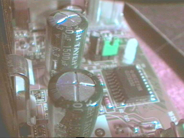

    MSI MS-6153VA v2.1
    Came with bulged 4 Tayeh 1500uF/6.3V caps around the CPU. Replaced with Kome 2200uF/16V of the same size and it works fine now.
    I've repaired the same board type with the same problem some time ago - and that one had also resistor network near the CPU socket damaged.

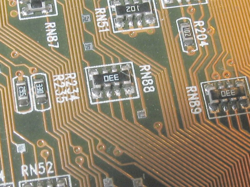

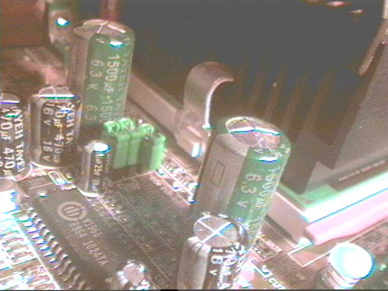

    Re: MSI MS-6153VA v2.1
    This time it's v2.2. This time with two bad Tayeh caps and two visibly OK. Replaced them all and also all 1000uF and 470uF Chhsi.
    Bad Tayeh caps:

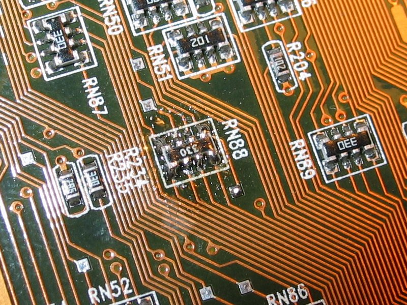

    Cracked resistor network causing primary IDE channel not to work:
    Replaced resistor network:
