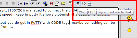

                      #30
                      Re: broadband ut300r2u modem,link light stays on forever
                      Originally posted by playit
                      i managed to connect the ch341a to board, but no matter what speed i keep in putty it shows gibberish characters, no english.
                      Post the output you do get in PuTTY with CODE tags, maybe something can be understood from it.

                        #31
                        i thought i connected it right , actually that time i think i connected rx of usb to some rx or tx of board, gnd of usb to vcc pin in board, so it went on reading gibberish faster non stop , but this time i learnt what is gnd in board so when i have posted in above post that nothing happens when i connect gnd to gnd , rx of usb to rx or tx of board. if i take disconnect gnd to gnd , then gibberish characters will come again , if gnd is connected back, it will stop.
                        what is code tag.. i dono what its..
