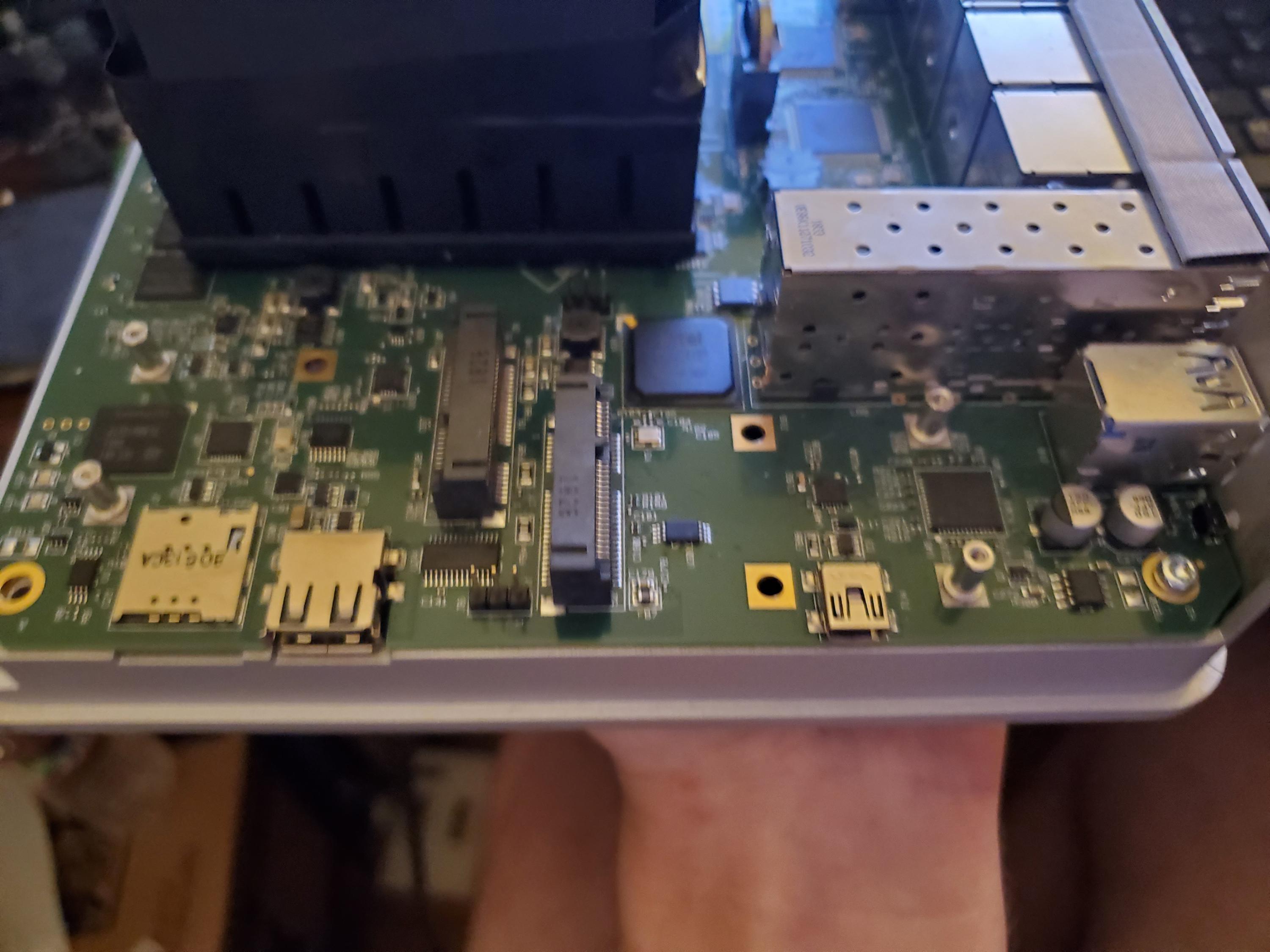

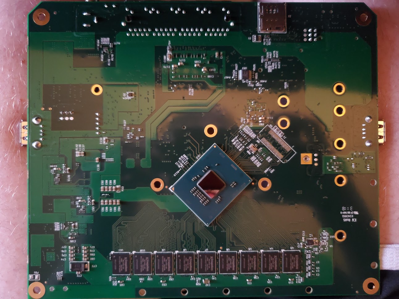

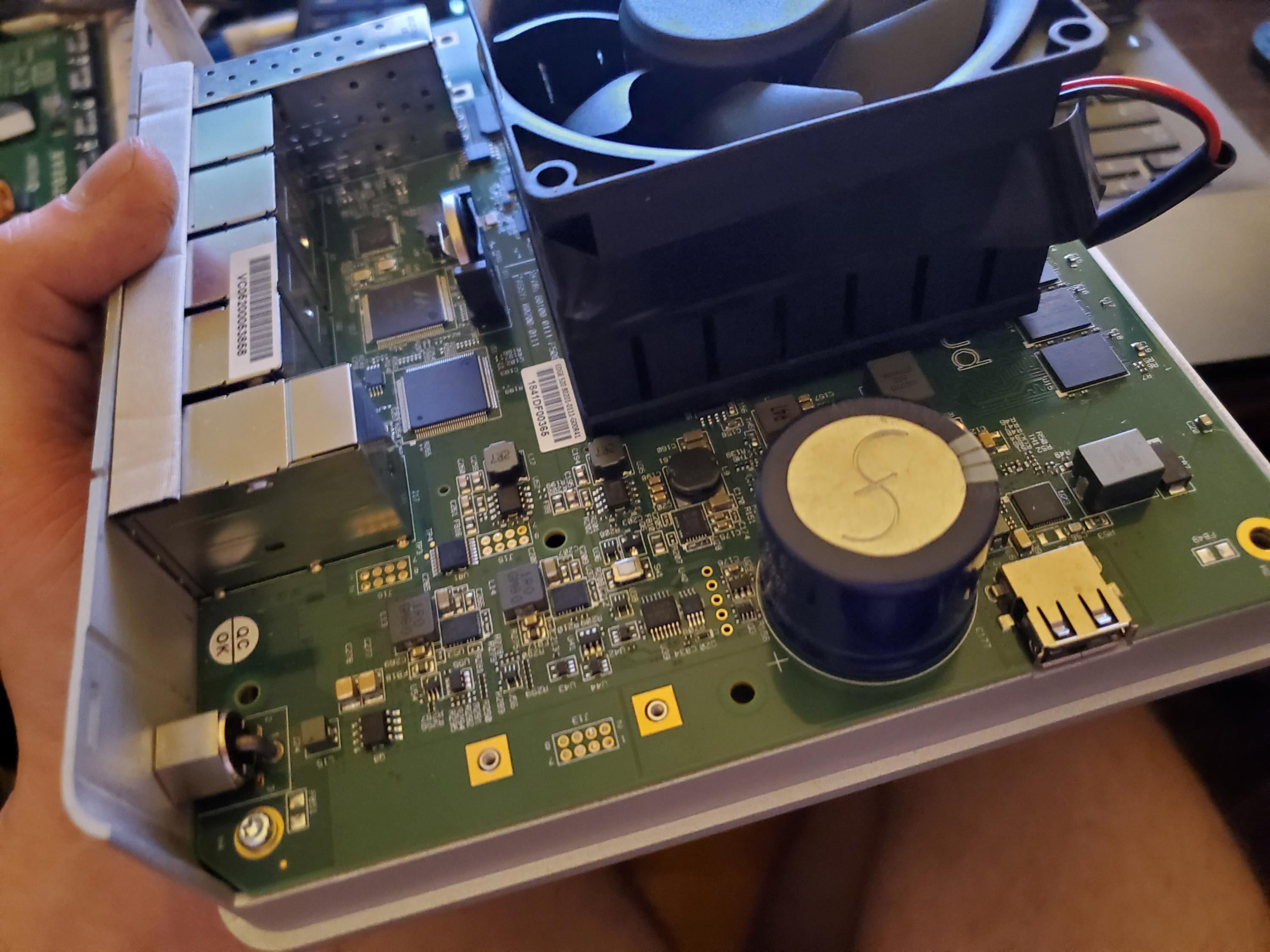

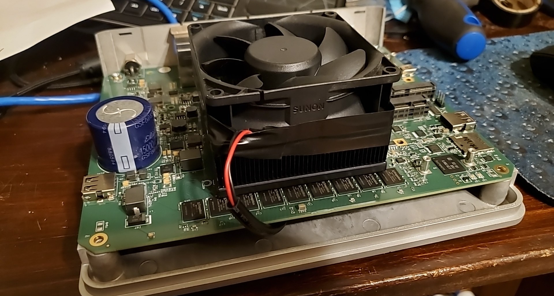

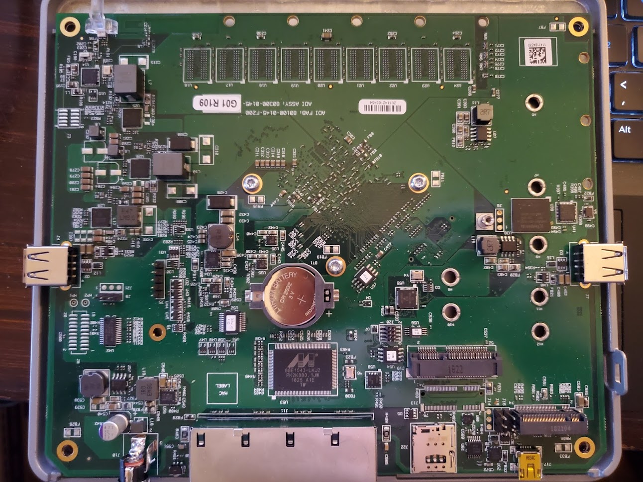

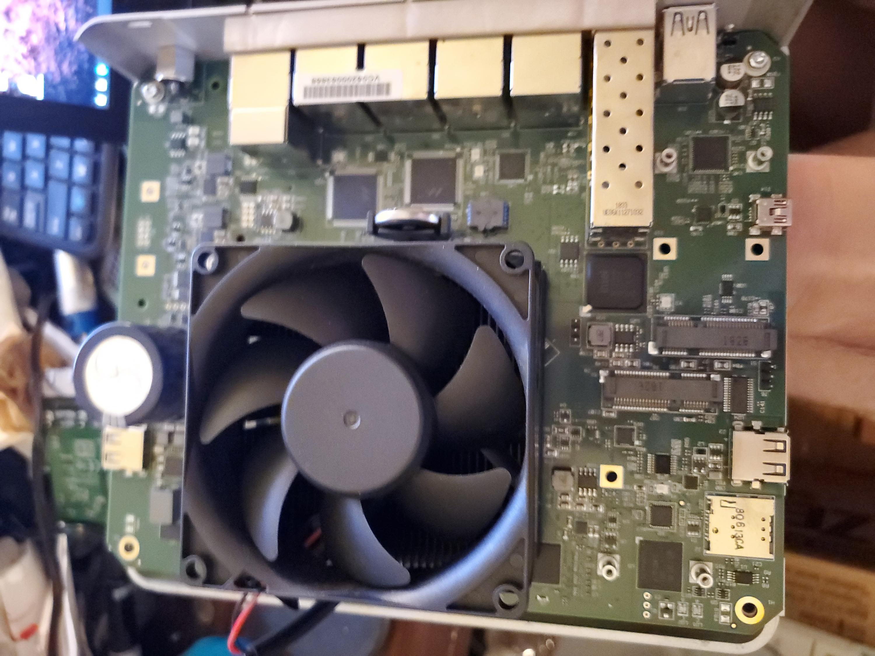

                        Re: VeloCloud Edge 520 Problem - Unable to boot
                        Originally posted by stj
                        bad power on them - from shit caps?
                        got any pics of these ?
                        This is one of the 520s. I even added a fan haha.
                          • 30978
                          not much to see is there!
                          i wonder what that big cap does!
                          • shovenose
                            Send Doge Memes
                            • Aug 2010
                            • 6575
                            Yeah, I am not sure... the 510 doesn't even have the big Elite 25v 15000uF... I've attached some pics of that one.
                            My second 520 seemed to boot up fine with the stock firmware. When I first got it I connected to the console and let it sit for a few mins. It worked fine. Then I attempted to install pfSense. Couldn't even make it through the installer without crashing. Got far enough to erase the stock firmware tho haha. I timed it and it's always 2 minutes on both of them before it crashes/reboots. Even the one I took the heatsink off, put a different thermal pad, and taped a fan to. And on the 510 it's always 5 mins to crash/reboot. Both the first test boot of the morning after it sat all night and the second time right after that.
                            I'm so lost and confused.
