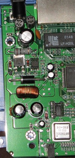

    Some time ago, I bought an 8-port Starnet SH-9008P Fast Ethernet Switch.
    Upon opening, two bulging (one leaking) 1000uF 10V S.I. electrolytics were found.
    Replacing these units restored the +3.3V output on the DC-DC converter and was well within tolerance.
    Testing with two network devices connected revealed no problems .

    Re: Starnet SH-9008P Ethernet Switch bad S.I. caps
    Nice!
