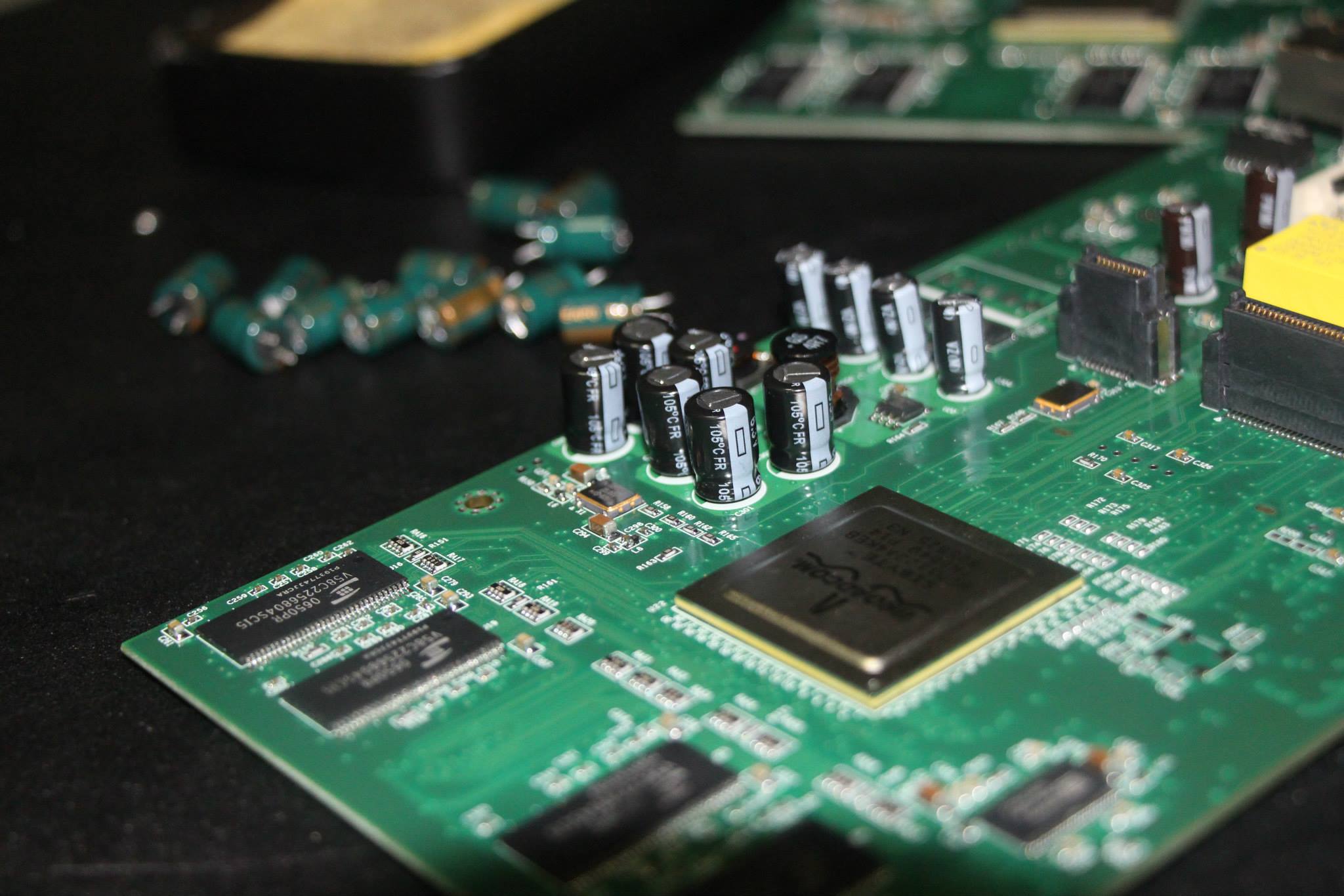

    Received some Extreme Network switches. Feedback from client that it will go Kernel Panic once in a blue moon.. till recently it goes often.
    Overall they are gd network equipment..... 1000Mbps ...
    Removed from service, she is being wheeled down to my desk for a check,
    Indeed after some minutes of up-time, the switch will "hang".

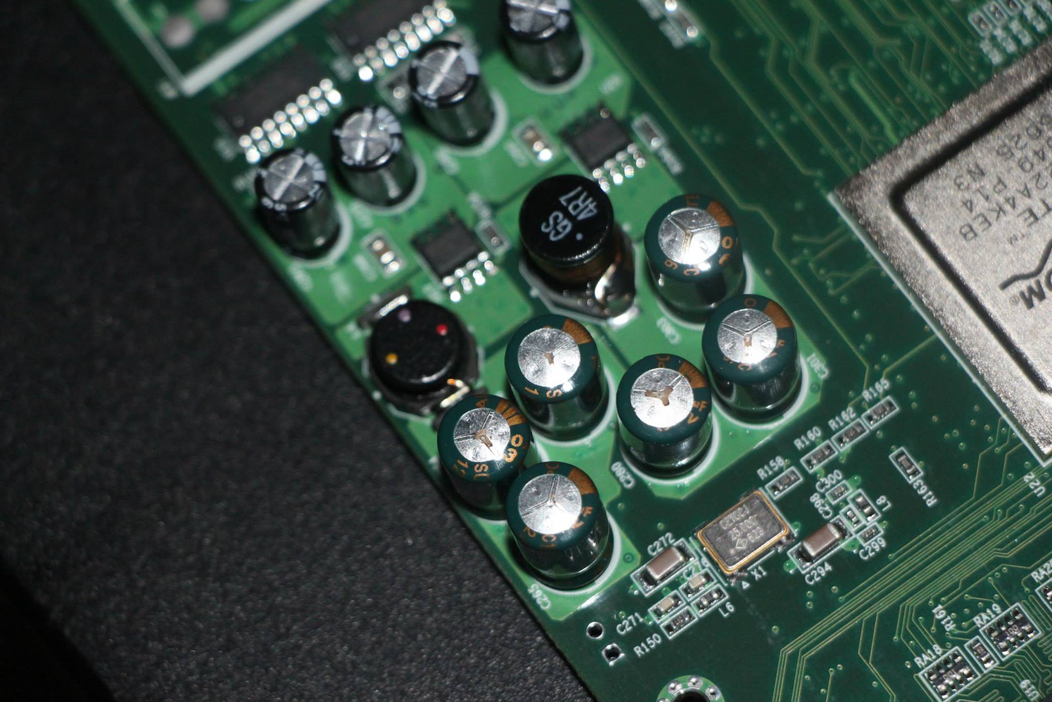

    Open up and see... sighs... lots of Taicon on another board.... and yea... the excitement came when I removed the daughter board.....
    you guessed it, Bloated Teapos!!!!
    must be inside contained tea... it dried up and

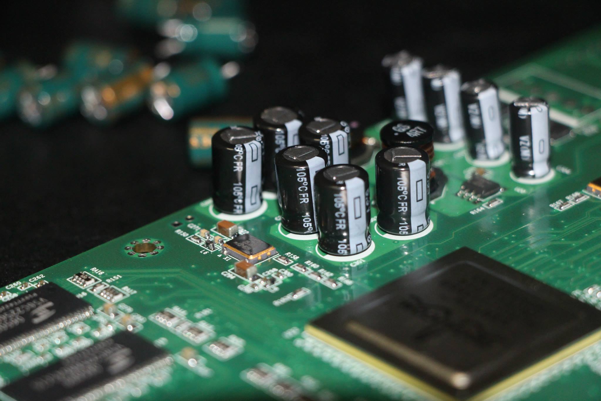

    Order replacement..... Panasonic 1000uF 6.3V 8mm - FR Series...
    Fired up the soldering iron..... and changed those craps....
    she look pretty now

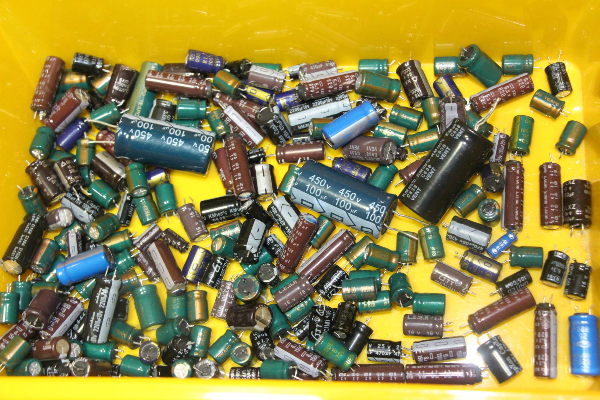

    Fate of the teapo caps....
    inside the can of crap.

      I sure do hope that yellow container gets emptied into a fire

        The pictures shown suggest the switches may be used in wiring closets where HVAC may not be present? As such, they are likely running 24x7 in potentially high heat unlike being in a nice AC cooled data center.

          Why did you use Nichicon VZ for the small caps? There are much better choices available that last a lot longer...

            Looks like those were already there.

              yep... cheapie was right
