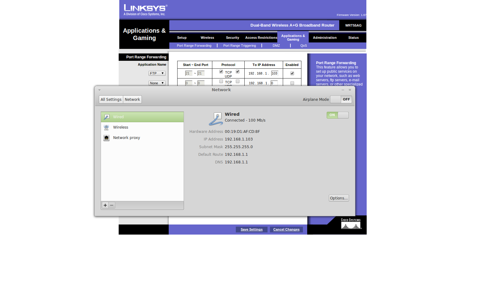

    how to access ftp server over internet
    i have an ftp server running on my debian pentium-d computer with a 100mb network and a cisco router, i want to access my ftp over the web but my budget for this is 0$ so i can't get a domain name so is there any way i can get to my ftp over the internet?

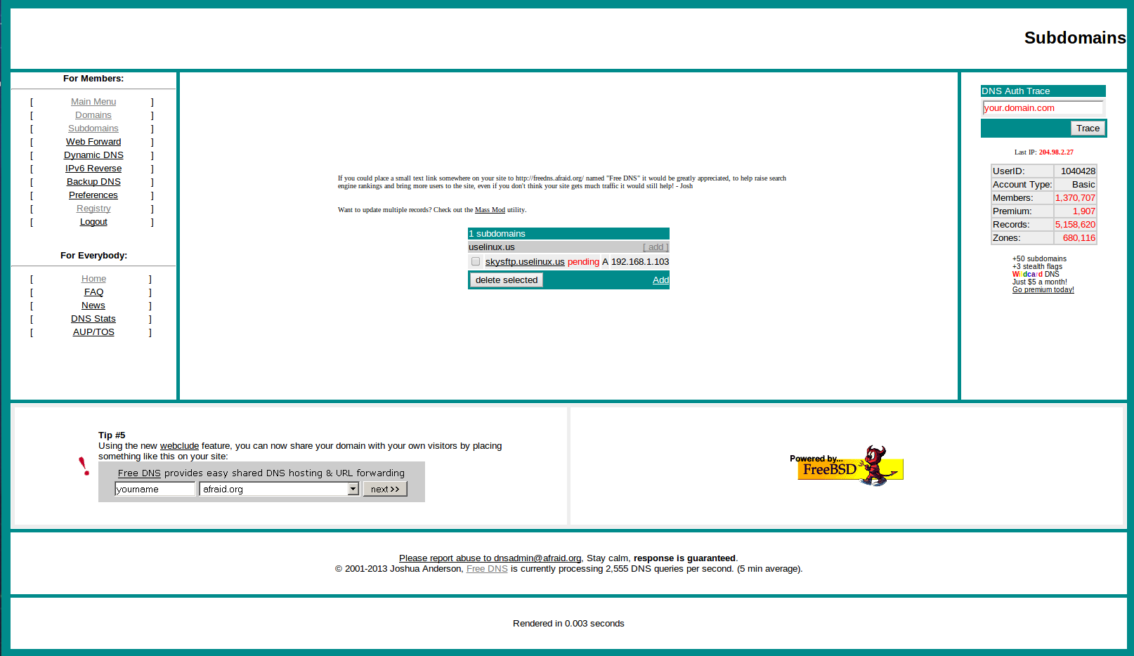

      If you don't want to spend money, there are free subdomain services... for example see : http://freedns.afraid.org/
      Basically you signup and make up a name, like "goontron", and then you get a domain like "goontron.homenet.org" and from that site's control panel you can set the ip.
      Then whoever writes ftp : / / goontron .homenet.org will connect to your IP.

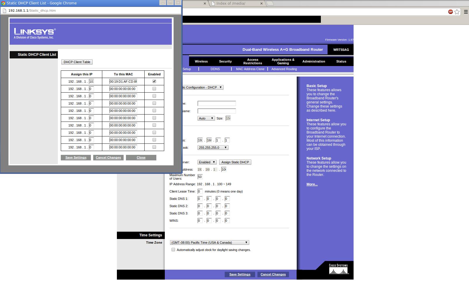

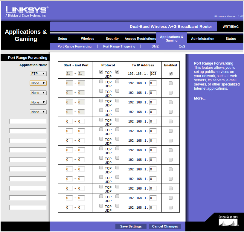

      Finally, you have to set up your router to forward all commands coming to the router's IP to your computer that has the ftp server. There should be a page in your router's settings called "port forwarding" or "ftp redirection" or something like that.

        Re: how to access ftp server over internet
        it works thank you soo much for your help i have tried this before but it didn't work so well...but now it works and i can access my files anywhere and set up wasn't too hard for me this time around thank you mates.
        i used Free DNS
          No, you don't put 192.168.1.103 to skysftp.uselinux bla bla ... that's the IP from within your network which can't be accessed from outside. It just happens to work because you connected to it from your own network (your home). If you go somewhere else, you won't be able to connect because 192.168.1.xxx is local ip, only present after your router.
          You need to put the IP that you're seen from outside with. If you don't know it, try something like http://www.ping.eu - it should say "Your ip is ##.##.##.##" <-- that's the IP you need to use.

          These days, programs work with the internet pretty much by creating a bi-directional connection between computers and talking back and forth. HTTP (websites) work like this: your browser connects to the server, says "give me this page", and the server replies on the same connection saying "ok here's the page" and immediately sends on the same connection the data.
          FTP works a bit differently. The connection created initially, for which you need that forwarding on port 21, is only used by the ftp server to accept commands, it's like a basic chat.
          You can connect to the FTP but you can't actually receive folder listings and files through that connection.
          When you request a file, the FTP server tells your computer through the original connection (the one through port 21) that he has the file and that he waits for you to connect to another port on the remote server to actually get the file. While you copy the file through the other connection, the ftp server accepts more commands from you through the original connection on port 21.
          This is passive mode.. there's another mode called active mode in which your computer tells the server on what port it listens for incoming data and the ftp server is supposed to connect and send data to you. This is problematic again when it comes to computers behind routers, with private IPs (not Internet IPs).
          You can learn more about these two modes here: http://slacksite.com/other/ftp.html
          Basically, the most pain free for you is to use passive mode. You have to configure the ftp server to force passive mode and only use ports from a specific range (let's say 62000-63000) and then tell the router to forward that range, so that any connection to your router's external IP gets passed to the internal ftp server.
          Then, everywhere you want to use FTP, you have to configure the ftp client to use passive mode by default - most clients do or switch to passive mode when the ftp server says it does not allow active mode.
          In Filezilla FTP server, you can set the server from configuration easily : Filezilla server options > Passive mode settings > use custom range [ ] - [ ]

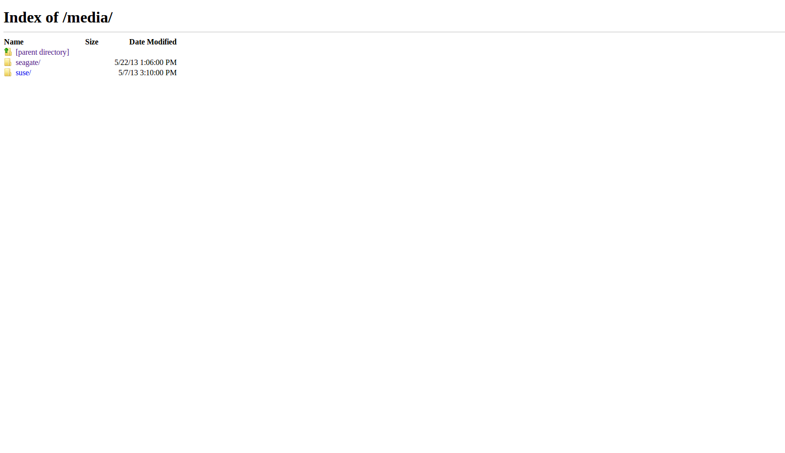

                skysftp.uselinux.us was privet and i got rejected and the new ftp ftp://skysftp.windmillstravel.com/ dosnt work with new ip ether
                  ok it just needed the DNS server to refresh its cache and now it works from my school.
