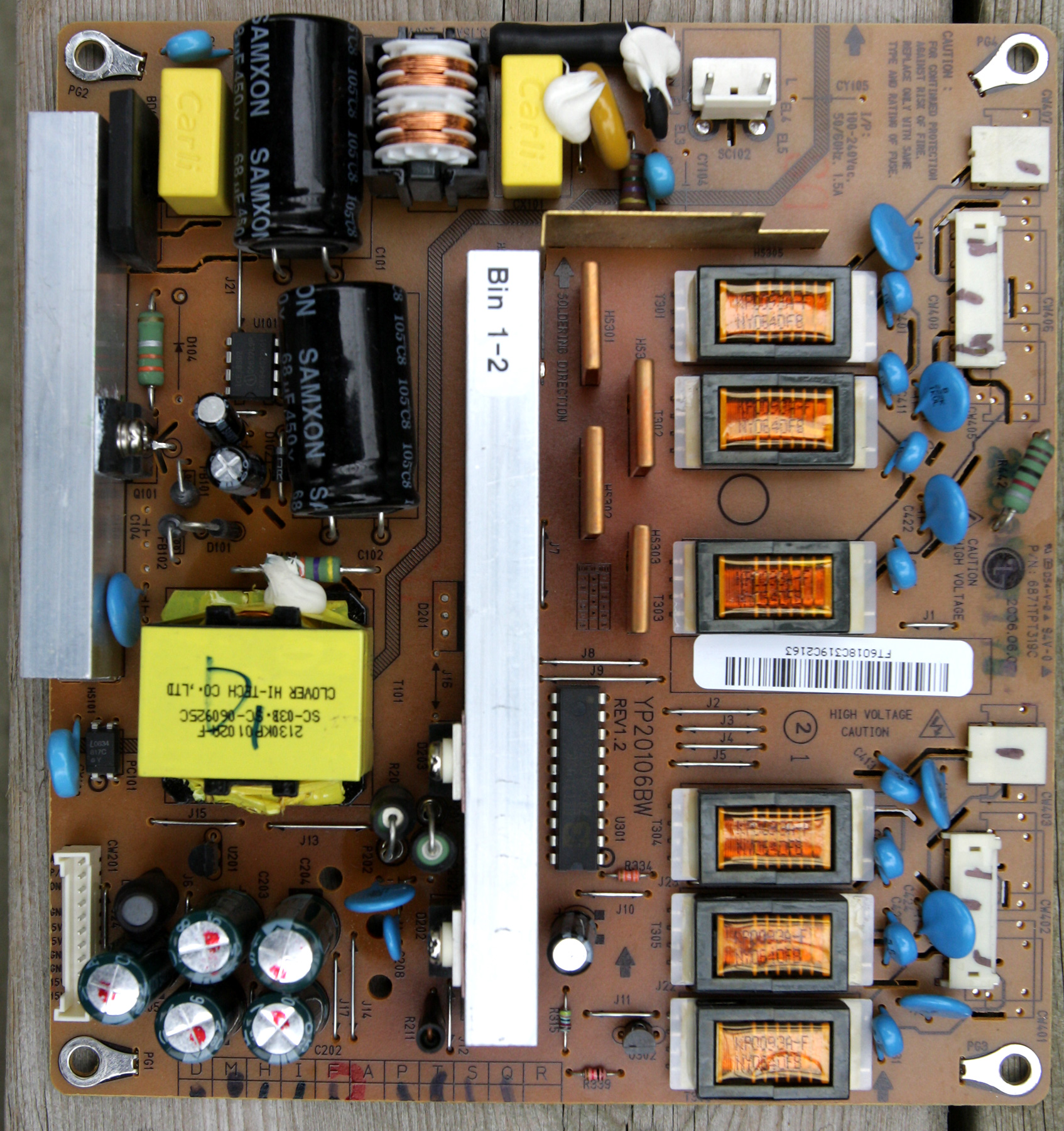

    This nice looking 20" LG belongs to a family member.
    I forget the original symptoms, but it was pretty much dead when I picked it up.
    Man what a pain to open up. Once I got the panel out of the plastic case, I notice nothing holds the metal cage that the boards are in, to the panel other than the metal tape.
    Initial inspection 2 bloated Samxon 1000 @ 16 caps. I decide to do a total recap (minus the 2 big 450v ones, only because I didn't have 'em)
    The power supply/inverter board looks to be decent quality, and there are 4 interesting copper heat sinks on the top that cool 4 transistors on the solder side.
    2 of the 1000 @ 16 caps measure 27 and 31 uf and 7 and 9 ohms esr. No surprise it didn't power on. The 1uf and 47uf small caps (startup?) were a bit high esr as well.
    After the recap, it fired up, but looked like crap. Colour was awful.
    Factory reset helped the focus, but not the colour.
    Found colour balance in the menu, and looks perfect now.
    Not looking forward to re-assembling it now..
    Samxon GF series?

            Is the attached screenshot the repaired board or the bad board?
            I finally got it open and 2 of the 47uF caps in the bottom left of your picture look somewhat blown. Its not very obvious (to me at least since this is my first time trying to repair blown capacitors) but everything else looks pretty close to the picture you attached, hence the question.
            • retiredcaps
              • Apr 2010
              • 9271
              Re: Lg l204wt
              The pic that smason has in post #1 is the bad board with bloated caps. Notice the dome?
              Also note that smason recapped every cap minus the big ones.

                    Add me to the folks who were struggling with getting this one open until I came here.
                    Same non-start problem, same Samxon caps.
                    I replaced the three 1000UF and the two 680UF and now things are back to normal.
                    It went back together very easily, but I must admit I gave it quite a few tests before I snapped the trim back on, I didn't relish the thought of taking it off twice.

                          Please let me know the capacitors location. I have mixed up, I am so stupied .
                          25V 680uf, 25v 1000uf, 16v 1000uf.

                            Can you post a picture of your board showing the missing caps. It may then be down to sleuthing ,guesswork or good luck unless someone has a board in front of them (even to asking someone selling a board on ebay if they can help!)
                            Perhaps looking closely at pics and your caps can help eg the cap at C202 has a 25 on it - probably 25v so that is not the 16v cap.- some of the others have 8 or 80 so possible the 680 cap. Are the 680 25v and 1000 25v physically different sizes? etc

                              Go backwards from the output connector (bottom left in the pic in post #1) to the caps. As in: follow the traces from the labelled pins till you reach the positive pin of where the cap was.
                              Most likely scenario:
                              The 5V pins go to 16V caps, most likely through the inductor (the black thing in heatshrink tubing marked "L" on the board)
                              The 15V pins go to 25V caps

                                I do not know which one is for C202, or C203, c204, c205, c206.
                                Something 25V 680uf, something 25v 1000uf, 16v 1000uf
                                Who knows the exact location for these capacitors?

                                      Repairing my LG L204WT-SF monitor, and need to confirm the cap voltages (I am not at the same location as the board with the bad caps, so I can't just look at it to confirm for myself ).
                                      Appreciate if anyone can let me know voltage for these 8 capacitors:
                                      1000uF / 105°C x 1
                                      1000uF / 105°C x 2
                                      680uF / 105°C x 2
                                      47uF / 105°C x 1
                                      33uF / 105°C x 1
                                      1uF / 105°C x 1
                                      thanks!
                                      • smason
                                        • 1652
                                        Re: Lg l204wt
                                        From my notes on 2 of this model, I have replaced:
                                        1uf @ 50v x1
                                        47uf @ 50v x1
                                        680uf @ 25v x2
                                        1000uf @ 16v x2
                                        1000uf @25 x1
