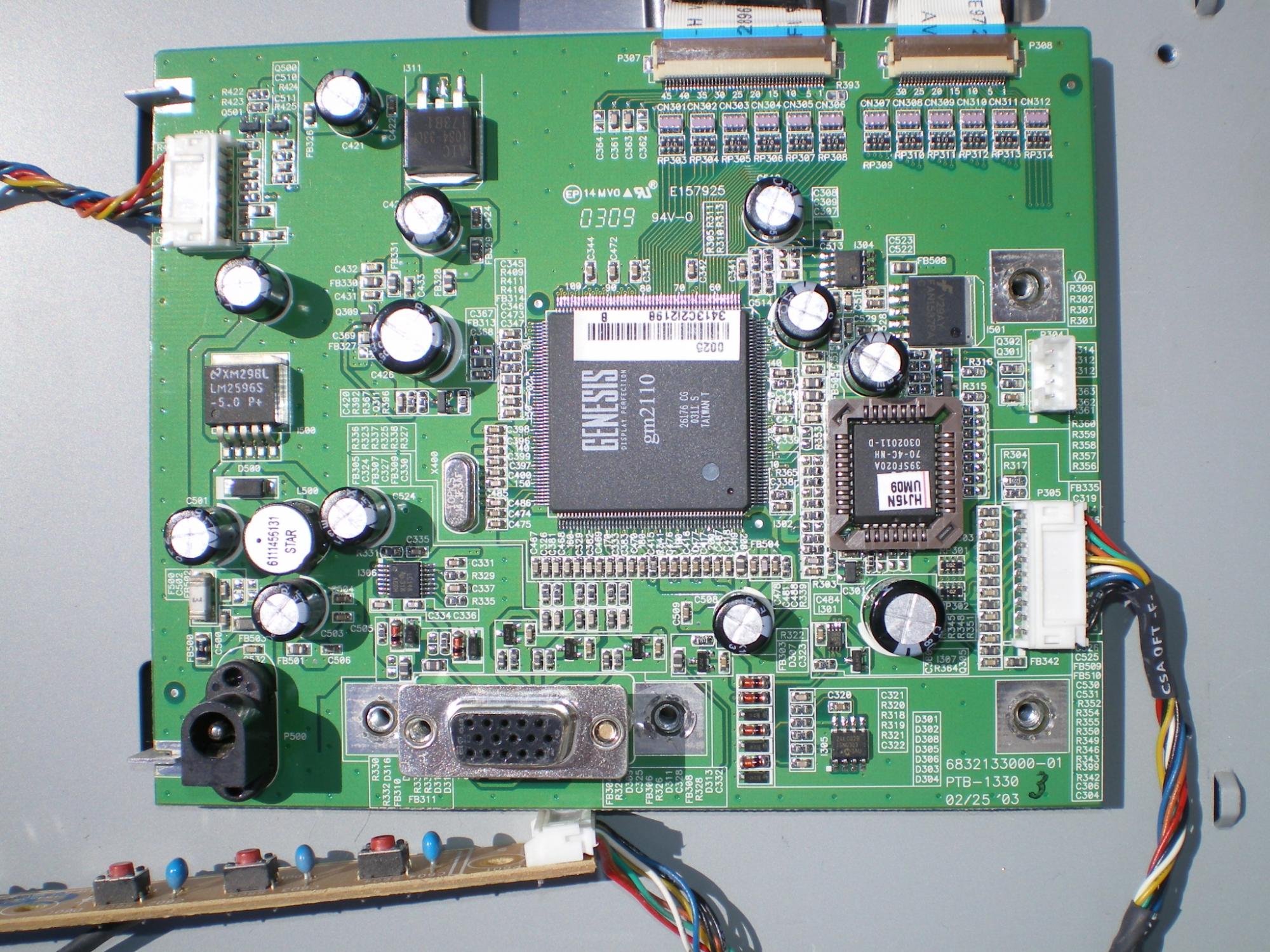

        hp pavillion vf51
        hello,
        total newbie here to this. I have a hp vf51 that wont turn on when you push the power button it doesnt turn on. i put some pics of the back hope i did it all right. any help will do thank you.

            Re: hp pavillion vf51
            First, that is a great clear focused picture.
            Second, it helps to tell us that this monitor uses an external power adapter. I only knew this because I saw P500 and then looked up the manual.
            Okay, now if you have a multimeter, the first thing to check
            1) does your external power adapter provide the correct DC voltage? You should get 12V DC according to the manual.
            2) Check all the fuses on the board with power off and unplugged. They should measure 0.3 ohms. I see (thanks to the great pic) FB500, FB501, FB502, and FB503 right by P500.
                  Assuming 1 and 2 are good, the next step I would take is to measure LM2596 (IC500 - found near upper left hand corner) .
                  The datasheet is at
                  http://pdf1.alldatasheet.com/datashe...2596S-5.0.html
                  On page 2, we see that pin 1-Vin, pin 2-output, pin 3-ground, pin 4-feedback, pin 5-on/off.
                  Since your chip is says -5, I'm going to assume it is going to output 5V. Thus, we should see 12V DC on pin 1 and 5V DC on pin 2.
                  Put your multimeter on 20V DC if it is manul range. Black probe in COM, red probe in Volts. Assemble all the boards, put in all the grounding screws.
                  Plug the ac adapter into the monitor.
                  Put your black probe on pin 3 (ground). Put your red probe on pin 1. Record DC V reading. Now move your red probe over to pin 2. Record DC V reading.
                  Be careful not to have the probes slip and possibly short out something.

                        ok so i did all the fuse checks and they are ok. i switched to the next step to check LM2596 pins when i did ground 3 to red one I got a reading of 2.56.
                        when i went to probe 2 i got zero. once again thank you.
                        • retiredcaps
                          • Apr 2010
                          • 9271
                          Okay, test your ac/dc adapter to see if you get 12V DC. It may not be outputting 12V DC. You don't see it, but there are caps inside that adapter that could be bad.

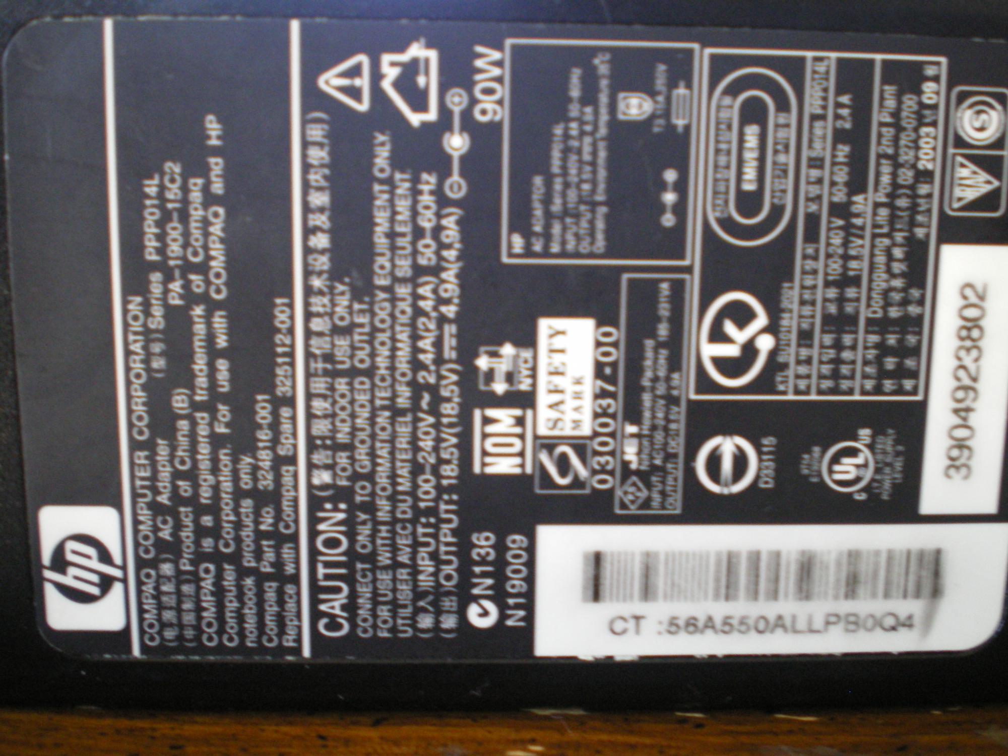

                            i plugged the red tip into the center of the computer adapter and the black on the side and got a reading of 18.6

                              • retiredcaps
                                • Apr 2010
                                • 9271
                                Can you post a picture of the ac adapter so we can see the voltage and amps rating on it?
                                edit: what are the values of C501, C503, C524? It should say something like 1000uF 25V (I'm guessing). This is related to post #5.

                                • retiredcaps
                                  • Apr 2010
                                  • 9271
                                  After re-reading the LM2596 datasheet, on page 1, it shows a typical application. It shows 12V unregulated going to a 680uF cap and then into pin 1 (Vin).
                                  So if the AC adapter is good and the voltage on pin 1 is low, that leaves the 680uF cap as suspect.
                                  Caps don't have to be visibly bloated to be bad. They can have out of tolerance uF and/or high ESR (ohms). Hence the question about the ESR tester in post #5.
                                  If you don't have an ESR tester, the easiest way to test this theory is to replace that cap and retest LM2596 to see if you get 12V DC in.

                                  • hpaca509
                                    • Aug 2010
                                    • 76
                                    so here is a pic of the screens power cord. hope this helps came out a little blurry
                                    • retiredcaps
                                      • Apr 2010
                                      • 9271
                                      Odd. The manual for the VF51 on page 24 clearly says output is 12V DC 3.3A for the adapter. Yet your picture shows 18.5V DC and 4.9A.
                                      Since you measured 18.6V DC, we will assume this is a good adapter.
