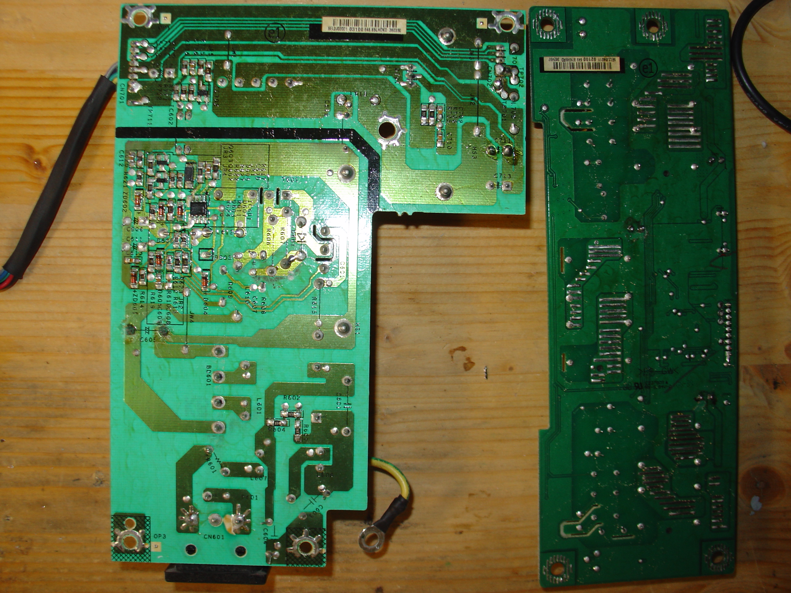

Dell 2007WFP Won't Power On
    Re: Dell 2007WFP Won't Power On
    @MEB, I ran out of idea for you to check (I love that show).
    @craftman, it probably has shorted MOSFET's so it blew the fuse the first time.
    Thanks you are the expert. It also blew the one next to the capacitor in the photo as well. This cap was the one that showed the bulge. The new fuse held this time very strange. Do you think that it is worth repairing? I'm worried about getting a new inverter board to have the same thing happen to it.
    Not sure if I can do that type of solder work but if the parts are cheap and easy to get. Once more unto the breach...

              Thanks for that budm. Lord knows I have no idea, but I can't give up yet. I have some basic questions if you want to take a crack at them.
              Please correct me if I am wrong and point me in some direction. I need to do some crawling before I can walk.
              On my application, is my power board's main function to take 120V AC and supply 19V DC to the other boards (USB/DC, logic and inverter)?
              And is one of the jobs of the USB/DC board to use the 4 "buck regulators" to make 3.3V, 5V, 12V and some other voltage available for use on that and the other boards?
              I feel the power button goes to the logic board to get things started, but can you explain a little what happens?
              Also, I have made a little sketch to try to better understand the "buck regulators". I borrowed your previous drawing as a start and would appreciate corrections and comments. If it is not valid, feel free to tell all not to use it. I am not claiming it to be correct.

                "On my application, is my power board's main function to take 120V AC and supply 19V DC to the other boards (USB/DC, logic and inverter)" Yes, that is the main power supply that supplies the 19v to run the inverter board and for the USB/DC board which steps down to 3.3V, 5V, and 12V.
                The 3.3V is used for running the micro controller on the Logic board which accepts the signal from the power switch which then sends the signal to turn on the 12V and the 5V.
                The Vin should go into the Source pin of the MOSFET, the MOSFET is used as a high speed switch.
                https://cdn.badcaps-static.com/pdfs/...25211cb74c.pdf
                https://cdn.badcaps-static.com/pdfs/...2d4b38ca9c.pdf
                  Thanks. Read all the pdf you suggested and it still hasn't clicked yet. Not sure if I am getting off the subject in this thread, but I've been yelled at before. I have been trying to understand this and the following are my reasonings and not statements. Hope you can fill in the missing pieces.
                  This USB/DC board is supplied 19V DC from my power board upon connection to AC.
                  This supplies directly to the source of 4 Mosfets via connector on the logic board, these 4 Mosfets being the electronic switches for the 4 buck regulator circuits to step down to 3.3V, 5V, 12V and ?V for other uses.
                  So, if the source is the same, the drains are the regulated output and the buck regulator circuits are composed of the same value components, then the gate signal must contain information that dictates the output of the Mosfets. That information to the gate must be in the form of DC which cycles on/off in a pulse?
                  So tracing back from the gates, it seems they are supplied from (2) TL1451A which each feeds a pair of the Mosfets. These 2 chips must evidently supply a pulse of a certain width and duration to switch the Mosfet on and off.
                  But what tells these 2 chips what to do and how do they do it. More basically, how do I get 3.3V versus 5V versus 12V when all of these circuits use the same components? It has to be from information placed on the gates, but I can't grasp how this whole thing fits together yet. Please help me get this straight so I can move on.

                    @MEB, I know you've probably read my reply 2-3 pages before, but I see fit to give you an advice here, even as non expert to non expert.
                    So, I don't know what is the situation with the inverter board you have and why it is blowing its fuse, but if you have worked that out, I can advise you to check the two voltage regulators on the logic board (top right corner). If they are OK and you don't see any shortage to ground (except their own one) then your logic is most likely alive.
                    I've got my hands on 4 dead displays of these at work and 3 of them had no problem with these regulators on the logic and their logics are actually alive. The one with shorted regulators to ground is not OK, and even without them the PCB is shorted to ground there - most likely the main chip is shorted.
                    So if yours are OK and we assume the whole logic is OK, if I were you, I would test if the monitor is able to work with 3.3V and 12V plugged to the logic, where the "USB" board should be. You can check where they need to be from the graph I've posted previously, or measure them from your working monitor. I've use a spare PC PSU to have 3.3V and 12V.
                    As agreed before the 3.3V are used to power up the logic itself. BUT, the 12V are not just for that stupid speakers, anyway. They are used to power up the LCD panel, so you HAVE to have them plugged to the logic board. This is the reason to see only a blank screen with working logic and working backlight. You don't need the 5V, so don't bother.
                    It everything is OK and the test went well for time you see fit, you can use the same trick I did.
                    http://www.ebay.com/itm/140716238408...84.m1439.l2649 (LM2596 DC-DC adjustable power step-down module)
                    Only two of these ten adjustable DC-DC converter boards can replace the 3.3V and 12V supply if you feed them from the 19V of the power board. They are small enough to fit in the place of the "USB" board with the cabling you should do.
                    Of course this whole "fix" can take place only if you see fit to loose the USB hub and the external power for speakers.
                    I know the whole thing doesn't sound quite scientific and more like made in some garage, but this is what helped me fix 3 of 4 of the dead displays, so I'm sharing it with you.
