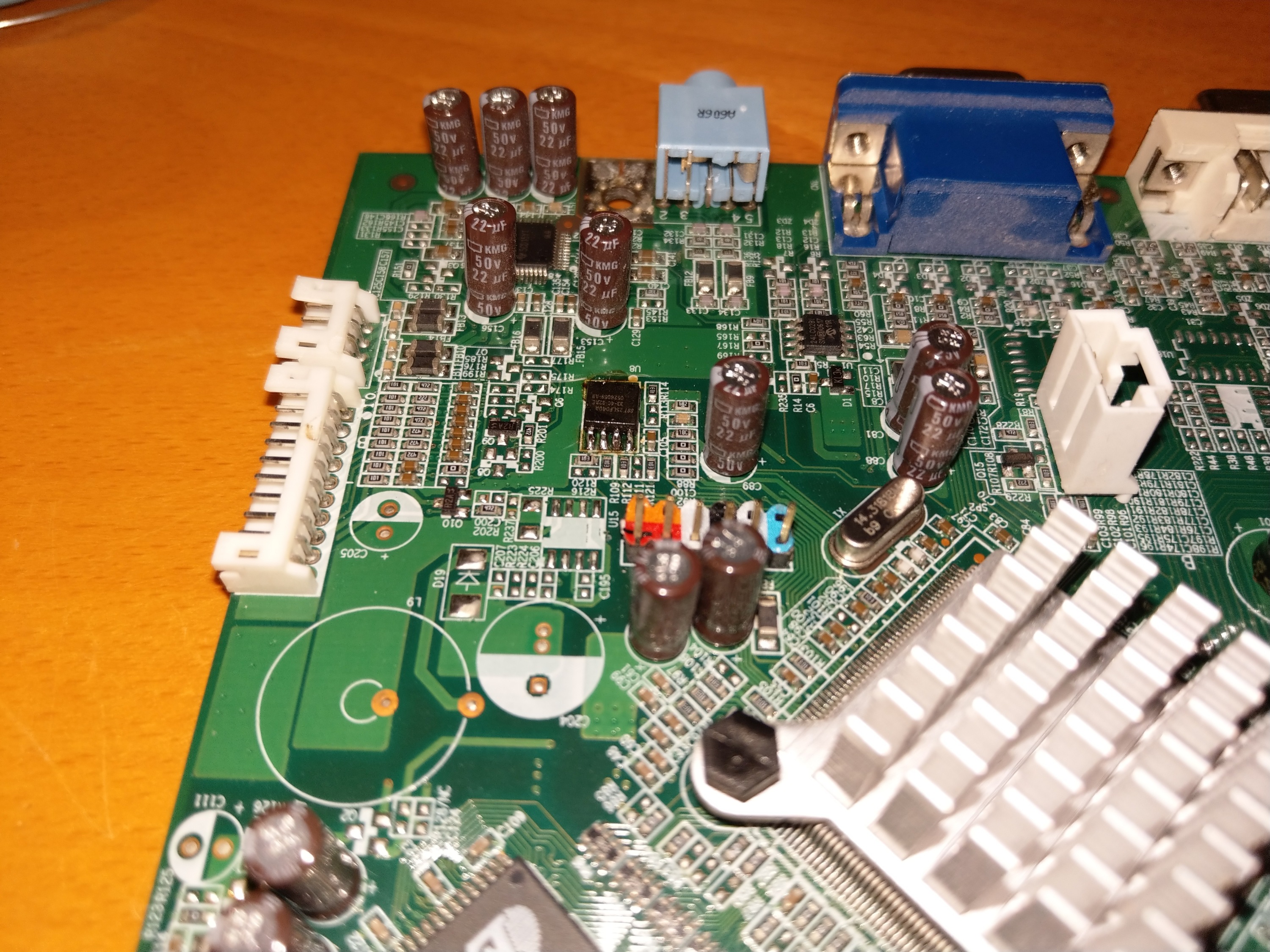

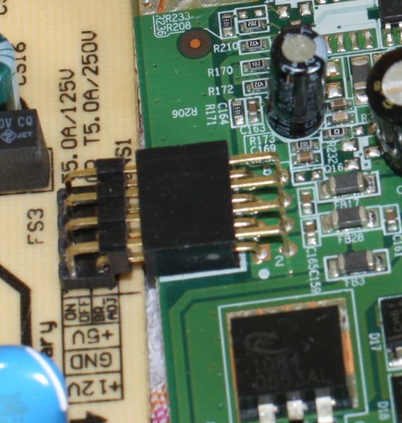

      So for the next thing I went back to the main PCB, there where some low capacitance Teapo SH capacitors that I had not replaced.
      After disassembly I noticed that there where two different values: 47uF 10v which I did not really have a good substitute for with me.
      And 22uF 25v which I decided to replace with 22uF 50v UCC KMG capacitors.
      I tested each one on my ESR tester and measured capacitance with my DMM as I desoldered them and got more and more annoyed because they where all measuring good at around 1.0 to 1.5 in ESR!
      But finally on the 10:th and last capacitor I found a bad one at 7.4 in ESR!
      It sat right next to the input power pins that connect to the power PCB (old picture here with it in the top left on the green PCB).
      Which looking at the markings on the PCB seems to be related to the "ON/OFF" circuit of the monitor, so quite logical after all
      This was around a month ago now and the issue has not come back so it seems it was a good fix
      Last edited by Per Hansson; 10-29-2015, 09:42 AM. Reason: Added crop of old picture showing the culprit capacitor

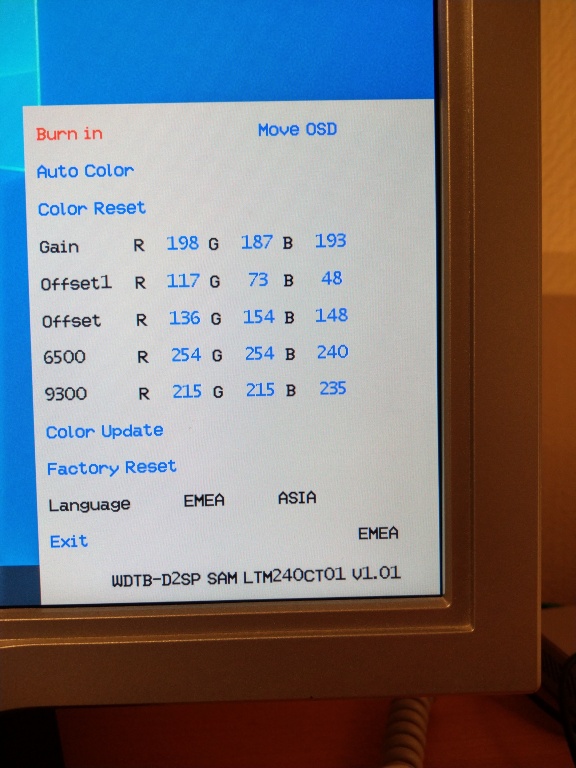

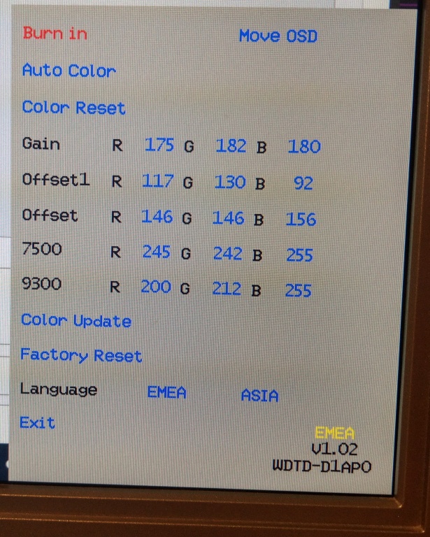

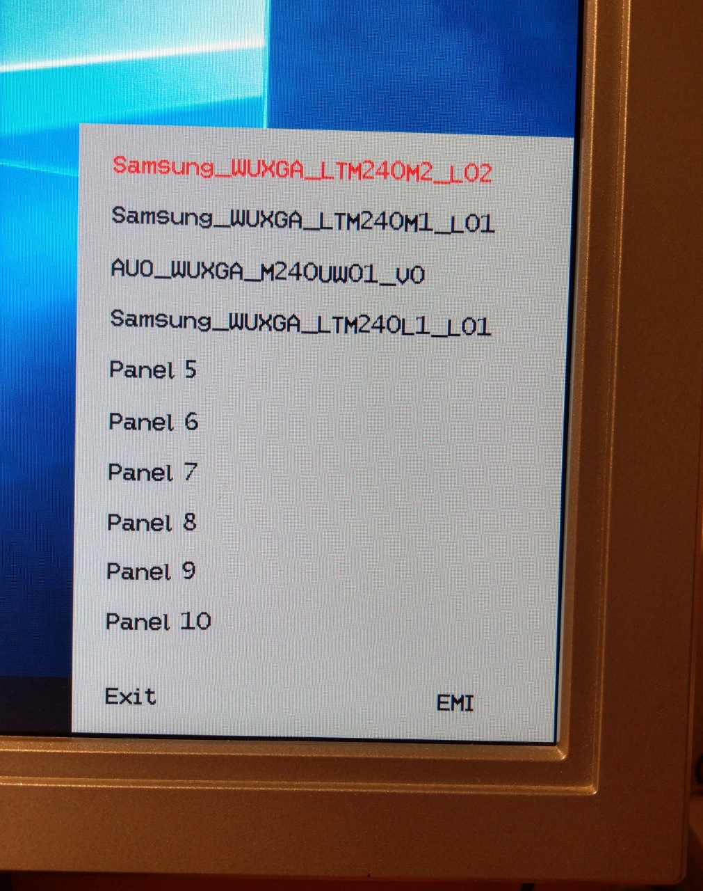

            I have now located another reason for the "no signal" message being shown while the monitor still displays a picture.
            It's a firmware issue! See below quote from Acer service bulletin for the Acer X241.
            (The X241W monitor is basically the same without adjustable stand and speakers).

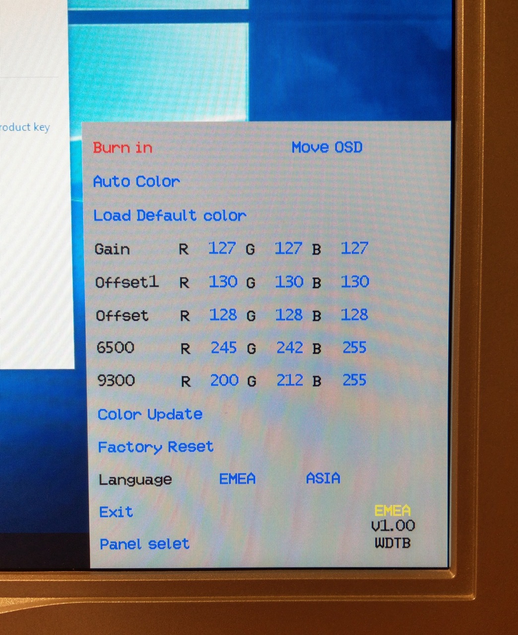

            I posted a screenshot of how the service menu looked in the first firmware I found way back then.
            I did some more searching, and found a user that has uploaded another firmware on a Russian forum since after the first one I found.
            The version string shown in the service menu in this version is still v1.00 but it's obviously different because there is a panel selection menu for example.
            The first firmware I found did not have that, and it also did not support the actual panel that was installed in my monitor:
            A Samsung LTM240M2-L02, which explains the issues I had with color balance after I got it working back then.
            To see the firmware version: turn off the monitor with the soft-off button.
            Then press Auto and the soft-on button simultaneously.
            If successful the power LED should now be amber instead of green.
            Next press "menu" and it should say "Factory mode" if it does you press "menu" again and you are in the service menu.
            Be careful in here: just take a picture of the service menu calibration values.
            Then power off the monitor with the soft-off button.
            Then you can dump the current firmware for safe keeping using an external programmer, the chip is U8 on the PCB.
            Next flash it with the firmware attached to this post.
            I have run mine for 6 months now with this firmware and it seems solid so far
            Clarification: the firmware attached to this post is not the same as the Acer service bulletin below references.

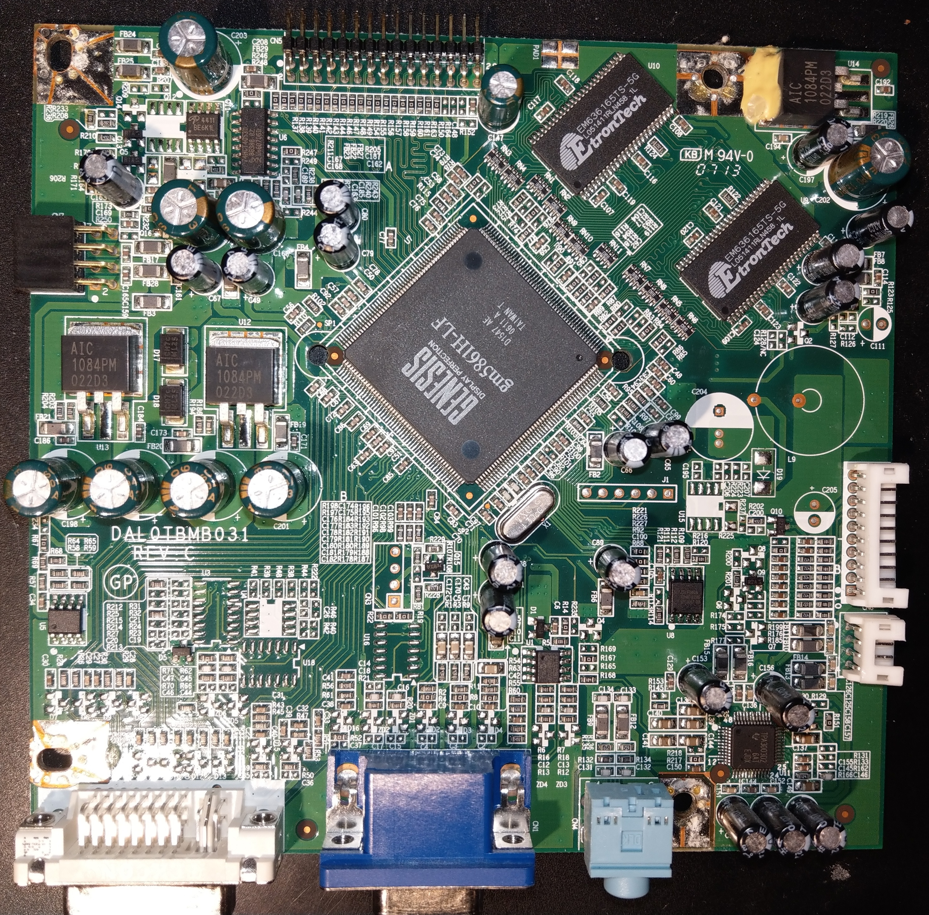

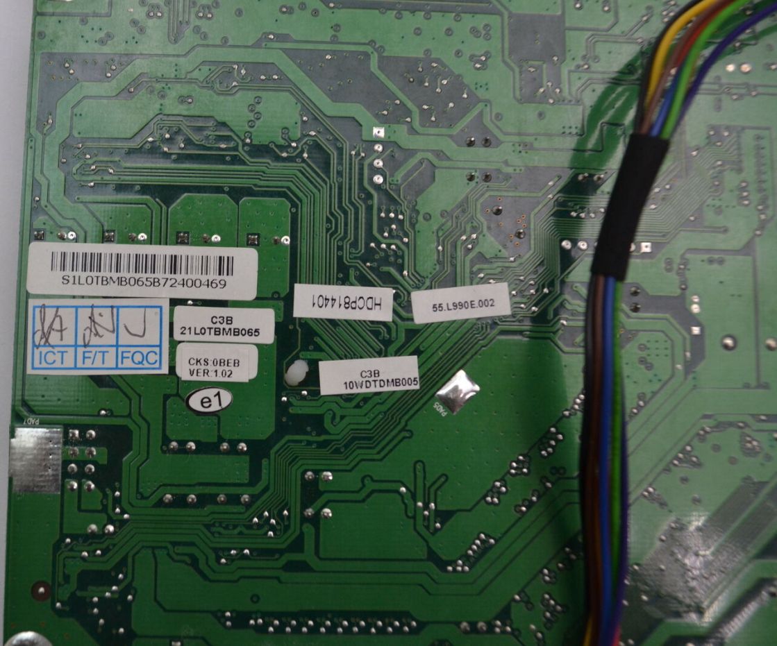

              Got some news
              I bought another mainboard on eBay about a year ago, because it had a newer firmware:
              The firmware version is actually printed on the back of the PCB on a sticker, this new one was CKS: 7F70 VER: 1.01
              It did not fix the "no signal" issue but this one did support HDCP because it uses the Genesis gm5861H-LF processor vs gm5861-LF of the original board...
              But then a few weeks ago I saw that a seller was offering the mainboard for a Acer X241W with firmware v1.02 & checksum: 0BEB
              Based on the Acer service bulletin above it might still not be the right one, but I had to give it a try
              It was installed just yesterday so it will be a long while until I know if it works or not since the issue is so intermittent.
              I have attached both firmwares to this post
              P.S: The X241W lacks the hardware for the speakers, I might just try to flash the board I bought a year ago and see if it works.
              It was anyway time for a recap of it as you can see there is one bulging Teapo, great QC there Teapo: they all invariably fail eventually
