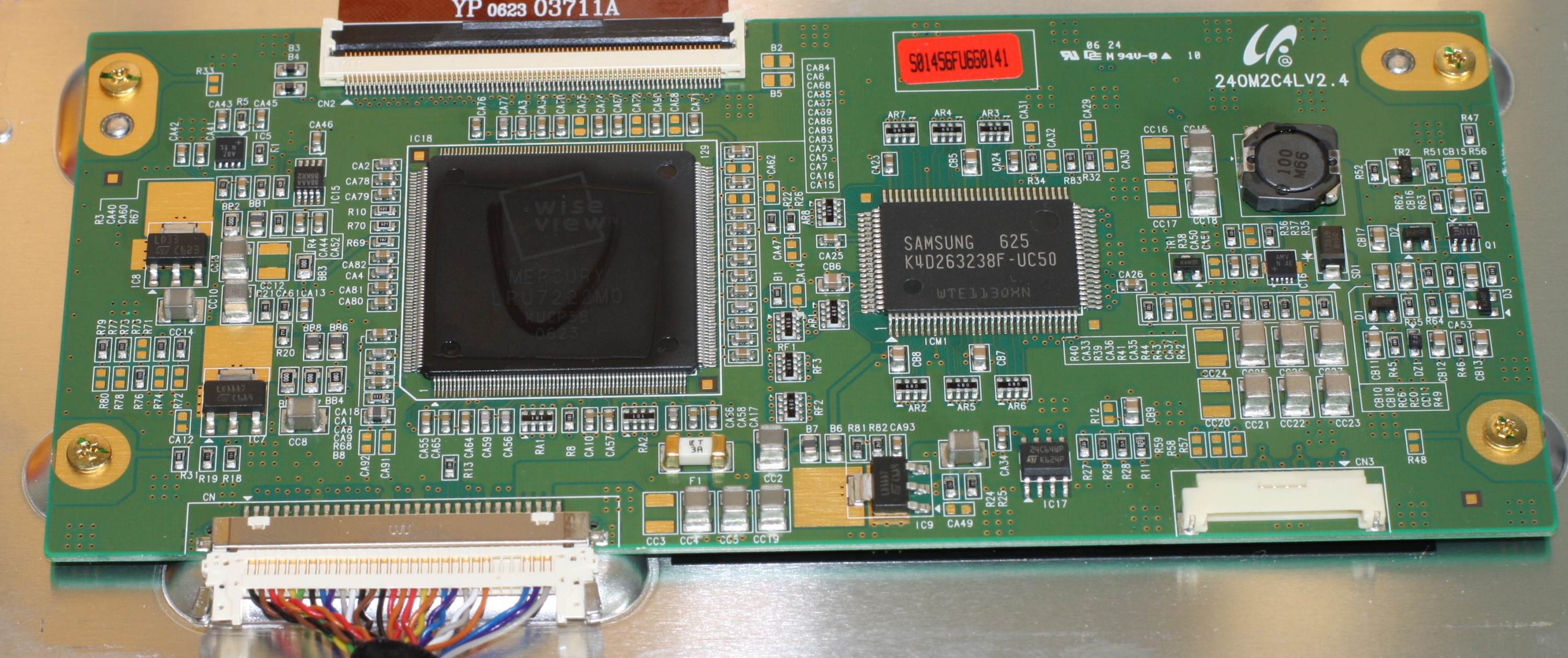

Re: Acer AL2423W Recapped, backlight works but no display
Yes. These regulators are available in fixed and variable output versions.
The pins are numbered 1, 2, 3 across the bottom. 3 is the input, 2 the output, 1 the adjust. By using a pair of resistors from pin 2 to pin 1, and from pin 1 to ground it is possible to set whatever voltage you want. If you notice the voltages, pin 2 is 1.2 volts higher than pin 1.

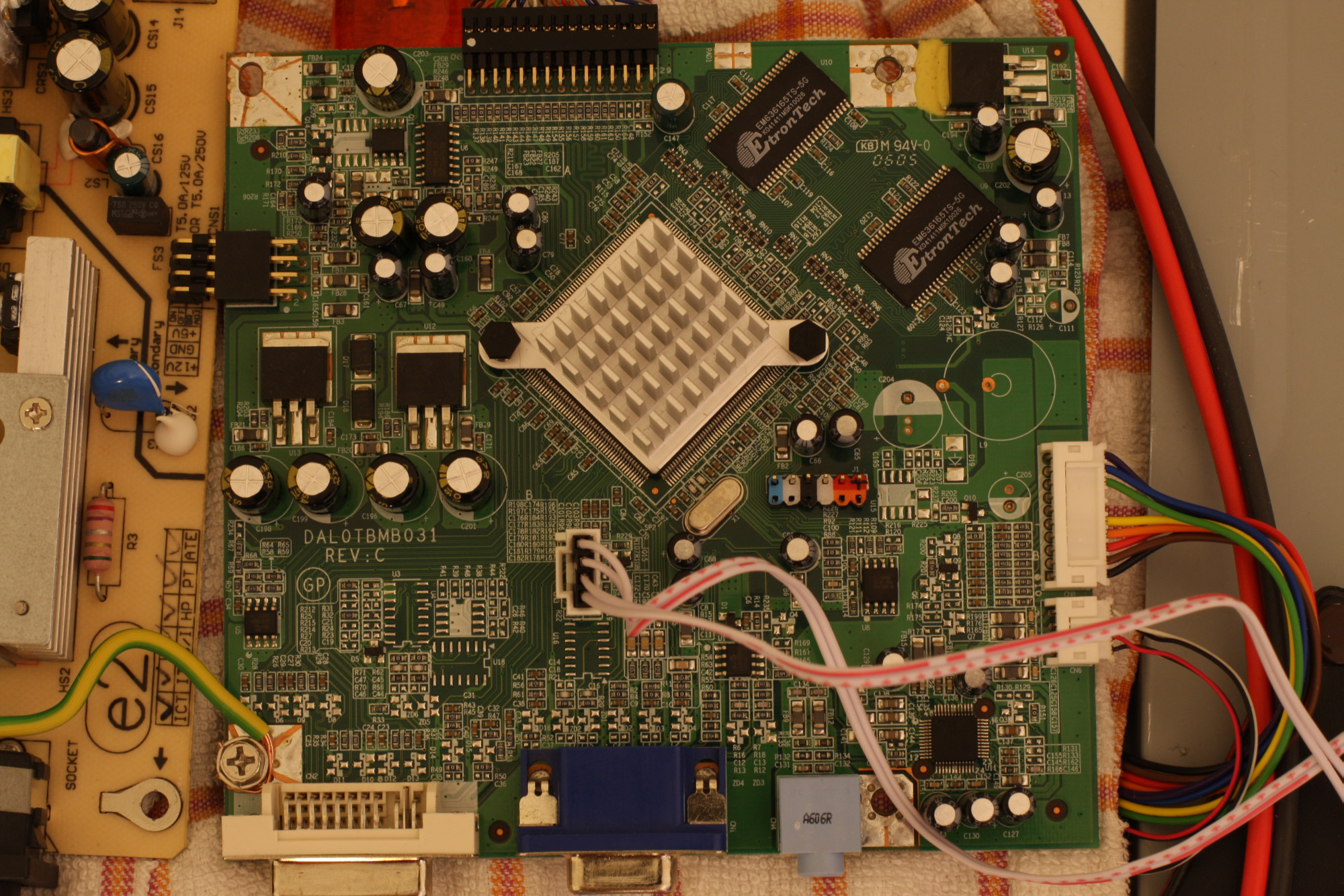

But today, I’m making an exception here. Why? No idea. Perhaps only because the repair details are still “fresh” in my head… which is ironic, given this is a 16 year old monitor that hardly anyone will care about today. It is new to me, though.
