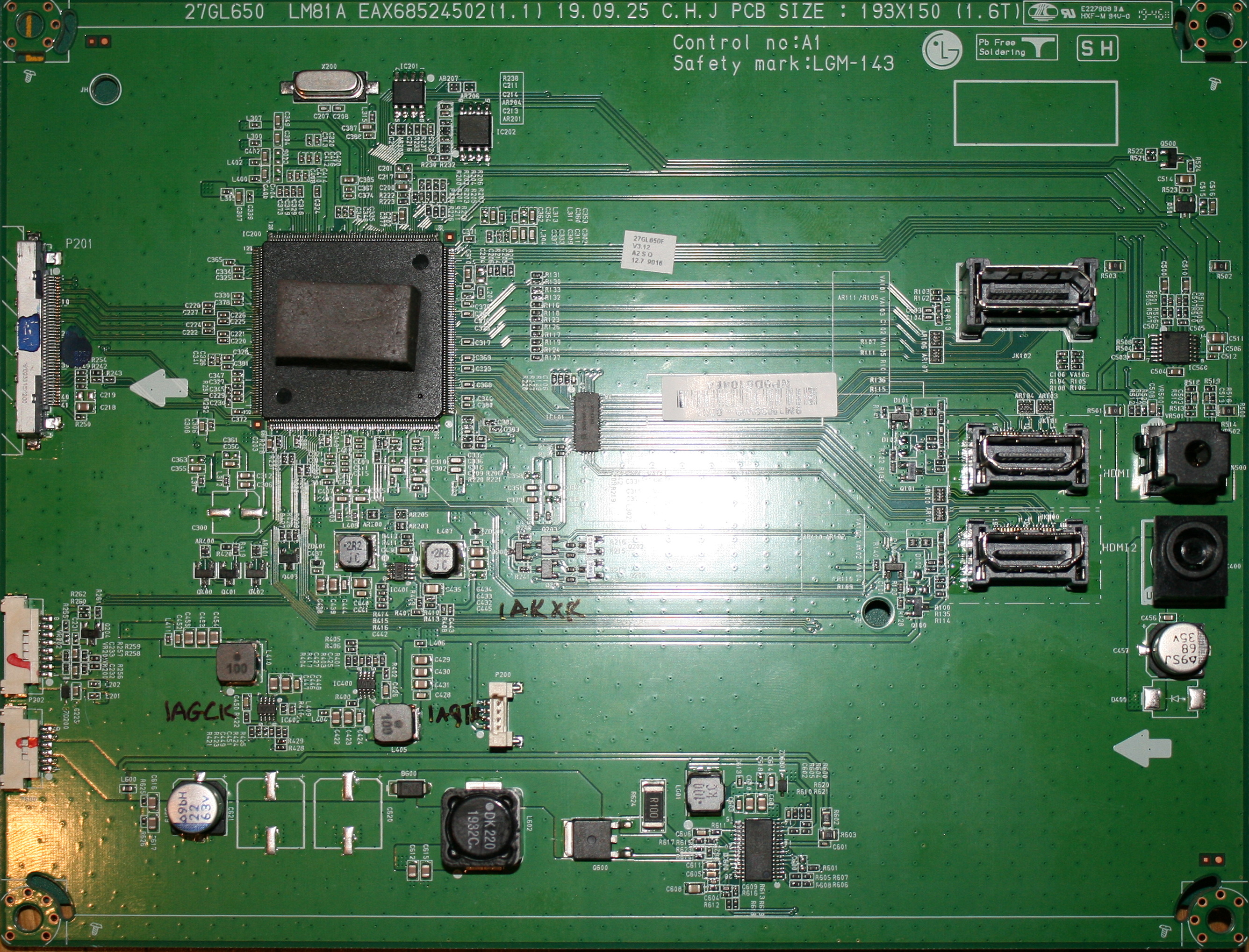

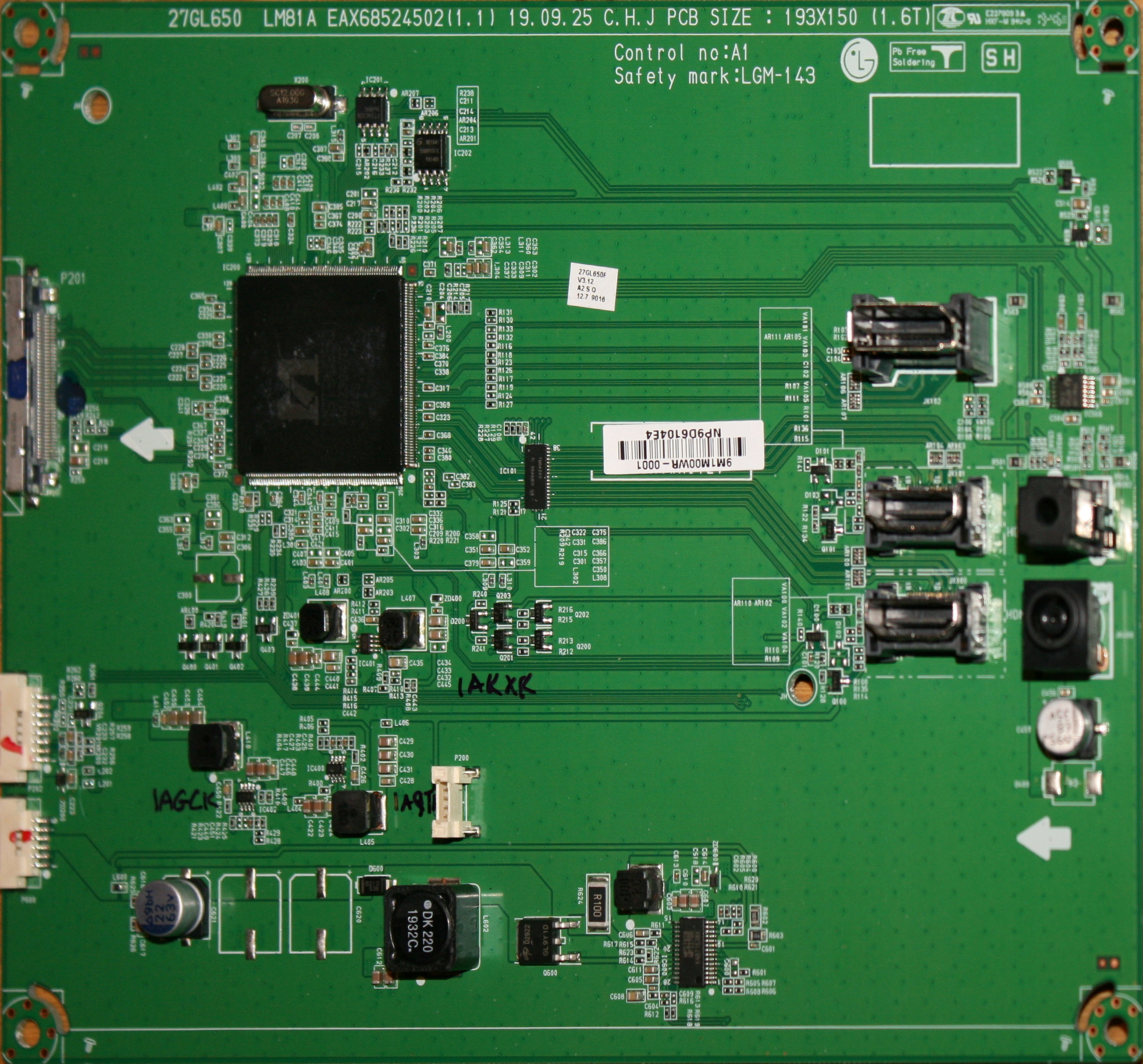

L408 reads ~700kOhms to GND on mine with IC401 removed, so it looks like there's still hope...for mine ![Biggrin](https://cdn.badcaps-static.com/images/smilies/biggrin.png)
I made another discovery after I read about it happening to another chap: I never would've even considered checking that area myself, but SMD cap C508 next to the audio jack is dead-short...I'm not sure if it's supposed to be like that, so if someone else can confirm, that would be great
Cheers.
