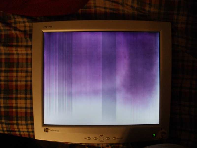

    FPD1730 has failed on me
    Have a Gateway FPD1730 17" here, which worked flawlessly until today. Now all that I get on the screen (whether connected to a PC or not), is a mushed white screen that after a second, begins developing light purple blotches, the screen is also full of thin lines. When connected to a PC, the mush does change up, but is still a load of un-viewable white, lined mush.
    Crap caps, or has the CPU on the logic board bit the dust?

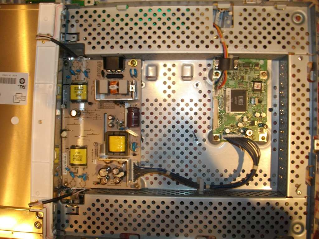

      Re: FPD1730 has failed on me
      Edit timed out here. Images of the problem attached:
          It looks like there 2 bloated caps (that brown crust on top) on the logic card and possibly 3 on the power board.
          It would be helpful to get 2000x2000 clear focused pics if possible. Put the boards by the window on a sunny day and use macro mode.
                I go for either the logic board or a loose cable to the panel itself. The white screen can also be caused by a fuse open on the panel, but that would be just white, not the way you describe it............
